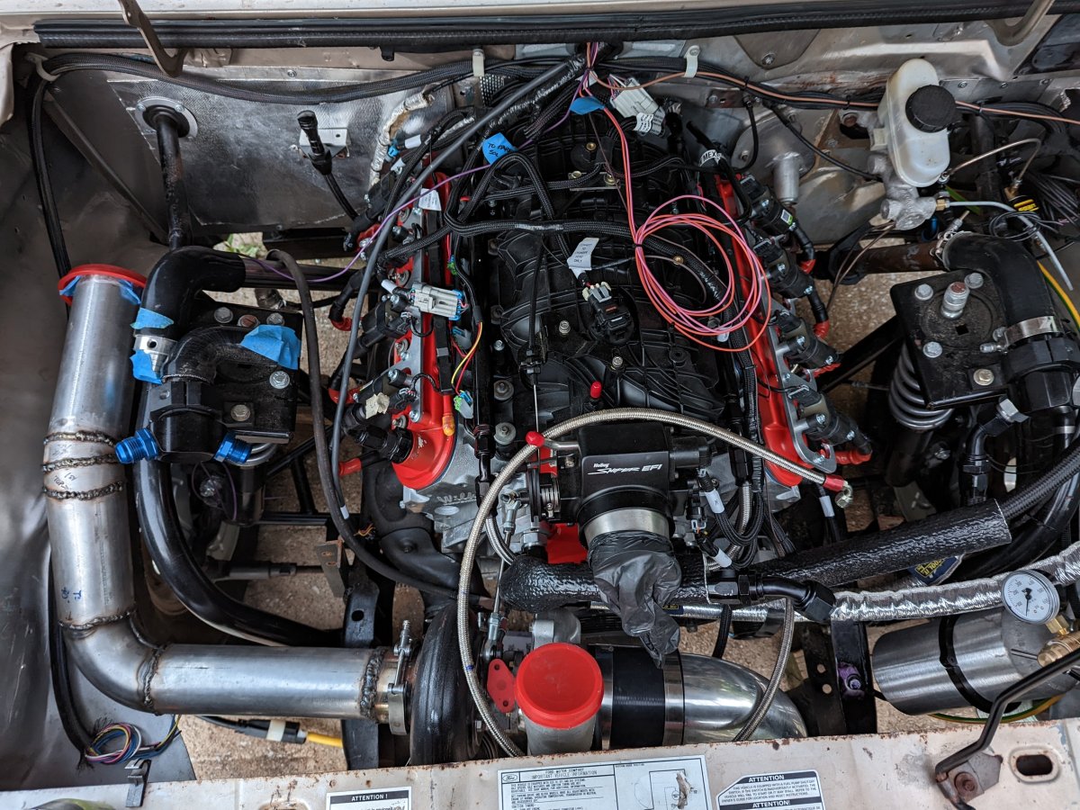

On another note- more progress:
CO2 routed, turbo braced, WG installed. Now for the exhaust.
A welder I am not, but it's going to work fine. It's about halfway completed- I'll turn it down behind the pass wheel, along the floorpan,
then turn it back up into the bottom of the bed with a 6" muffler.
Hopefully I'll be tuning in a couple of weeks.

Maybe, but then I'm not a sloppy mechanic kind of guy. Sure, I could have put a bone-stock 5.3 in it, or a Windsor, but did you see the part about the flimsy frame? 2620 pounds with anything over 400 horsepower (that actually hooks) needs safety equipment. I've built cars that have been sketchy, but I never kept them, nor did I make passes with them- certainly not with my wife in them.

That'll be a stretch for this engine- I kept it stock bottom end so I wouldn't be tempted to go with a nasty solid roller and r.p.m. the heck out of it. While the 4L60e eats less hp than a 80, the 9 inch eats probably 75-80hp.
Boostwise, I'll throw 20 psi max at it and keep it under 6800. The TBSS intake and wimpy cam are probably done there, anyway.
The beauty of CO2 boost control is I'll have a 3psi WG spring in for the "default" setting, and let my CO2 pressure dictate what boost I run.
