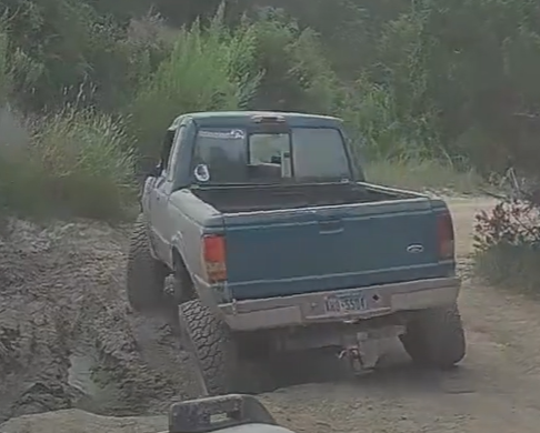

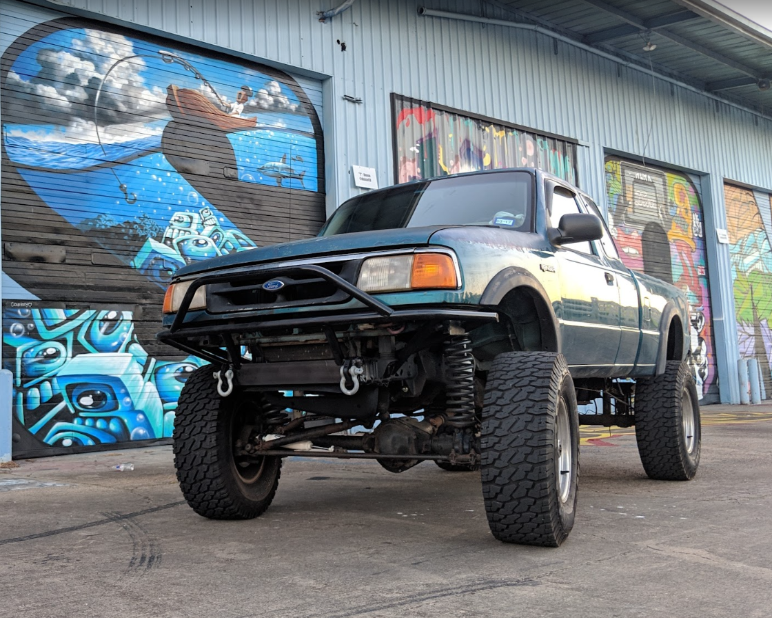

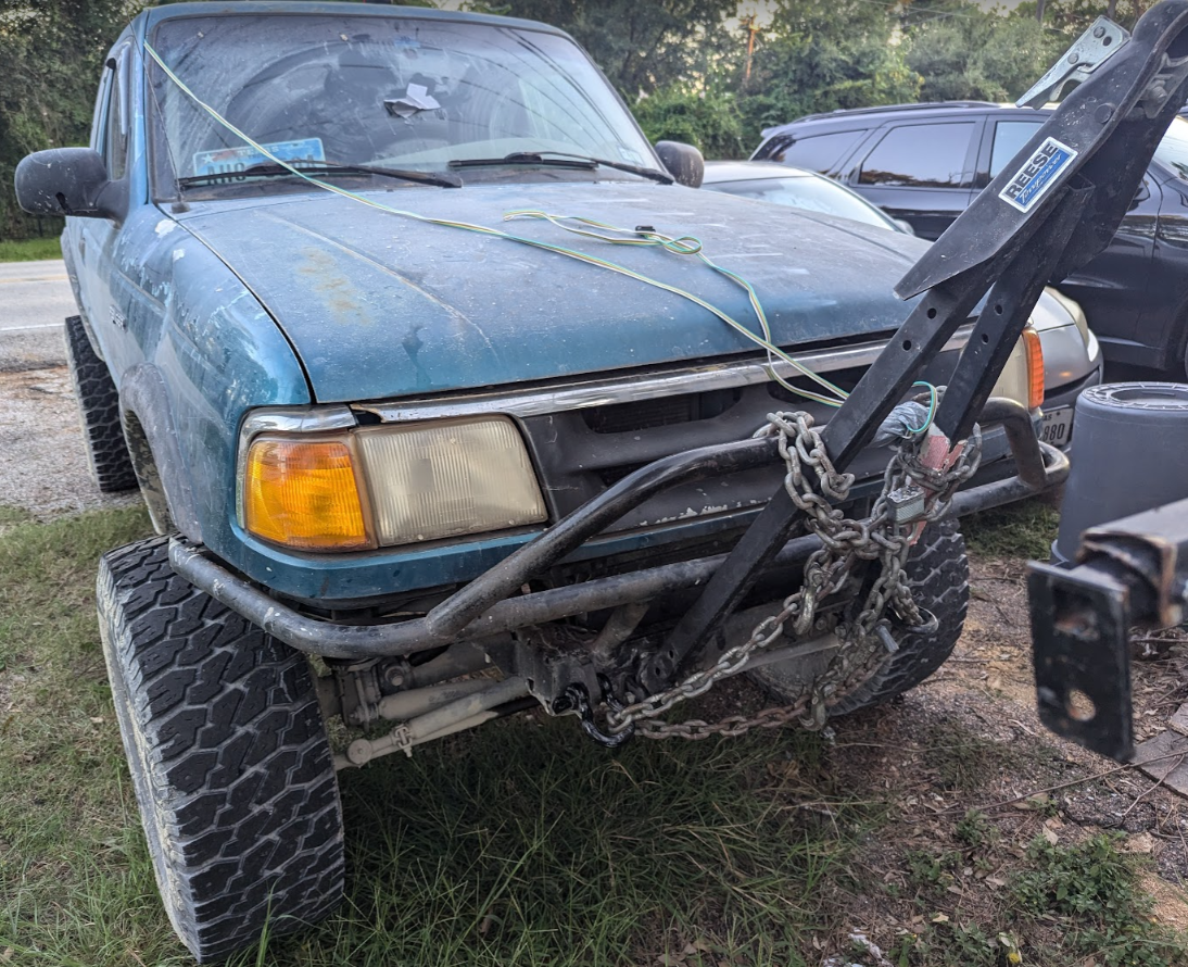

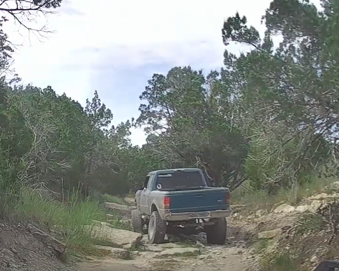

I don't take enough pictures, and the pictures below are from my buddy's dash cam from one of the level 4's from this past weekend. If I get one of the other videos from another trail buddy, I'll take some screenshots. The other other pictures are from ~4-5 years ago, when it was cleaner and less...damaged.
Green Ranger has about 220k miles now, and it was time for a tune up. Drivetrain is still very solid.
