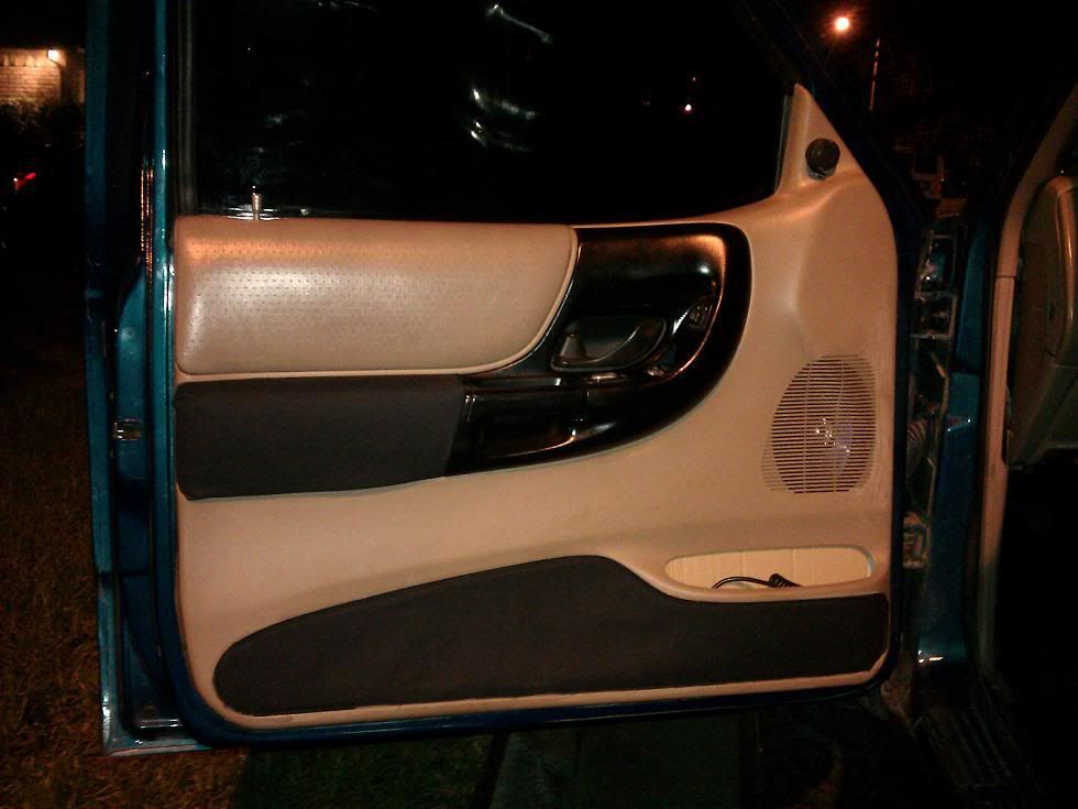

I repainted the handles, and got some black tweed and covered the previous carpet and arm rests. It is slightly more comfy, it doesn't smell from the previous owner, and [/u]this side door lining does NOT have dip spit spilled all over it.[/u]
I think it came out nicely. Not bad for a first time.

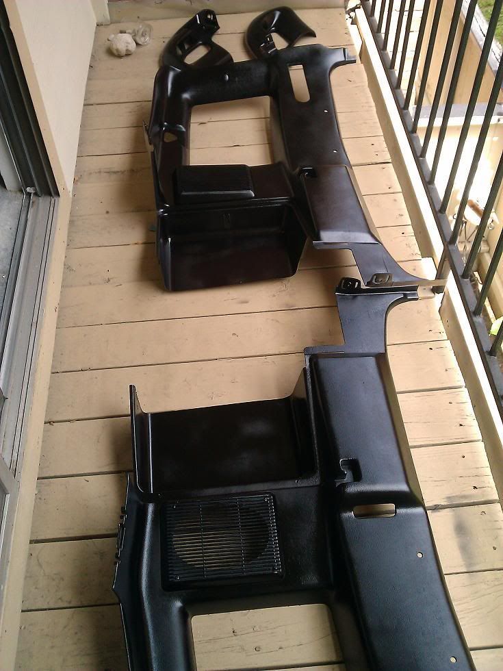

Repainted black splash panel, shampoo'd carpet backpad from cigarette smoke and dip with stains, 12" Rockford Fosgate P1 single voice coil wired to cheapy Walmart 200W amp, repainted panels, & the new black carpet I installed last year. I put additional insulation behind the panel, since I already had it.
(NOTE: (4) Pioneer 6x8" speakers in doors and rear)

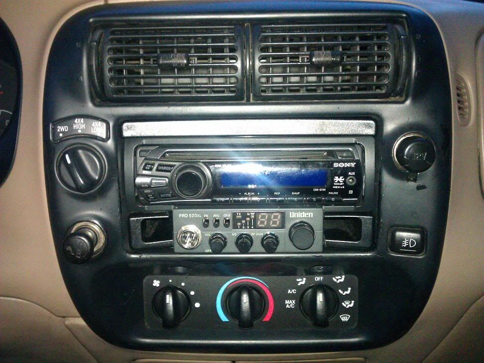

AgPete139's Green Ranger Thread
The rest of my CB install, using my Dremel (audio is wired into the speakers):
ADVICE: If you want to go cheap with a CB Unit, fine. I picked up this unit new for $40 at Fry's and it works great. Get the Uniden 520XL, NOT the 510XL model (cheaper by $5-10) since it does not have the squelch or gain features. This allows for more "tune-ability." I used a Vanco brand antenna from Fry's as well. I'm going to return it as soon as I find a 4' - 5' fiberglass Wilson or Firestik.

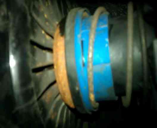

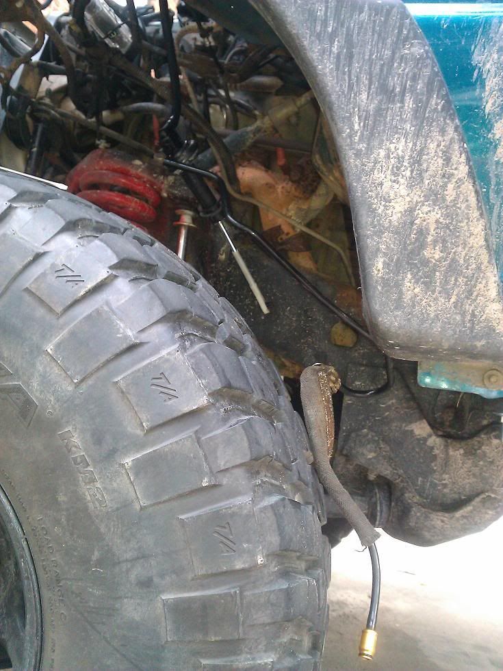

This was already damaged. I don't know the name of this part, but I want to buy a new one. This is what you push into the slave to disconnect it. Use a large flathead screwdriver as leverage to pull the line OUT as you are pressing IN with the 2 small screwdrivers.

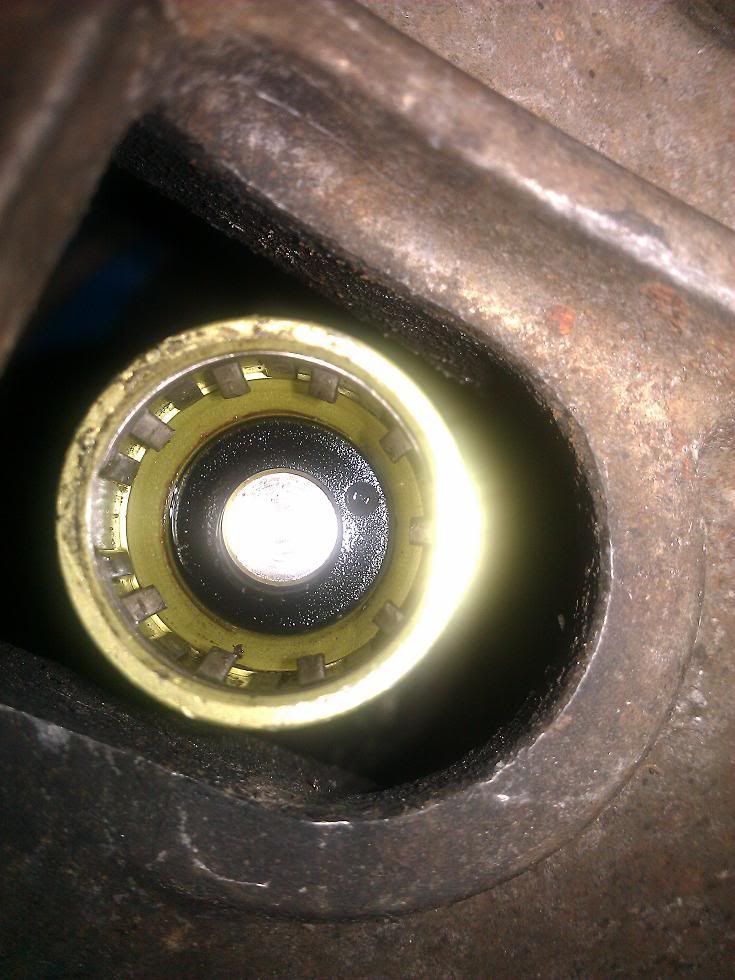

CLOSEUP OF QUICK DISCONNECT:

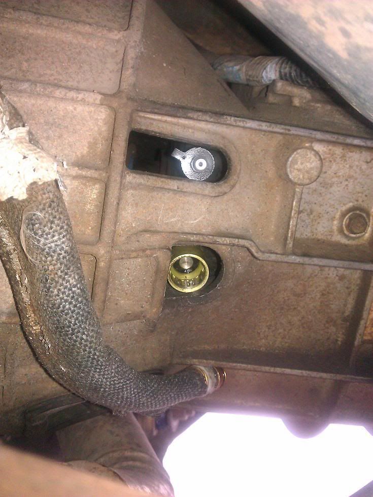

SIDEVIEW OF BLEEDER & QUICK DISCONNECT on the SLAVE:
I removed the M/C, hung it upside down, pulled the lines straight, and tapped the lines.
NOTE: The line is removed from the slave, and the clutch master cylinder is hanging upside down (with the white piston). This allows all air to escape.
So much air bubbled, it was unreal.

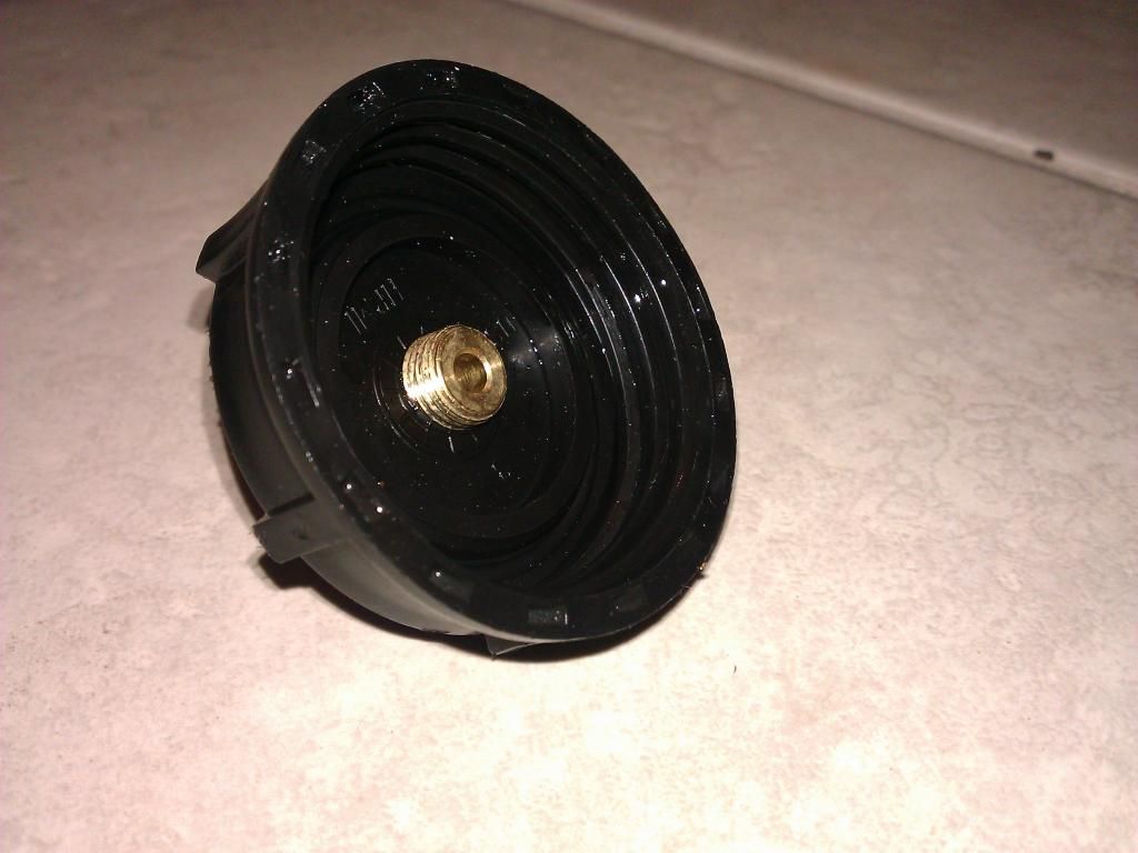

In a nutshell, I was simply displeased with my clutch pedal feel, and I had an extra clutch reservoir cap, so I took a 1/4" barb fitting and threaded it into the top. I ran a hose from the cap to my engine manifold vacuum (with the reservoir cap installed to not suck DOT3 into my engine), and turned my engine on.

I read about this on TRS, and about other peoples' experiences with this method/similar situation.
The suction (what? ~ 15-20 lb of pressure?) sucked so well that it pulled air bubbles past the o-ring fitting at my slave cylinder. My slave cylinder was on it's way out anyways, so I bought a new unit. This is from O'Reilly's and currently sitting on my bed topper. Still haven't painted it. :annoyed:

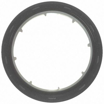

While everything was apart, it was noticed that the flywheel was warped & the rear main seal was leaking. These were replaced. The HD clutch still looked great.

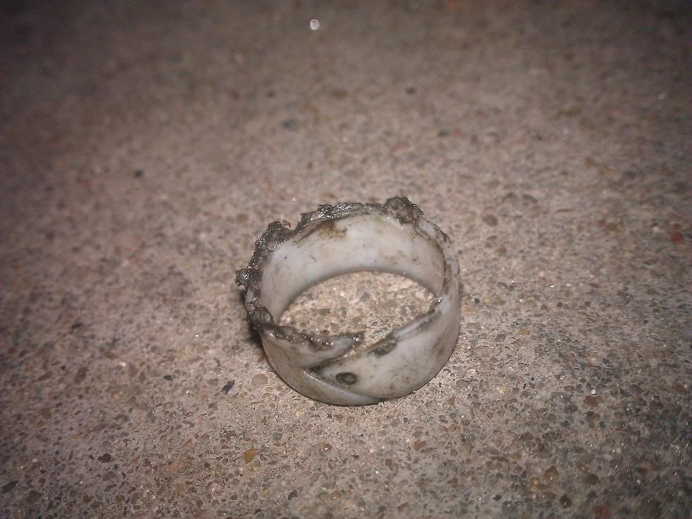

I worked on my finicky hubs again sometime since this summer as well. They want to stick sometimes. I don't know why this happens.
