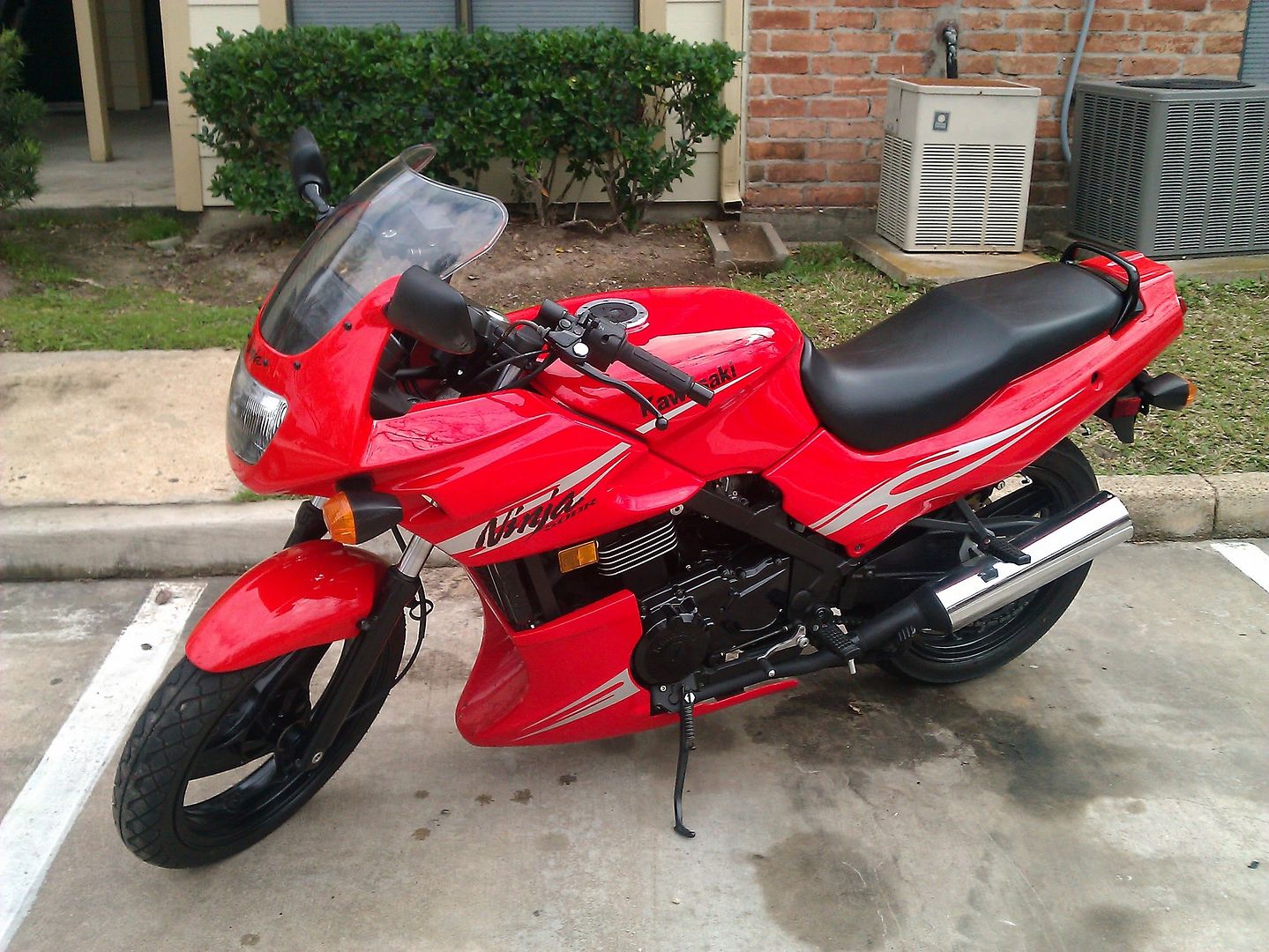

Picked up a new toy this past weekend:
2008 Kawasaki EX500 Ninja, 1273 miles

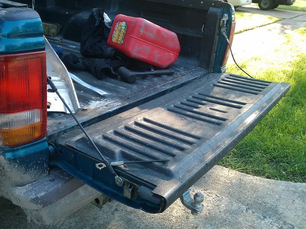

Tailgate replacement & sag: (HUGE tailgate damage not shown....its well hidden underneath the tailgate cover) It's almost not functional sometimes.
I replaced the tailgate cable from a unit from O'Reilly's for $8. After installing, I find out that the other side has been stretched so far it doesn't bear the weight of the tailgate now! My entire tailgate is tweaked anyways, and only one side of it locks in place anyways. I may just go buy another gate for $20. It just wont be color matched. The previous owner had the tailgate down and backed into something...so that makes it dented badly even more. I've tried to hammer it out to the best of my abilities, but I think it's a loss.

Switched out that other tailgate cable today. My tailgate is so tweaked, I'm temped to just buy a straight one off Craigslist for $20. :annoyed:

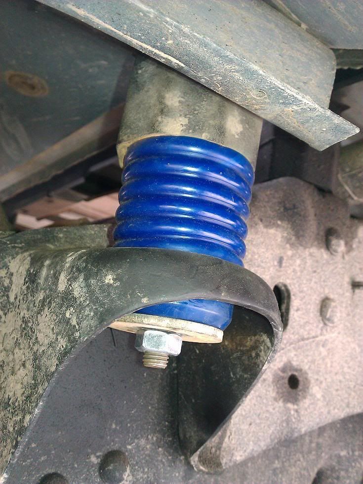

I did this bushing replacement about a week ago, and I have these next 2 posts referenced in another thread regarding bushing replacement.
There are a total of 6 cab bolts (2 rear, 2 middle, and 2 front).
PREPARATION:
I threaded the removed bolts from underneath, and filled the bushings with PB penetrating oil before hand. I don't think it changed a whole lot, for the sleeves.) The sleeves become mushroomed out over time and wear, and unintended stress from the cab when weight gets transferred to the sleeve. They are also rusted together, making this a PITA.
BACK 2 BUSHINGS:
The back 2 are sleeved, but usually carry less weight, and were easily punched out for me. (Remove the cab bolt from inside the cab, thread it those 8 or so threads to fill up the nut from the bottom, and get a long extension and hammer away from the inside of the cab. I got it out with about a dozen solid hits with a 3 lb sledge hammer.)
MIDDLE 2 BUSHINGS:
For the middle, due to the dash and other constraints, I couldn't hammer them out. These are fvck!ng impossible. You have to heat up the bottom sleeve enough to expand then hammer from the top again, or cut them out. NOTE: I would NOT suggest burning out the bushings. I've removed suspension bushings like this before, and it's a great method! However, these bushings have metal sleeves in them, and this method won't do anything for you. Besides, you risk catching your truckcab on fire since it's in such close proximity.
Using a metal cutoff wheel, use the frame as a "guide" to cut horizontally. Make the cut below the top bushing. This way, there is minimal rubber burning, less mess, less smell, less rubber buildup on your grinder shield and on your frame. I actually got burned with some melted rubber on the first side I did. This took me only a mere 3-4 minutes to cut off. It got straight to the sleeve.
FRONT 2 BUSHINGS:
These are simply plug & play, drop-in bushings. Just make sure you lift the cab high enough to remove them.
OLD Ford Rubber (LEFT TO RIGHT):
Back cab sleeved bushing, Middle cab sleeved bushing, & Front engine "open" bushing:
NEW James Duff Urethane (LEFT TO RIGHT):
Back cab sleeved bushing (notice how it is "mushroomed"), Middle cab sleeved bushing (notice the sleeves where I cut the bushing in half), & Front engine "open" bushing:
I hope this helps, for anyone that wants to do this again. Make sure you have plenty of punch combinations to see what works for you, a grinder with a cutoff wheel, penetrating oil, sledge hammer, and multiple washers.
BOLT & NUT SIZE: (Metric) M12 - 1.75
WASHERS: Whatever works! I used a combination of Home Depot 3/4" washers, 1/2 washers, and a couple old stock washers.
Pete
OLD MOUNTS:
Rear cab (cracks show how many millions of cycles it has been through, still holds its shape, that's it.)
Front engine (totally abused & gone, causes rocking and lots of sway in the cab while cornering, can't even hold its shape)

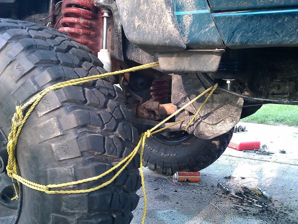

LIFTING METHODS:
Passenger Side:
lol = I couldn't find any long 2"x4" pieces, so I looked around and improvised.
Driver Side:
I thought of another solution once I got to the other side and didn't have enough space with a bush in the way.

I didn't feel like hassling with unlatching my e-brake @ the rear leaves/hanger, so I pulled and strung it out of the way to use my 7" angle grinder.
Also, the James Duff pieces were a tight fit, and I couldn't get them to fit in the front holes of my front frame. So with a little bit of mild grinding, I got them to fit. If you have a rasp or a file, this would be sufficient.
NEW, INSTALLED JAMES DUFF BUSHINGS:
$75, + $25 shipped from their website/Tennessee warehouse
Back cab mount // Middle cab mount // Front engine mount
Hope this helps, guys! Thanks for prompting me to upload the rest of the pics.
Perhaps I should bother Jim & submit it to the Tech Library. lol
Pete
I have since had to go back and retighten the 2 rear cab mounts, as they have come out and "settled" into place.
