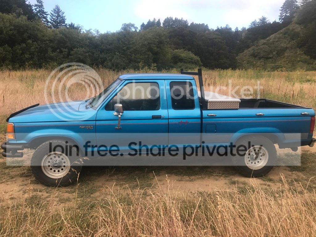

Before...
Advice installing 4 in. Skyjacker class 2

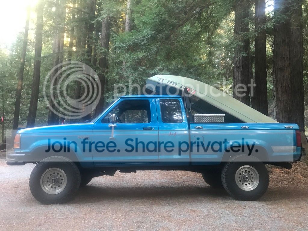

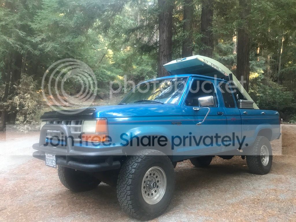

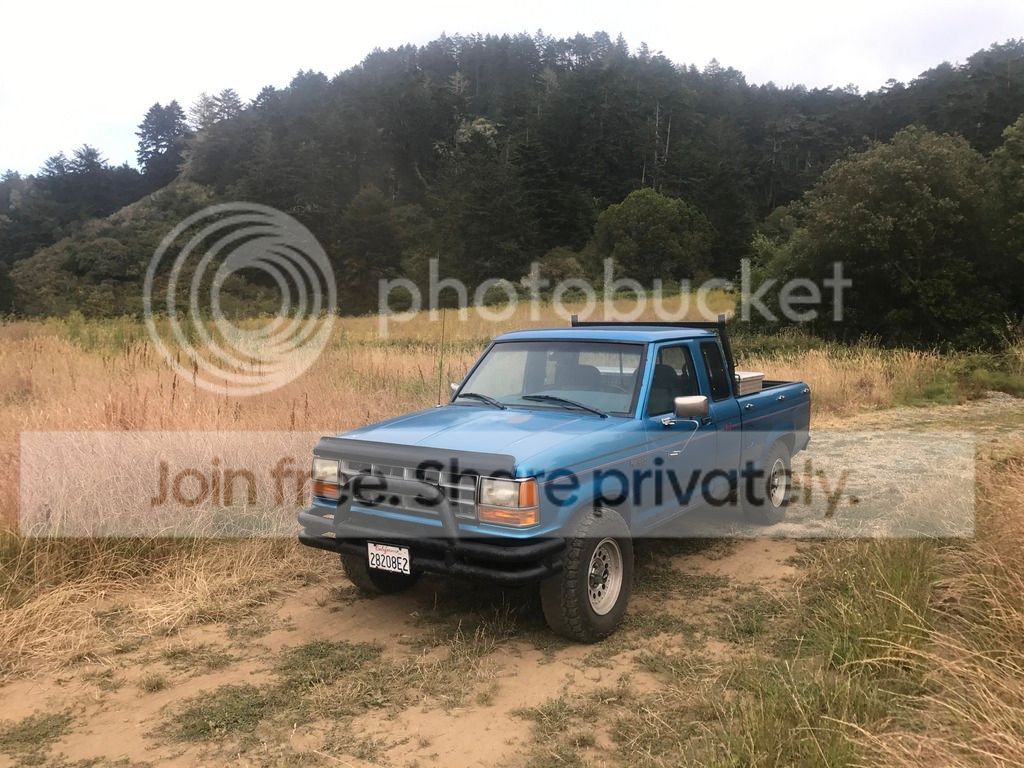

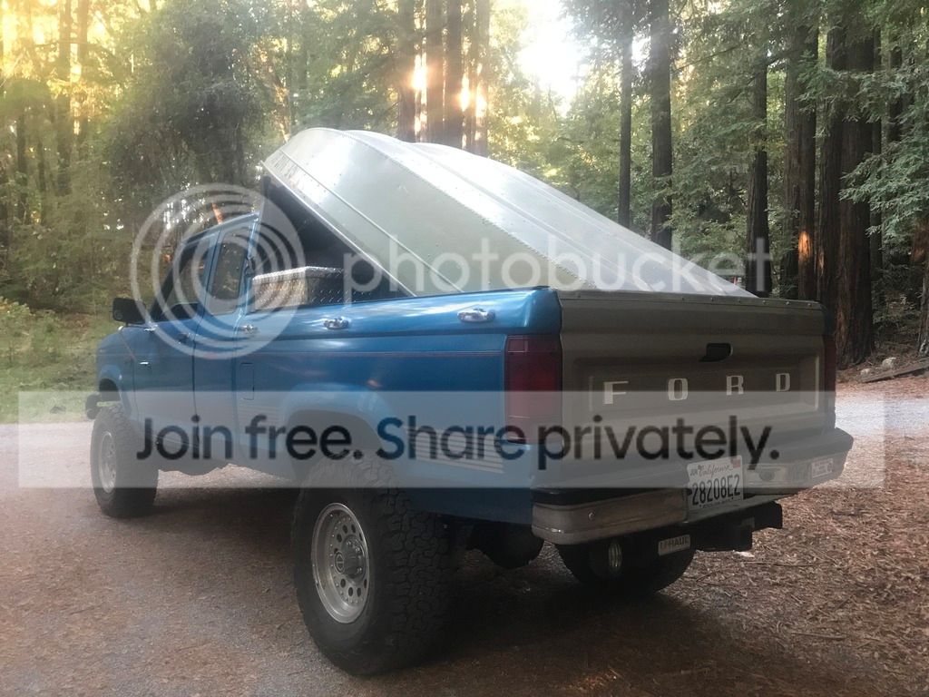

After 4 in lift, 7/8 inches of grade 8 washers from hardware store under the front coils (I have a 4L very glad I put those in) and 31s. Oh and a 1 piece driveshaft swap from a 98 mazda B series lol
Its a little harder to load my boat by myself now, but thats the only con :icon_thumby:
Advice installing 4 in. Skyjacker class 2Advice installing 4 in. Skyjacker class 2
I meant to post pics like 2 months ago, but I've been busy and posting pics on here is kinda of a pain.
The job was pretty straight forward, but I can't believe how tight bolts were even after PB blaster weeks in advance. I had to saw out the bolts in my leaf hangers lol Now I just need to trim more of the gas tank skid plate for my new 1 piece driveshaft. It still rubs sometimes. I hope this helps someone imagine what their truck would look like. Let me know if y'all have any questions.
