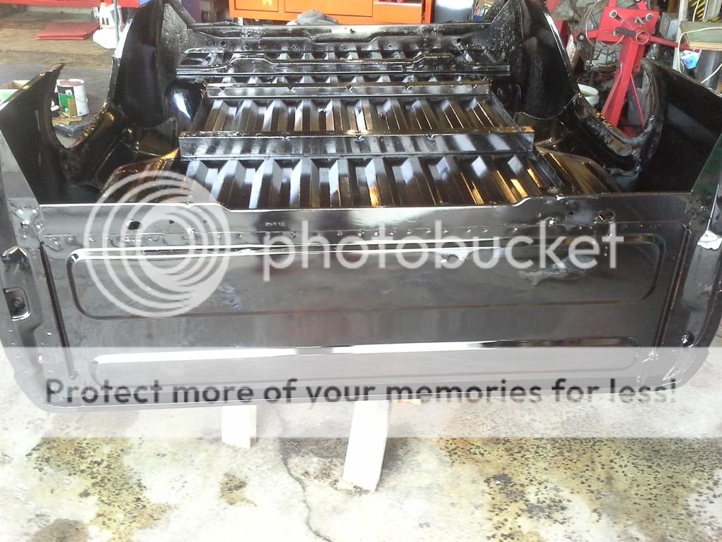

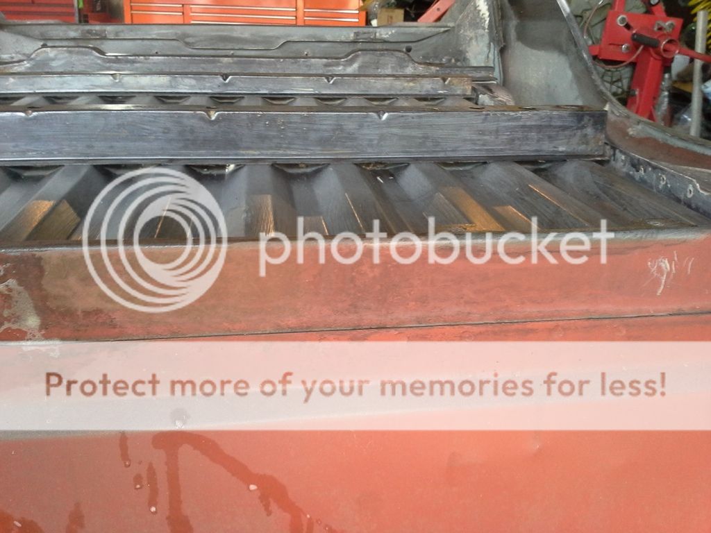

There's the bed:
The underside isn't too bad, but it could be better
That heat shield has got to go. Well, technically it's already gone, it's in the driveway now.
Spent two hours scraping, sanding, and applying rust converter about a week ago. Took this today though.

First coat on the underside of the bed
First coat on the head
Second coat from far away
Head gate after the second coat
The underside of the bed is nice and smooth. The head gate is orange-peeled pretty bad and has a few minor runs in it, but all things considered I think it has turned out pretty good. Today was my first run painting with a new setup that I have never used before, and this paint isn't really meant to be sprayed.
I'm using Valspar Tractor and Implement paint, which is a very thick oil-based paint, in a gloss black. I mixed it up using a formula I found here: http://www.instructables.com/id/Pai...ng-off-the-truck-and-painting-the-door-jambs/
I spent about $200 on paint, thinner, and hardener. 2 gallons of paint and thinner each, and 4 bottles of hardener. I need more hardener, I have mixed about 32 ounces of paint and used almost a whole bottle of hardener.
I am going to turn the bed over and do the inside of the box in a few days. I am going to try to refine my paint mix and gun settings as I go over the inside of the box and try to eliminate the orange peel, but honestly I what I have now I can probably sand it smooth without any real effort, then buff it up to a nice shine.
