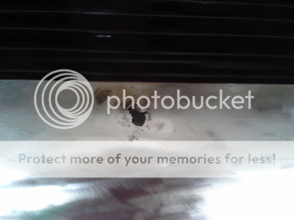

Well I was hoping to shoot color on the bed sides this weekend, but that isn't happening now. Yesterday I was spot cleaning and treating for rust on the bed sides, since they weren't perfect, and as I was peeling back the paint around the rust spots so I could be sure I got the whole thing I kept finding more rust that hadn't broken through. It almost looks the like the surface was contaminated when it was painted originally.
I was really hoping to not have to take the bed to bare metal since I don't have a real paint booth, and I didn't want to mess with primer, but I think it has to happen if I want a good lasting paint job.
Yesterday was no fun.
It did end with shiny though. I was able to get all but a few spots of rust blasted down the clean metal.
I know it looks like I missed a big spot on the bottom, but it's just the reflection of my creeper mat.
This is a hole. I primed over the area. It will have to be cut out and repaired, and the primer touched up then, but I didn't have a lot of time to work and wanted to get the bare metal covered.
Last rust spot.
All this rust got treated with Naval Jelly, which should lock things down nicely in addition to the primer. I am using the Valspar tractor and implement oil primer, which should keep things locked down, assuming the label is to be believed. Then I washed the bed side one last time, dried with air, and wiped down with thinner. Dried and and:
