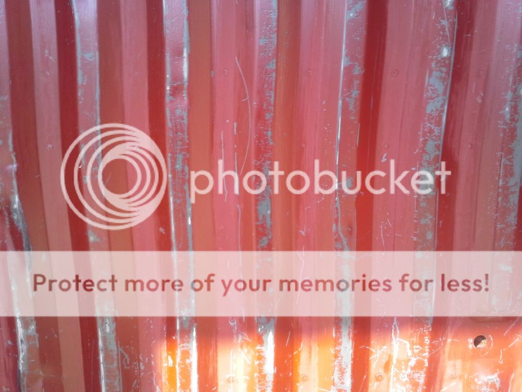

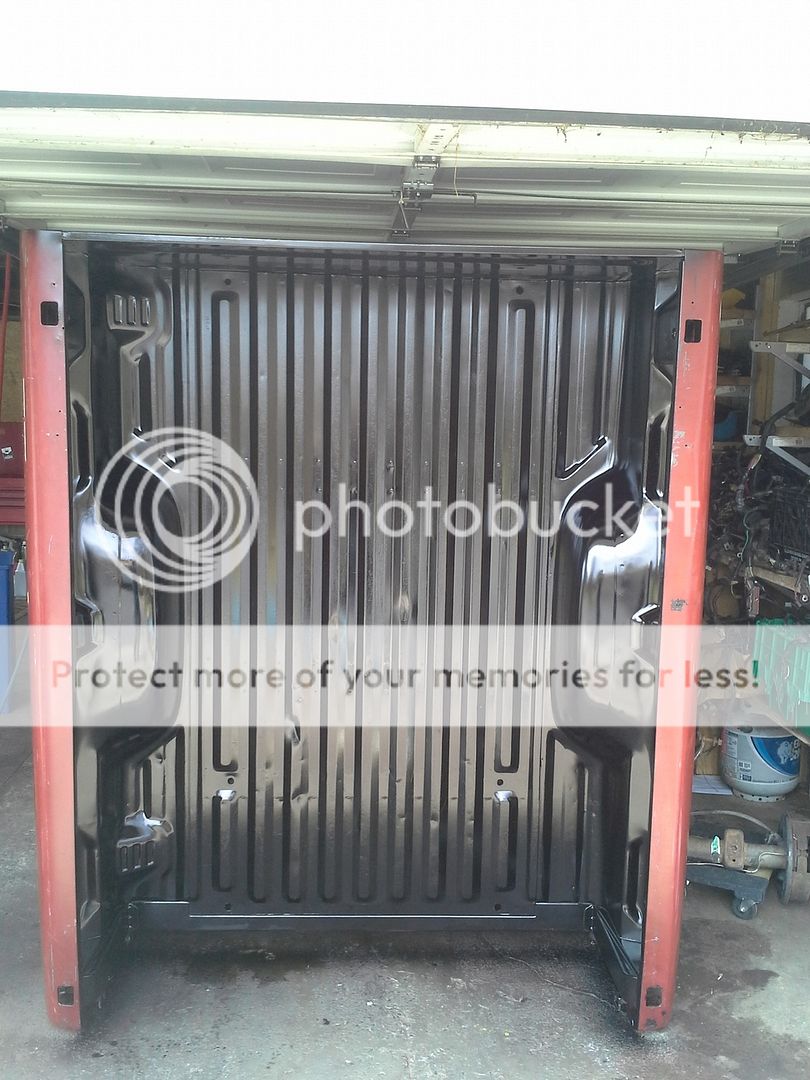

Sanded:
adsm08's Ranger build up
Test spray:

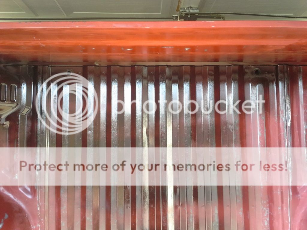

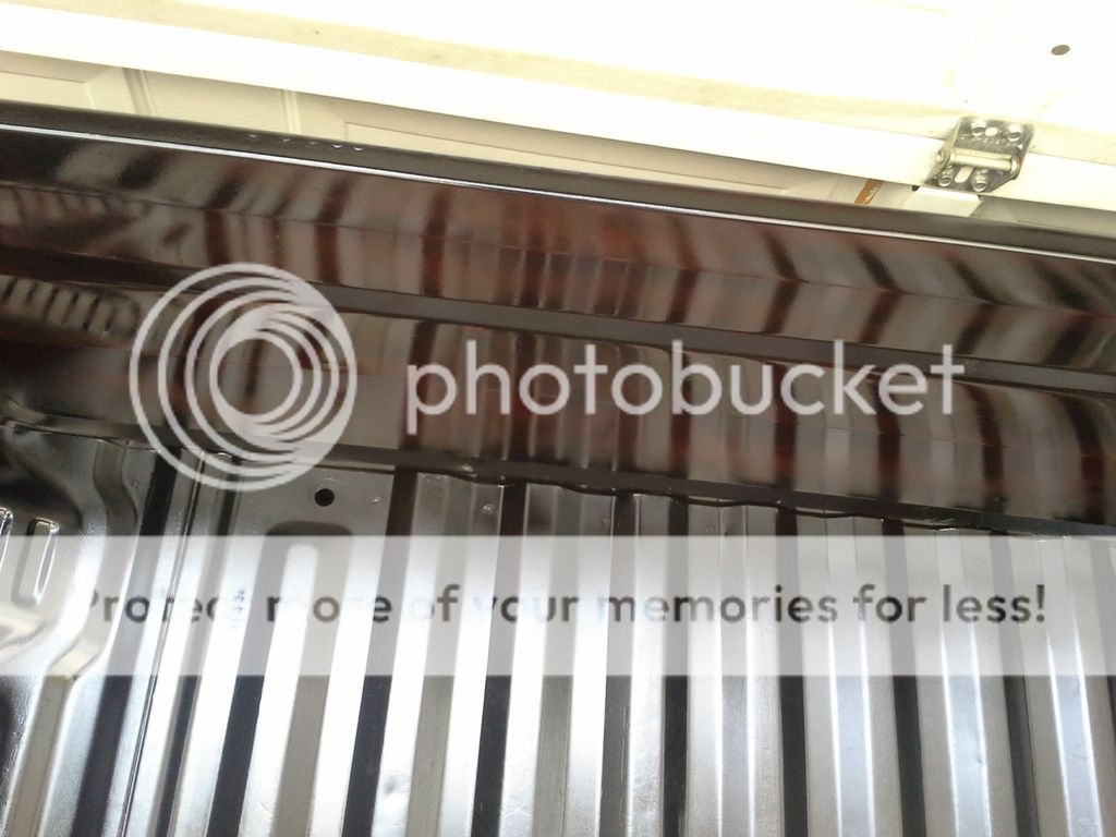

All sprayed:
The head gate got sprayed pretty well, but its mostly over-spray. I am waiting to do it properly until the bed is laid down again to do the sides.

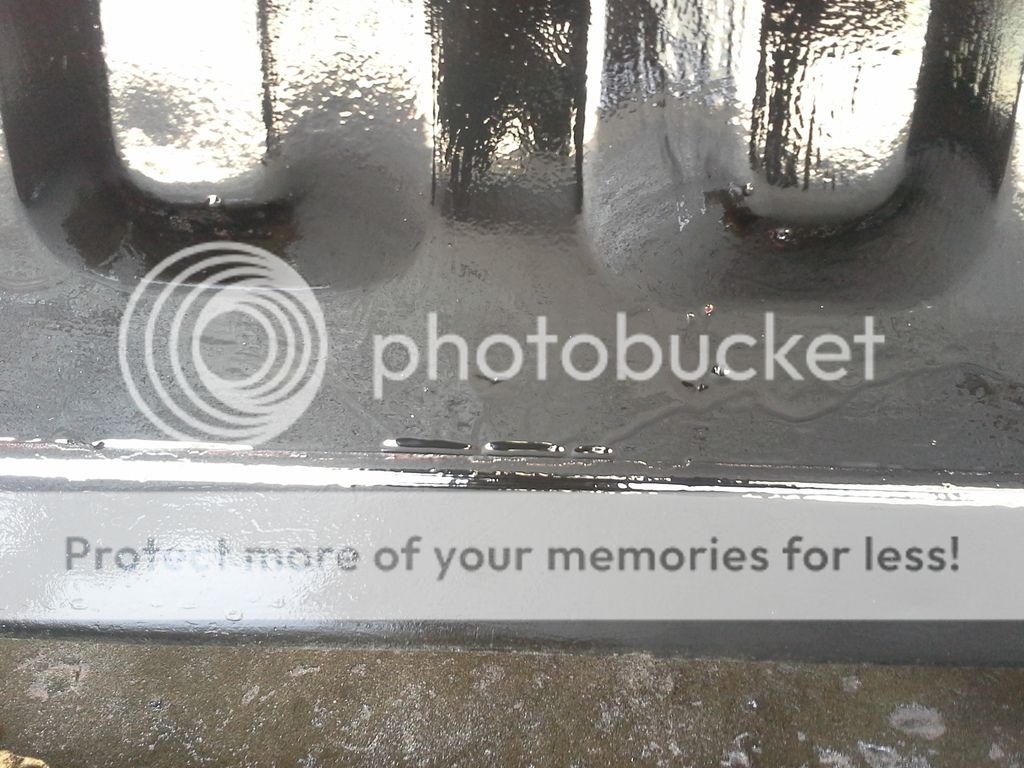

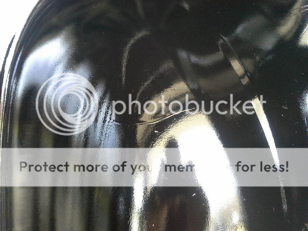

I am pretty proud of this spray job. It is again orange peeled pretty bad, which I am starting to think is unavoidable the paint I am using. But I did all that, spraying almost constantly for an hour, and these two spots are the only runs. I will get a few more pictures on Sunday or Monday. The orange peel on the first round improved after a few days of drying.
The top (front) of the passenger wheel well, done after I bumped the paint while it was still wet and tried to touch it up.
This one is all the way at the bottom (rear) of the bed. I think this one happened trying to hit the rear of those ridges in the bed.
Sanding and painting a bed is a PITA. I ended up laying about 7 or 8 extremely light coats. Almost 20 ounces sprayed today. The kind of coat you would put down if you had laid red but wanted it darker, so you just spot-coat some black over it. I wanted the paint in the bed thick because it's the bed. I'm still putting a drop-in liner back in, but in my mine that's all the more reason for a thick coat of paint.

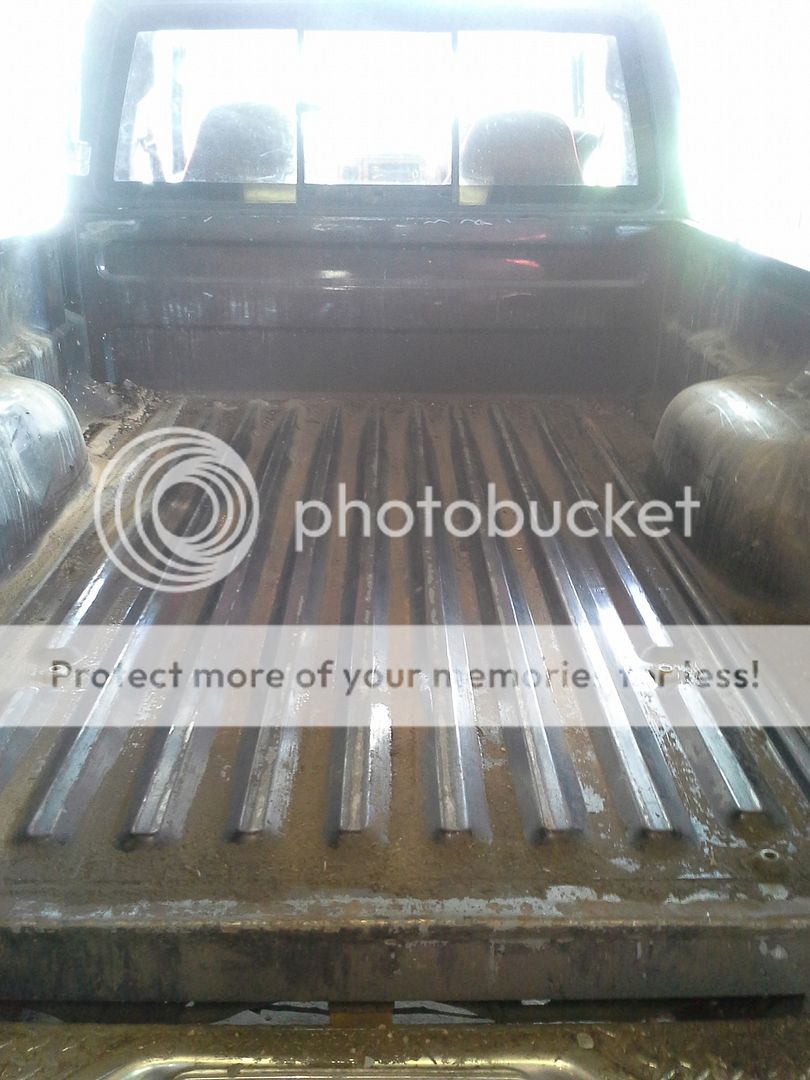

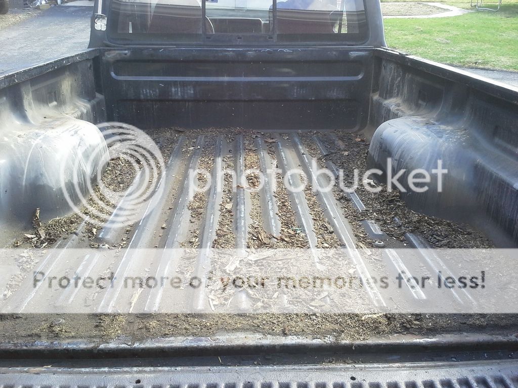

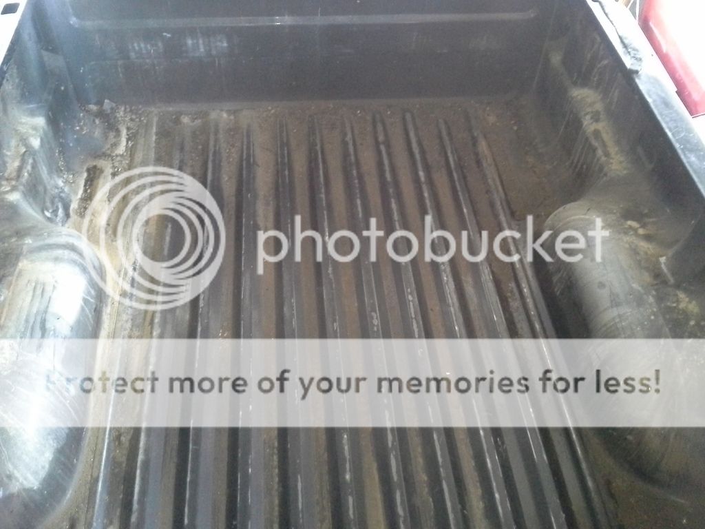

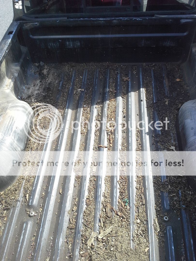

Today was the first time I have ever seen this truck without the bed liner. I was very surprised and quite happy with what I found:
All swept out:

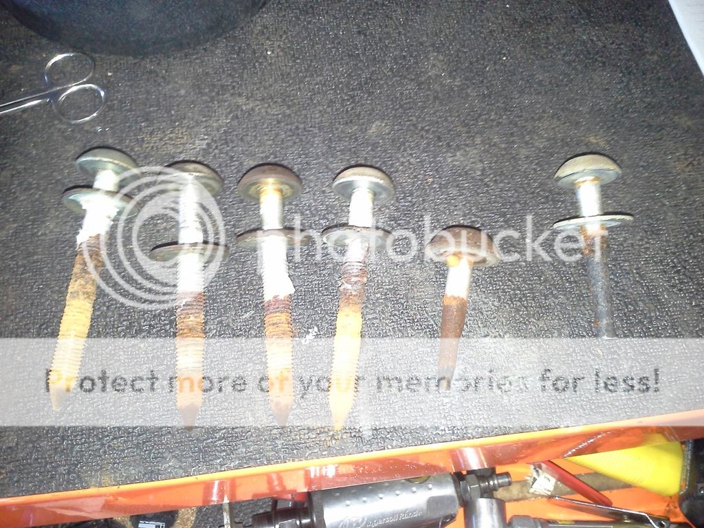

The bolts came out easier than I expected. The front two broke, two had to be started with the big ratchet, and the last one just came right out no fuss.

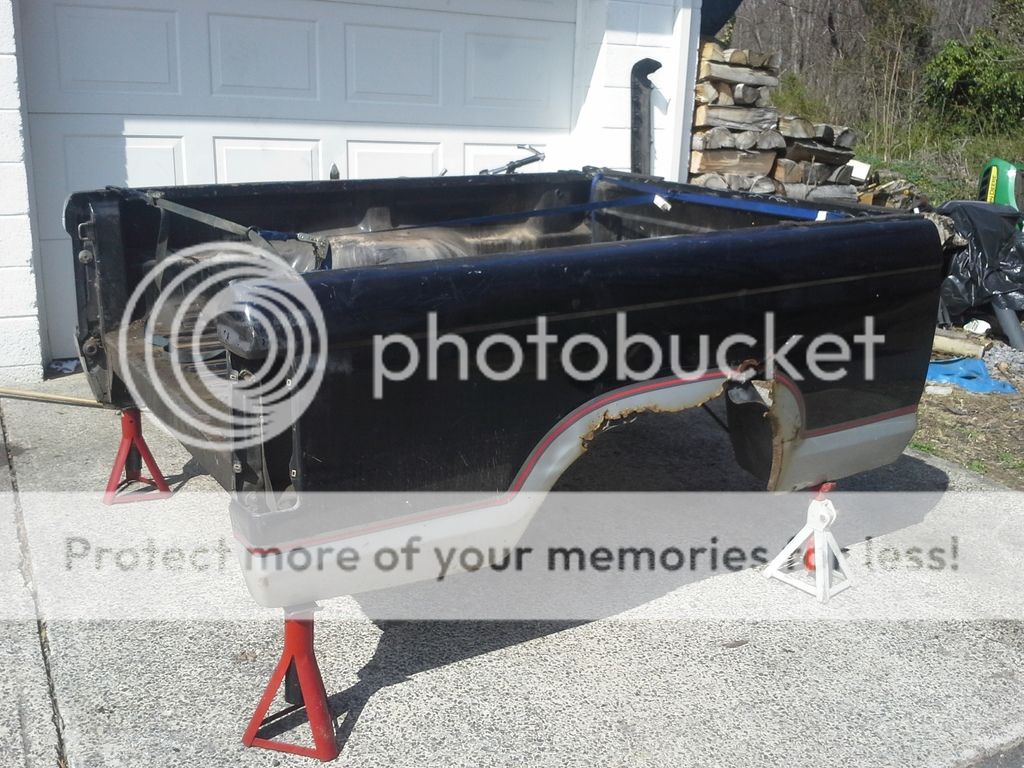

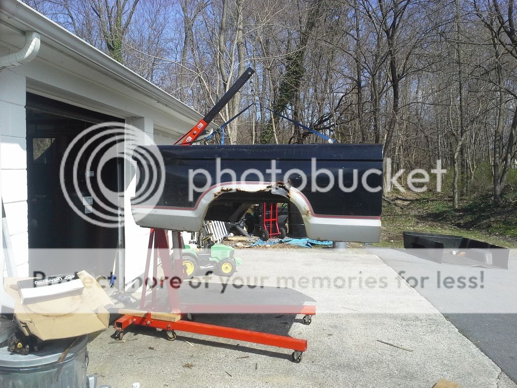

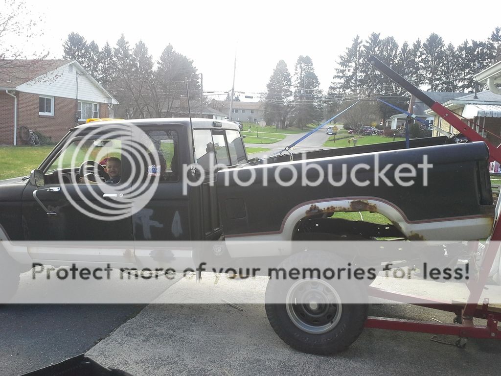

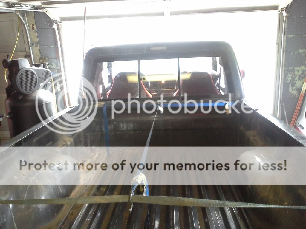

Nobody home but me and the boy, so I had to get creative getting the bed lifted off, or be patient, but we all know that wasn't gonna happen.
My helper driving out from under the bed
Came up and off really nicely:
Just remember kids, there is nothing you can't do with a cherry picker and a pile of ratchet straps.

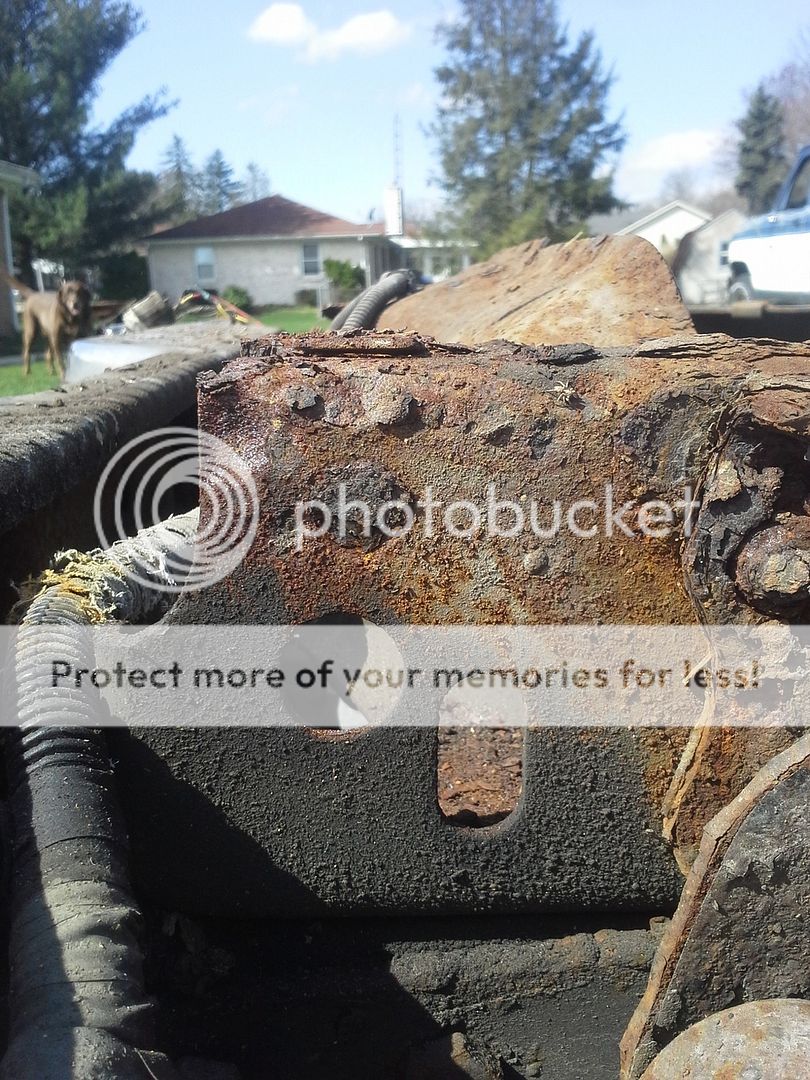

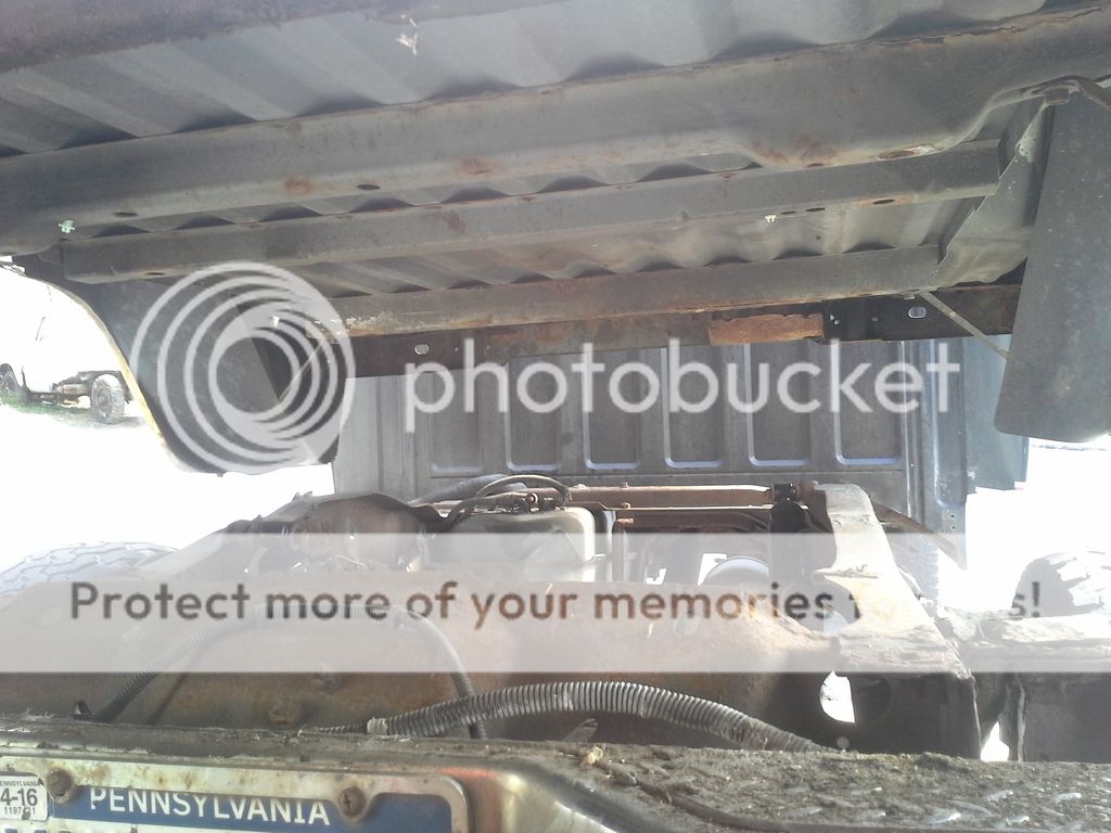

Overall this doesn't look as bad as I was expecting

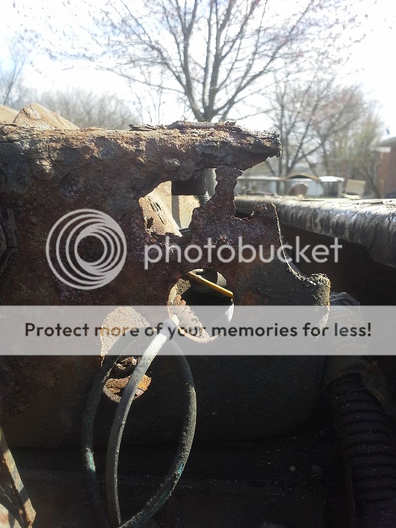

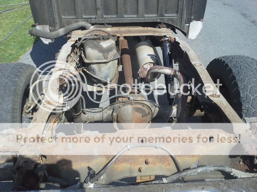

But this is all being done for a reason:
Now I need to get some materials to get that frame patched up, and get on that. I'm just not sure where to go for that stuff.
My bedliner works enough that it keeps the box polished to bare metal, no rust. Not sure if that is really good or bad but I am going with the no rust = good theory for now.
Looks good, you are having better results than I expected with that brand of paint. Around here it might be a tad on the cool side too, not sure about your neck of the woods. I have fought orange peel when I push the limit on temp before.
I am also good with no rust, but paint helps with that, and I have seen nasty nasty things under drop-in liners. I was very surprised to find the inside of the box as nice as it was when I pulled my liner today.
As for temp, I couldn't ask for better conditions, especially the last two days. Yesterday I started in long sleeves to keep the paint mist off my arms because it is sticky and hard to get off. I gave up on that less than 1/4 of the way through painting. It was in the 70s yesterday, and it is heading there again today.
