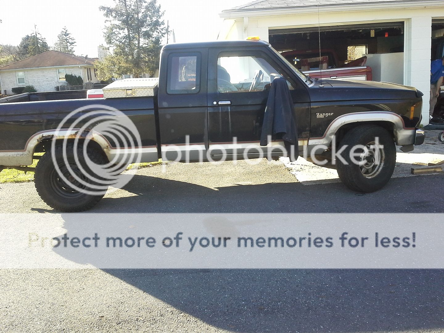

So I bumped to 31" tires today.
adsm08's Ranger build up
The rear tires are off my red Ranger, the front ones are take-offs from a van that was in the shop a few weeks ago. Yesterday I scored a set of 31x10.50x15 BFG all terrain TKO2s with a bit less than half tread for free. Those are going to go on my good wheels, but I needed them off the truck to do that, so I figured I'd put these on to get my trimming figured out.
