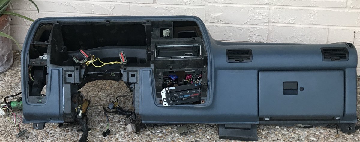

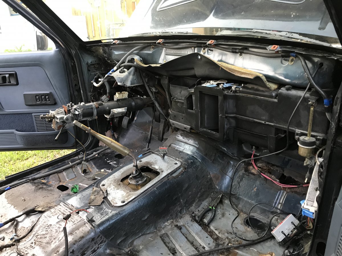

Last, but not least, I've had the dash halfway out for a while, but I have not been able to figure out what was still preventing me from taking it out completely. After weeks of trying on and off, I started poking around today and was able to figure it out! The next thing I need to figure out is how to take out the AC duct work. I want to get rid of the insulation and check for rust. The insulation around the duct work is wet, so I need to investigate. It looks like its two pieces bolted together at the firewall. Whenever I have the better part of a few hours, I'm going to start unbolting and see what happens. If anybody has guidance here or can link a relevant thread, please let me know.
