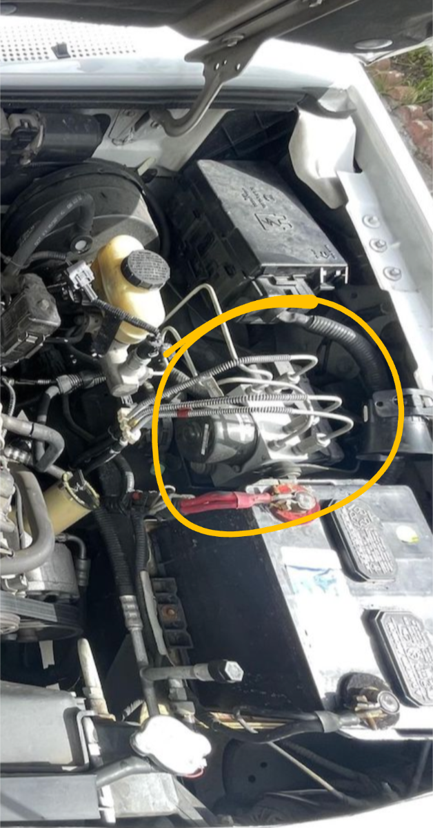

Where is the ABS module? I don’t have anyone to help me bleed the brakes so I’m kinda sol on that
