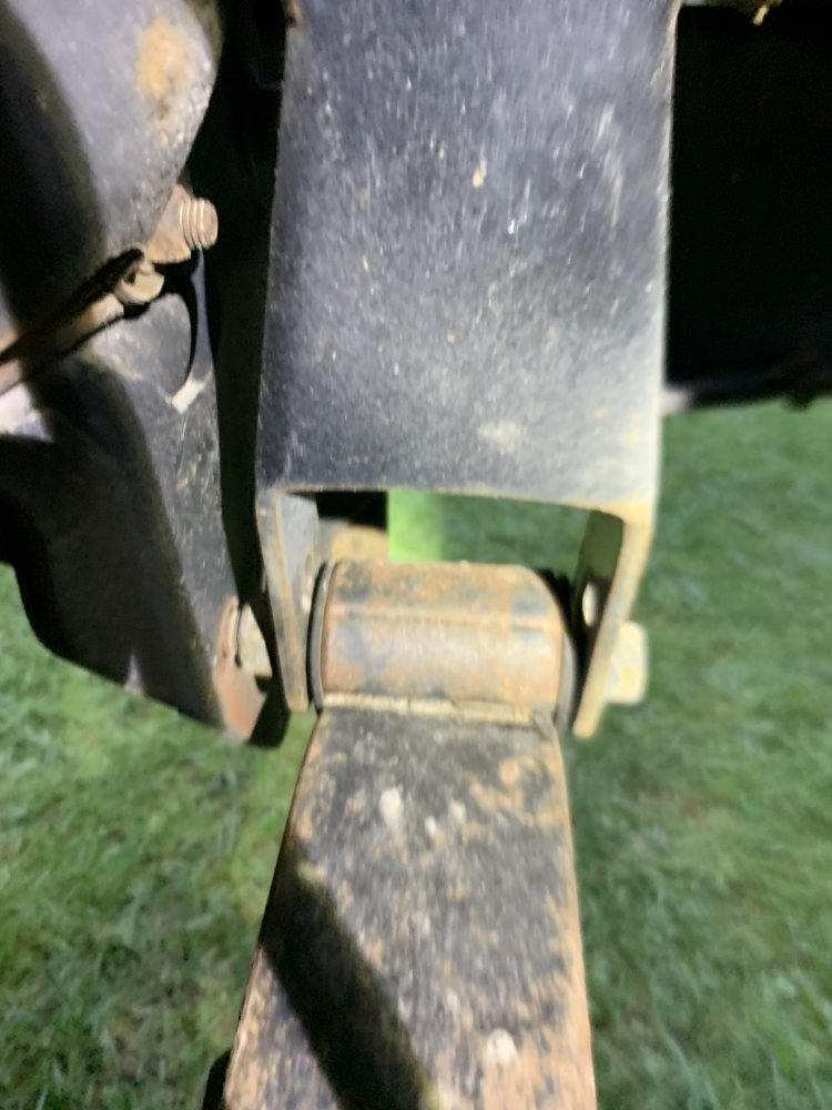

The camera on my phone wont focus it seems now but I got a photo of the rear shackle and where those are set. As I said the front has 2” keys but I had to back them off nearly all the way just to get the front down to 37” and the axles seem to be still at quite a steep angle. Or is this amount of lift just fine? I wouldn’t be opposed to dropping the front an inch or more either or the whole truck.

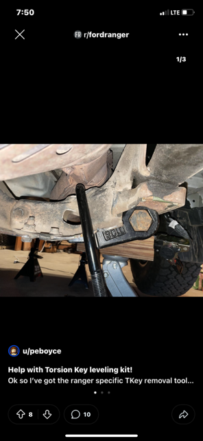

My torsion keys say 0108 on them so I would assume that these are 2” keys for an ‘01-‘08 Ranger and if I read it correctly. The ‘01-‘08 stock keys would lift my 2011 truck two inches already so these +2” keys are actually the equivalent of a 4” lift on my truck? Does that make any sense? My brain is scrambling🤯
Not mine, but here is a photo of what looks like the same keys that I have:
The rear shackles aren't affecting ride quality, only ride height. The back will ride rough when unloaded because it's a truck and it is set up to handle with a certain load.

shackle angle can majorly affect ride quality. in this case i am not thinking it is the main issue.

In the pic it almost looks like the spring bolt may be contacting the receiver hitch bracket...
looks like a decent witness mark though not in a scraping arc....maybe it is trapped.... :woot: that would be rough......and if it is a normal fold shackle it looks backwards too.

It does look like the bolts are hitting and they are like that on both sides. The top bolts look tight to me but Im not sure. What can be done to remedy that?

I'm wondering why that bolt head is soclose to hitting that other bracket. As mentioned, it dies look like the shackle may be backwards. But I would only expect that to be a factor under heavier load conditions. But I could be wrong.
seriously it can really be an issue

by the math and spring rate/length and my experience. this should net a horror show ride. i did not even come close to starting there. but it actually gives this particular setup the most stable ride and ok ride quality where it ended up.. took me quite a bit of trial and error....i was going off k trucks and jeep j 10s. the rear shackle is a long jeep style, and it sits where we like them. but i dont run normal springs back there either.
his rears look like longer then factory shackles but until we have more pics can not really judge it.
