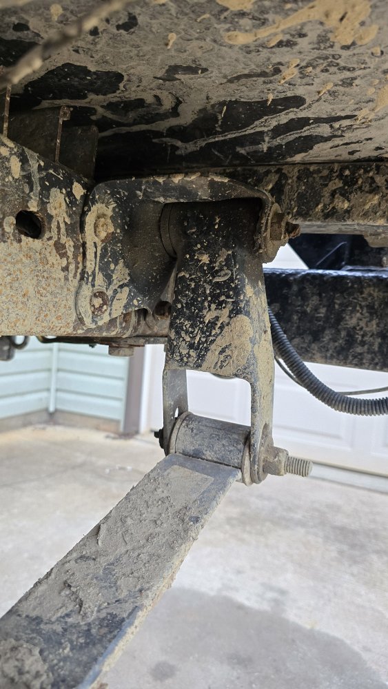

But on the rear, I would;
1. Flip the shackles around so the flat side us pointed rearward. Even though you will see in the picture that mine are oriented the same as yours.
2. Replace the bushings. Usually the bushings have flat flanges that will fit snugly between the sides of the shackles.
3. If you want the rear lowered, put the spring bolt through the upper set of holes on the shackle and put the head of the bolt toward the inner side of the shackle. Orienting the bolt properly will give extra clearance. Having the shackle flipped around to face the other way will give more room for sprung and shackle to clear each other when heavily loaded.

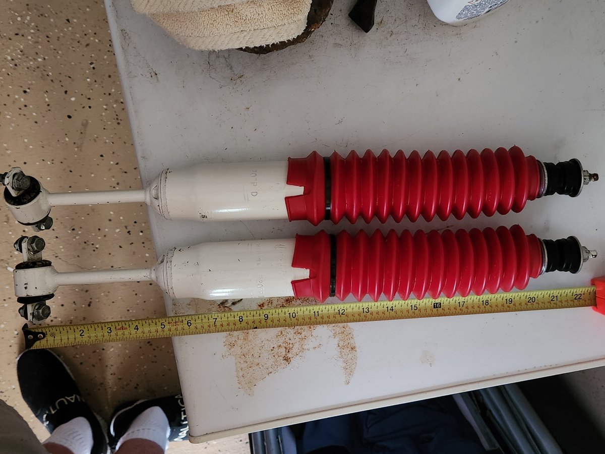

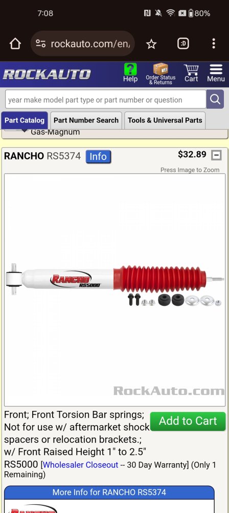

I'm going to email Rancho as well and confirm that my shocks are the correct length for a lifted truck. Rock Auto says that the Rancho Rs5229 (what I have) fit a Ranger w/ 0" of front lift. They show a different model of Ranchos that says they fit a Ranger with 1-2.5" lift

I also confirmed that it has the wrong length Ranchos in the front. He put stock length shocks on it and Im guessing thats why it rides horribly. I have not checked the rear to see if they are correct for the lift but I think I will just order those at the same time since those are fairly inexpensive.

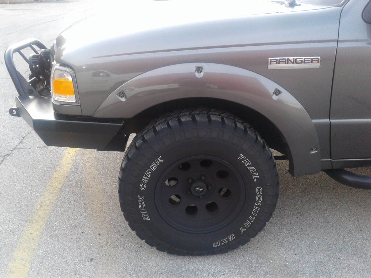

Can anyone confirm how much the front of my truck is lifted? I measured as gump showed me and got 5 7/8” but is there anyone with 32” tires that can give me a measurement from the ground to the fender so I have a known starting point when installing the new keys? With a 1.5” lift, how far should my fender be off the ground?

If i remember, i can measure my fender but i have 30s so you will have to add .75 (since yours are 31.xx). When i di my torsion bar adjustment, i used the factory points and set it at what the book said to set it at

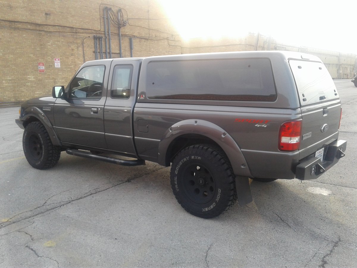

When I set my torsion bars I went with 6 inches. That's 1 1/2 inches over the stock setting.
I ran my 265 75 16's for a couple years with the factory stuff. The early factory keys should give you plenty of room to clear your current tires.
My truck with factory keys and 265 75 16's... at factory settings.

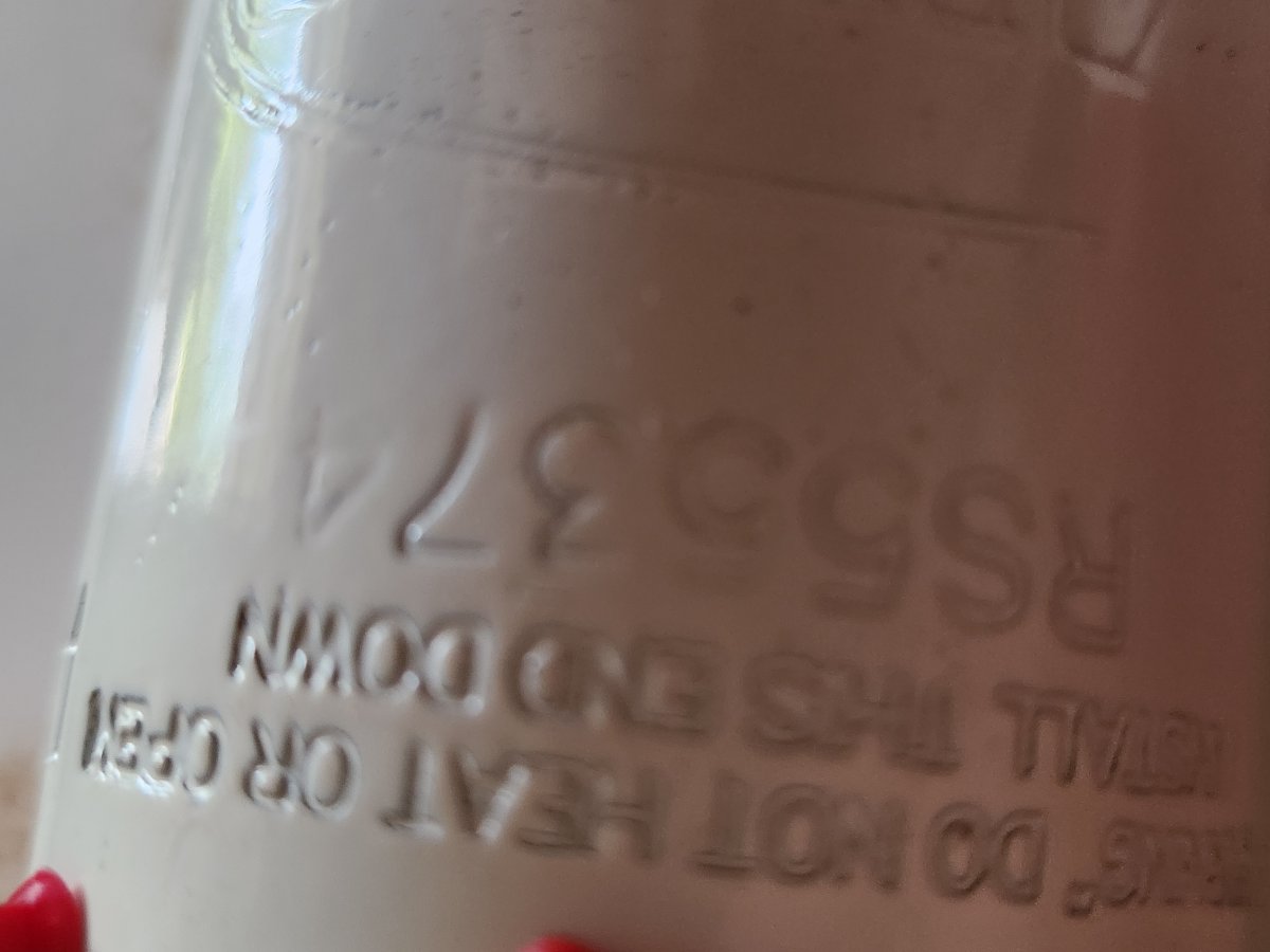

The Rancho RS55374 is the one. I have 2 of these, with only 1500 miles on them, The boots look new as the shock is too. If you want, their yours if you pay shipping from Texas. EDIT: Maybe $25. All the new bushings & hardware included. My front end was modified w/ coilovers and no longer need them. These are the adjustable type. See the pics below.

My stock 2007 Level II keys- I'd have to keep searching for. If I find them you can have those too, but maybe there gone. I'll keep looking. Also later today I'm going to give you my measurement after a 1.5" front lift with 31.6" tires from the underside of the fender lip to the ground.

I have a feeling that some of my harshness is coming from the front shocks as they are stock length with the lift.
Thank you Doug! I would have taken you up on this but I already ordered shocks from Rock Auto and they should be here tomorrow. Maybe I’ll try just putting the new shocks on and see if they fix my issue. I expect it to ride stiffer than my Ford Edge but not as bad as it is now. You are correct that the previous owner probably lifted it for looks and consequences be damned haha. The front was cranked up even higher when I bought it and it was downright dangerous on bumpy roads.
