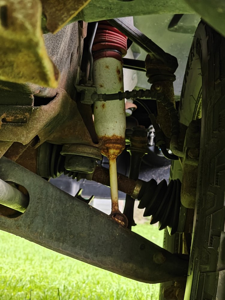

this is definitely about as far as i would try...more then i would be comfortable with. at that height its gonna ride rough. like gump indicated there could also be shock bump but that looks like a higher travel shock.
lift knuckles and the high travel cv axles would be ideal for these situations.
I'm going to agree... that looks pretty much maxed out if the weight of the vehicle is fully on the suspension.

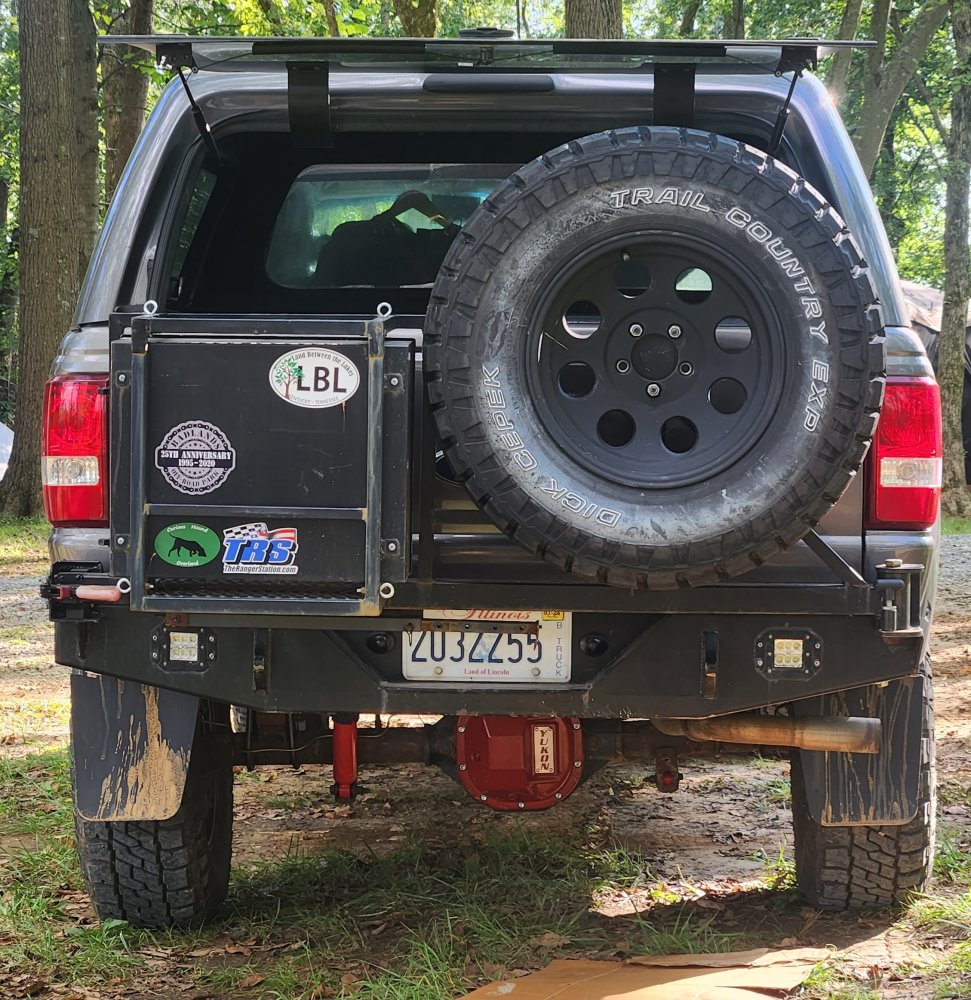

My truck with new 1750lb rear springs with a one inch lift shackles. The Rough Country lift keys and my factory t-bars which are the small diameter with 1 1/2 crank. It rides currently 265 75 16's.. It will get the large diameter t-bars I got from @MaicoDoug ... thanks again sir... and when that happens... I will likely go back to my factory keys... if i can get enough adjustment out of them. I kinda need the heavy t-bars due to the AOR bumper/skid plate. It's also getting a 10k winch. The heavy bars will handle the load much better.
I need to get a quality picture of my front suspension at ride height.
I'm not gonna lie... it rode better with all factory stuff. But where's the fun in that or making it your own... building it for what you want to do. So with that in mind... I chose to build it how I want it with the understanding I was gonna lose some of the cush.
Oh... and I like a little rake.
I'm too off center for level... and I can haull a load and be level... the way trucks were intended.

The rear... I would first ensure your leaf springs are in decent shape. If they're flat or negative arched at curb weight... they need replaced. Many times people will put a lift shackle on to compensate for weak springs. Being from a place that uses road salt... you really need to inspect your spring hangers... pretty common rot point. Also a lift shackle will offset the height of a lift block. Factory shackles are cheap so I wouldn't bother asking for the old ones. Lift shackles are typically more robust then the factory replacements.
It looks like your shackles have another set of holes. Moving the spring to the upper holes may get the rear where you need it.

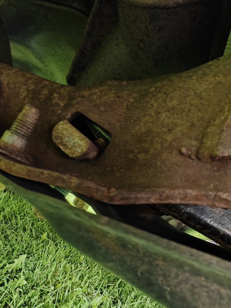

If I turn the torsion bars down anymore then the keys will be sitting on the stops and the bolts will fall out. That's my problem. I just need to replace them I guess. Regardless of how much higher mine is than stock, it's too high and I need to lower it. I'll go out in a bit and check with a tape measure.
so you are saying you are all of the way slacked off?

Yes one key a little more than the other but they are both pretty close to all the way backed off. Maybe 1/8" or so before the keys are resting on the block that the bolt threads into

So I had to go to a parking lot to get a good measurement but measuring as you described Uncle Gumps, I got 5 7/8".

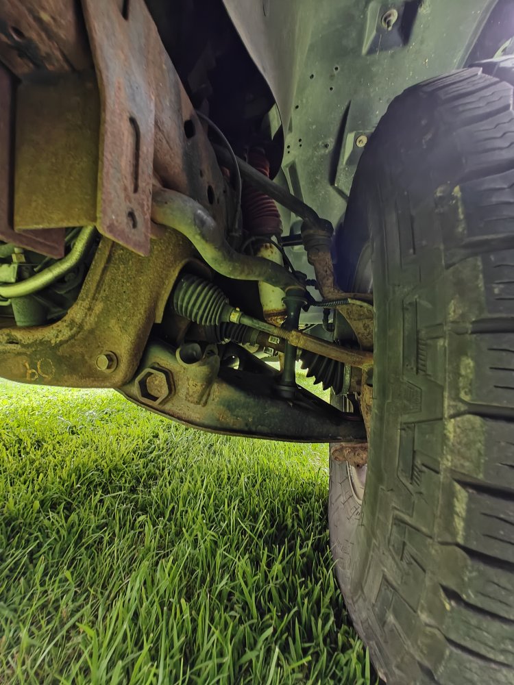

It appears I actually have a little more room to drop the torsion keys (about 1/4" on passenger side and 1/2" on driver's side) I may take them down more just to try it but I don't like the idea of having them so close to fully backed out and also the adjustment bolts are hanging down quite far.
Just snapped a few more photos with a better camera
