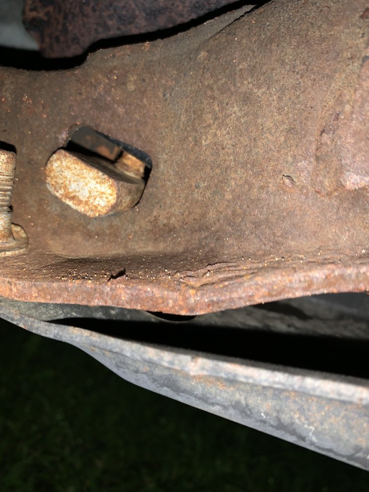

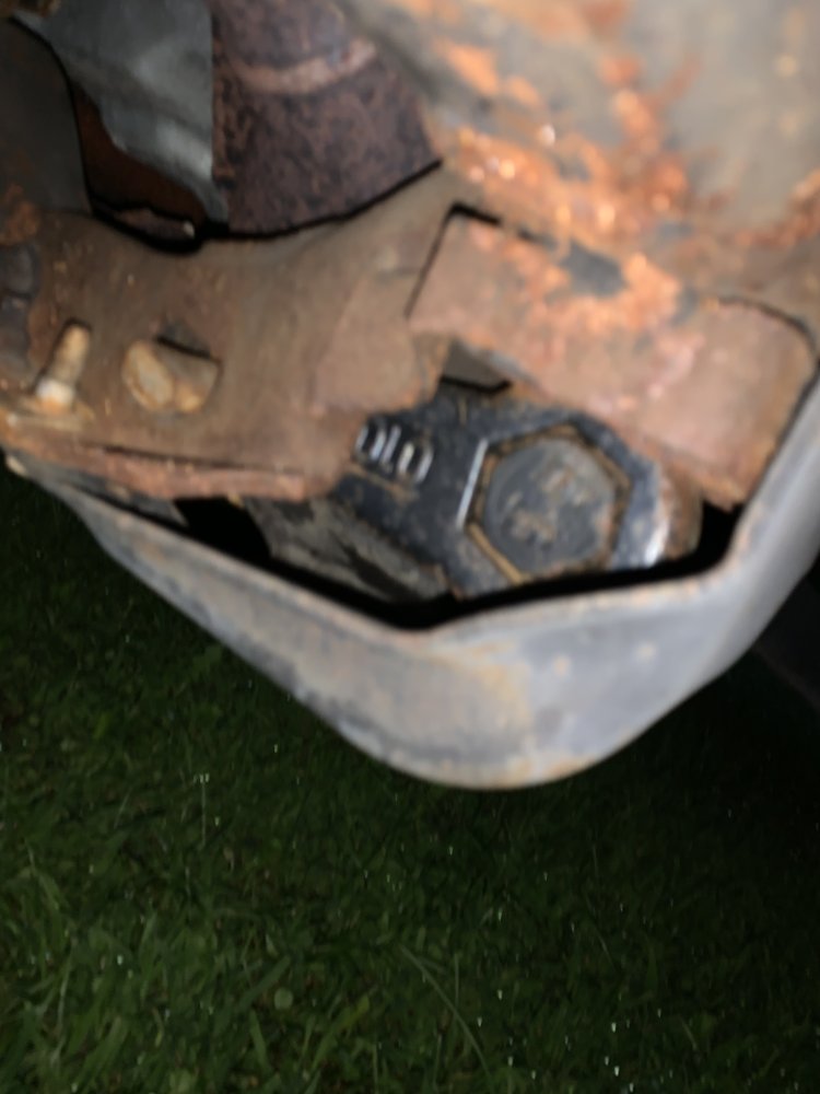

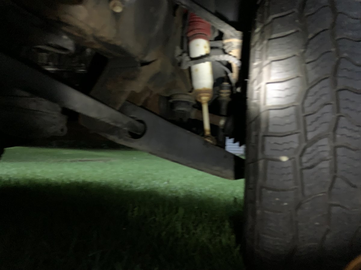

I took some crappy photos of the axle angle and the torsion keys to show how far the bolts are backed out.
That looks like a lot control arm angle, lots of torsion bar crank.
Not only a lot of preload on the bar, if that shock is for stock height, it may not be in proper operating range.

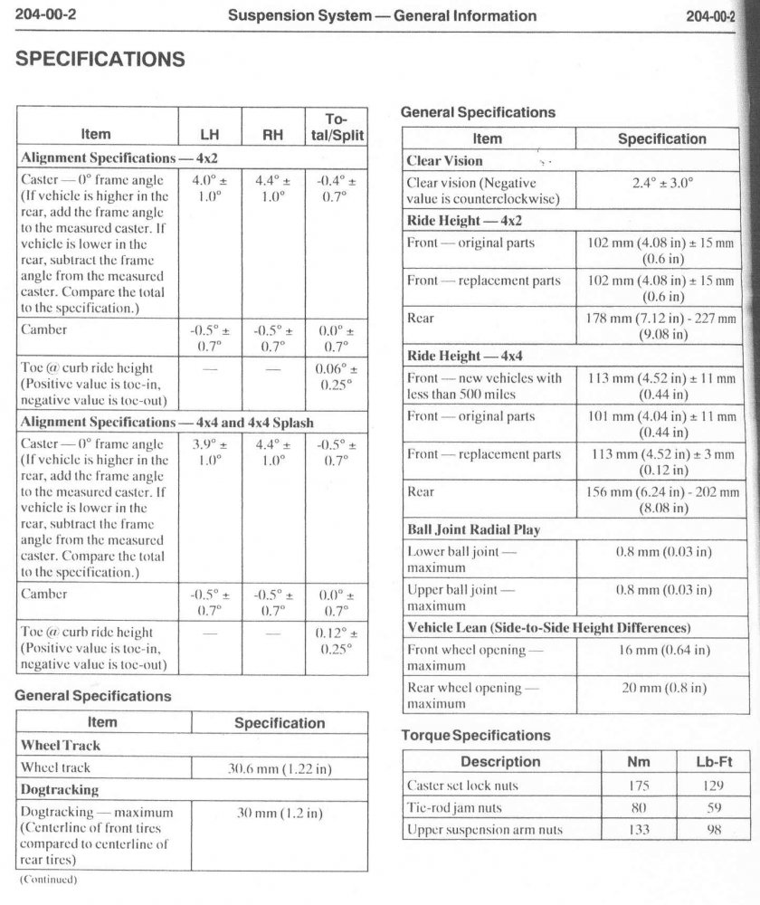

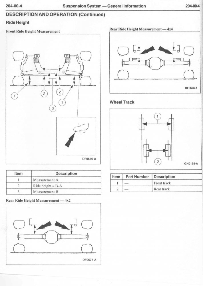

So... all the talk of ride height... we should actually look at the way it's measured. It's not fender opening to the ground... it's the difference between a point on the lower control arm vs rhe stationery control arm bolt on the frame cross member. These specs are going to be for the pre 2008 model that have a higher ride height.

I'll also add that the down travel stop is actually when the upper control arm contacts the frame. That corresponds extremely close to the full down travel of the shock absorber. On my truck... one side hits the frame first... the other side actually hit the bottom of the shock first.

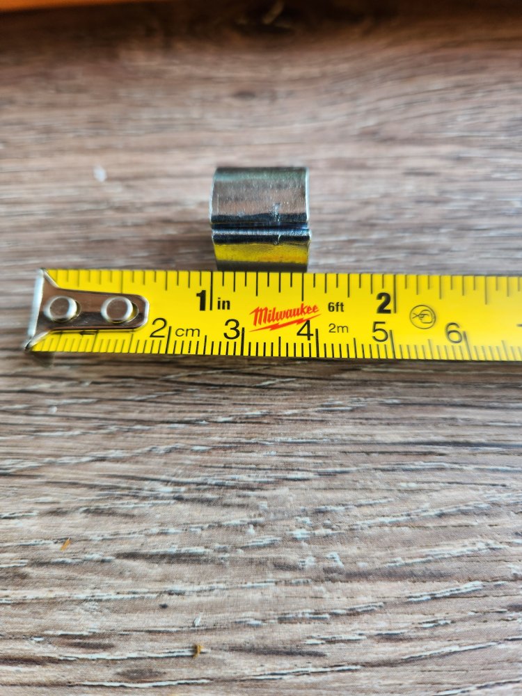

Here is what the shock spacer looks like and it would go under the lower upper shock bushing and washer. It's intent is to give the shock a bit more travel and keep the shock from trying to function properly at it's full extended limit.
