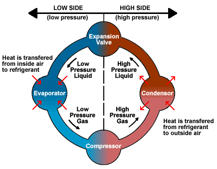

When I did the evap work last year, I forgot to put in the expansion valve/orfice tube. Could that cause the symptoms? @Uncle Gump
Yes, yes,yes!!!!!!!!!!
the orifice forces a change in pressure of the refrigerant from a high pressure liquid to a low pressure liquid. This is necessary for the refrigerant cycle to work and do it’s job. It can not function properly without that.
the orifice forces a change in state of the refrigerant from a high pressure liquid to a low pressure gas. This is necessary for the refrigerant cycle to work and do it’s job. It can not function properly without that.
Not quite true... even the graphic states that the expansion valve/orifice tube doesn't changes the state of the refrigerant... only the pressure/temp of it.
The refrigerant will actually change state from liquid to a gas inside of the evaporator. Fun fact... it will change states but remain the same temperature.
If the system is low it could change states at the valve but you would see a frost build up on the line at the orifice.
If I am reading this correctly, there is no orifice tube installed at the moment?
I think it's there... he just didn't put a new one in.
But I could be wrong.
I just re-read it...
maybe he didn't put the orifice in at all.
If that is the case... that is certainly the problem.
He states that he forgot to put it in.
I was wrong with my “change of states” statement. But that pressure change is a vital part if the cycle. Without a metering device (orifice tube or metering valve) it will not happen and the system will not work.
i went back and edited my earlier post. I’m at work and got interrupted before I could double check my work against the diagram earlier.
Absolutely correct.
I read his statement completely wrong. Like he didn't replace the orifice.
Took me a couple reads through to get it all too 😄
I would evacuate the system, put the orifice tube where it's supposed to be, vacuum and recharge it and see how it works. I bet that is what's going on.
