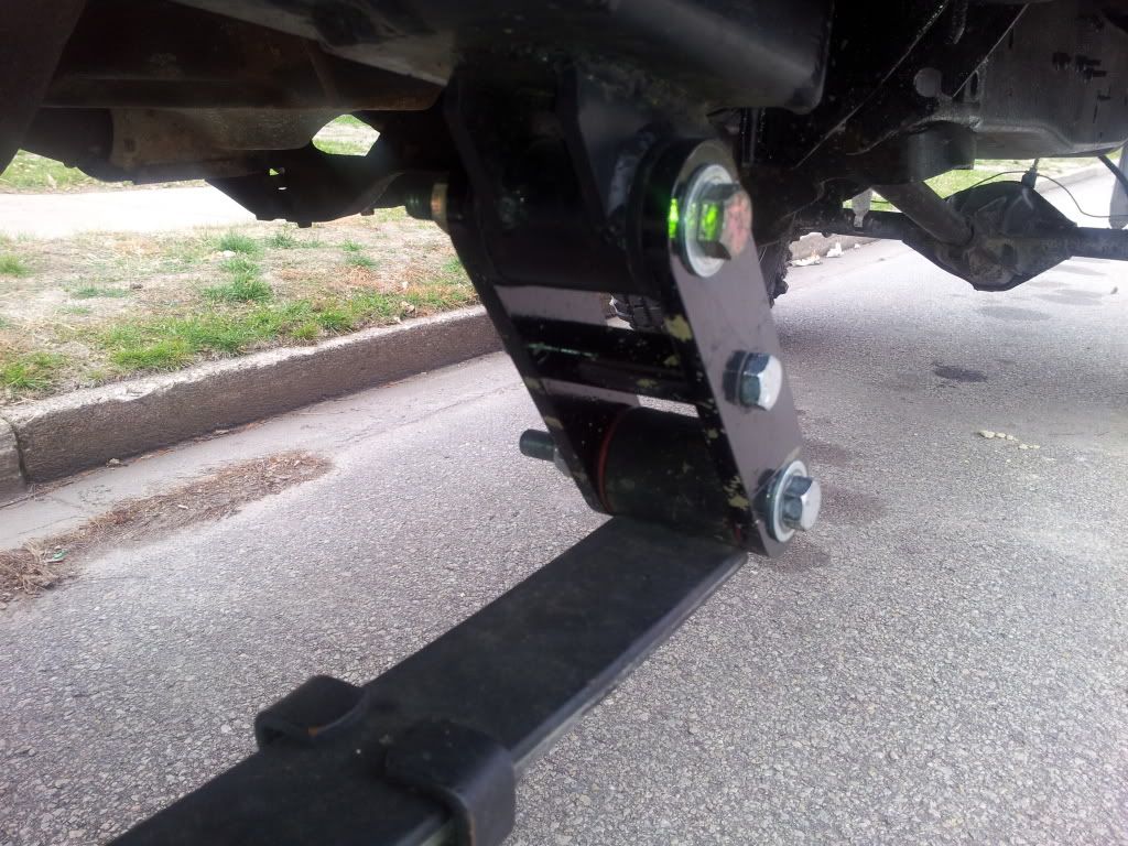

I redid my front leaf springs shackles. For my rear leaf springs i used chevy 2 in loweing shackles in place of the stock ones.
Here is a pic of my new shackle, decided not to weld them instead i put a tube in and bolted it up. It helped alot with the shifting i was getting. Still may weld them up.

looks good! thanks for posting pictures
