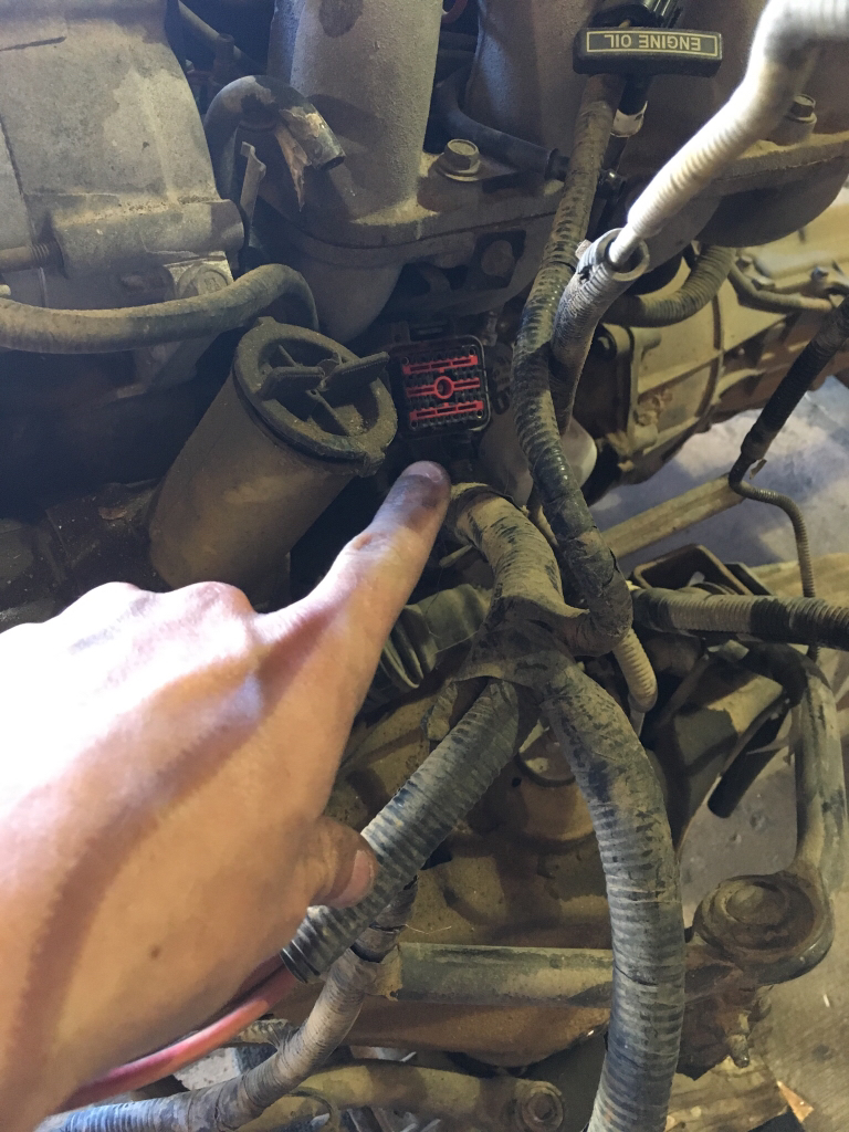

Second is the big plug that connects the engine harness to the chassis harness.

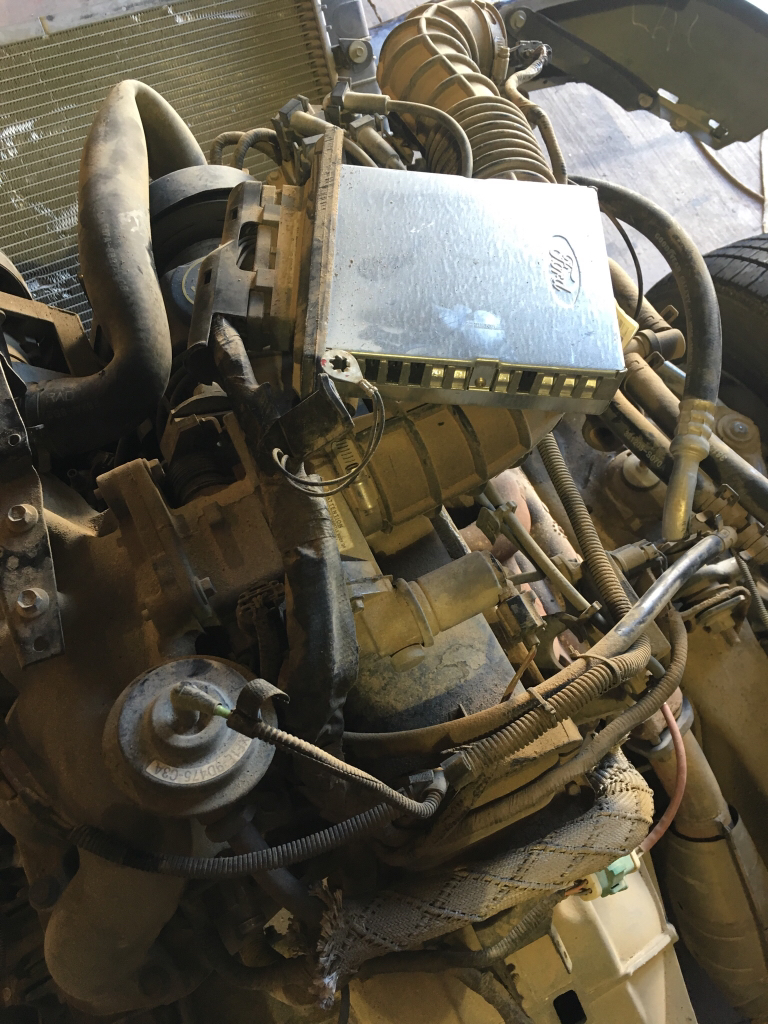

Fifth is the ecu still connected the engine harness.

After I thought about it a little bit more I do realize I do need the connection at the big plug that connects the engine and chassis harnesses as at least some of that is the power supply and relay supply for the engine harness.
Looking at it unintelligently it seems as though I could cut the pigtail off the chassis side of that plug and begin making my harness off of that.
