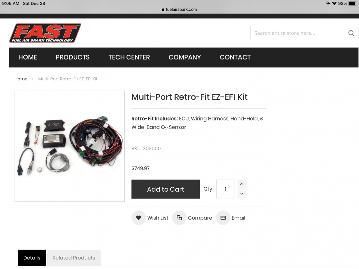

I used the FAST EZ-EFI for the multi port.
