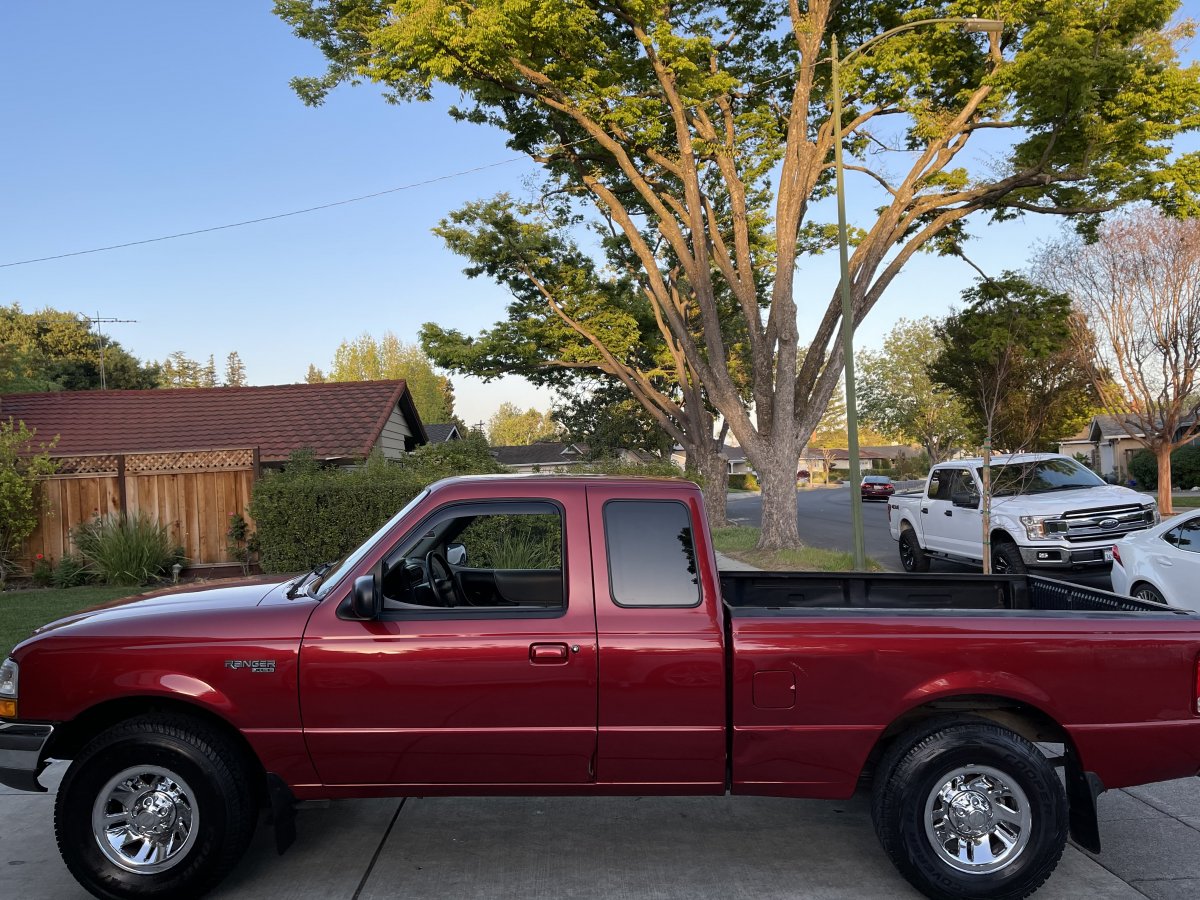

Dudes,
I just bought the WULF 2.5" Front 2" Rear lift kit. I ordered 31x10.5 tires and 15x8 wheels. I'm thinking 31" is weak shiiii, and about going up to 33". Can I run this? If I can what else do I need to make it work or should I just stick with the 31s?
What I got - '98 Ranger XLT 2WD, Manual.

What gear ratio do you have?
3.73 gear and 33 inch tires don't go so well together.
Is you truck TIB or SLA?

The kit you got isn't enough for 33" tires. 31" tires is the limit and not rubbing or at least not rubbing badly. You would need one of the lifts mentioned above for 33" tires to fit. Keep in mind, the 4" suspension lift can cause reliability issues with your front drive shaft. There is products out there to address that but even then, it can still be an issue. Note that I'm saying CAN and not WILL. But you need to go in knowing the info up front just in case you end up having issues.
The benefit of the suspension lift is it will give you more ground clearance compared to stock but by nature of the torsion bar design, not as good as a TTB would. The rear axle clearance will not change since it is just blocks lifting the truck. The front uses drop brackets and knuckles to create the lift. The drop brackets lower some items like the Torsion bar mounts and lower control arm mounts in order to make the system work. The angle front drive shaft increases from the lift and that is what causes the reliability and wear issues.
A body lift is cheaper but creates big gaps between the body and the frame, which can be undesirable as far as looks. Also, some items may need to be lengthened to prevent binding and allow them to operate properly like the parking/emergency brake cable and brake hoses.

It's a 2wd and not an Edge or Trailhead model so it will have the coil spring front suspension. 32's might fit but I agree, 33's won't fit and for gearing purposes I would stick with 31's.
FYI, 2wd Edge and Trailhead models sat higher and used the 4wd torsion bar suspension.
Anything can fit with a sawzall, lol
honestly I would probably stick with the 31s unless you want to lift it more AND re-gear to 4.10 or 4.56. I had 31s on my 2wd years ago with 3.73 gears but mostly stuck to 30s. My choptop I had 4.10s and started with 31s, lots of power. Then 33s and it was tolerable. Then to 35s and it did not like that, first through third it pulled hard and fourth it fell flat on its face with the 2.9l, had to swap to a 4.0l motor for enough power or I would have had to re-gear. I had the motor from another project but didn’t have the deeper gears
