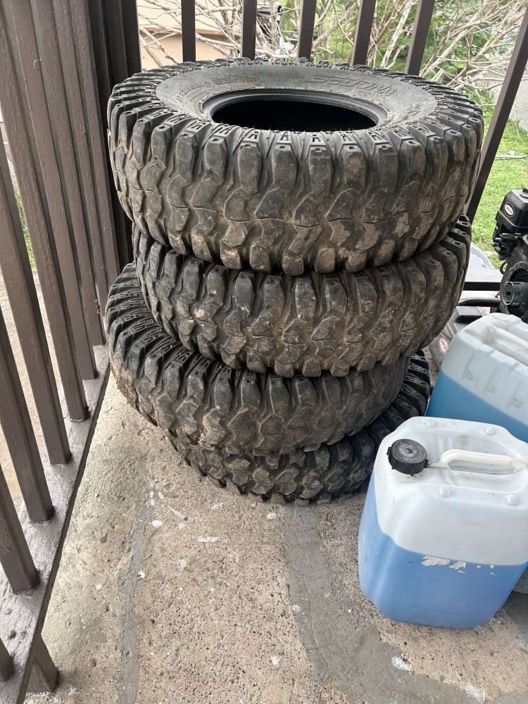

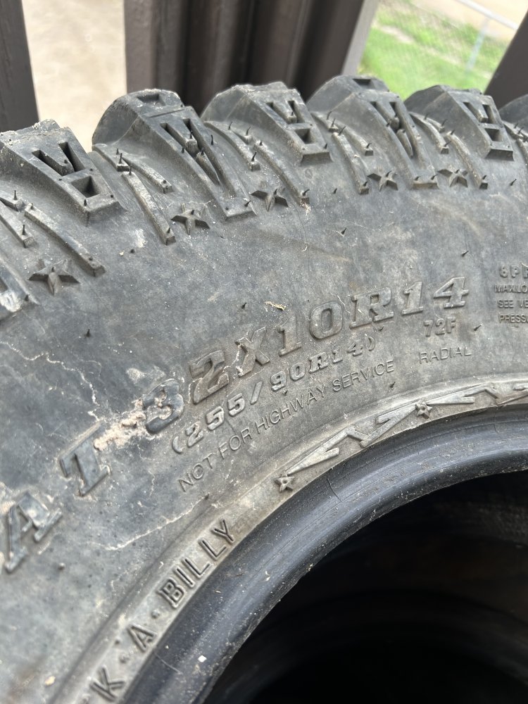

I got - '98 Ranger XLT 2WD, Manual.
And I need help on knowing how many inches should it lift to put on some 32x10r14

Assuming there are no axle blocks or lift of any kind in it now, about 2 inches as a minimum. Look at the back axle. If the springs are mounted directly to the axle, you have no lift.
If there are axle blocks back there, you will need to measure them and go from there.
The other option is a body lift where the rubber mounts are replaced with thicker ones to lift the body. If the kit dosen't include them, you will need relocation brackets for the bumpers to close the gap between the body and the bumper.
check your front brakes, 14" wheels do not fit over 11.25 rotor systems.
if you have the smaller 10" rotors with 32"tires you basically won't have any brakes.
