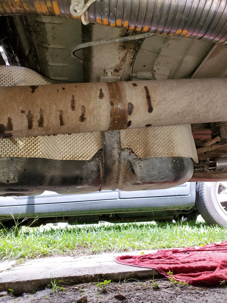

Yeah ill double check those joints to be sure. With how long the exhaust dragged on the drive shaft, wouldn't that throw off balance on it as well? Ill take picture of the damage on shaft so you can see. Also yeah ive been going one by one with sensors to see if they match part numbers and swapping what doesn't.
46801
hard to tell from picture but it does go into the driveshaft quite a bit, its not just outer scuffing

I think your exhaust on the driveshaft thing COULD affect the balance but it doesn't look like it wore into the metal much if at all. I'd make sure your u-joints are healthy and move on to another area... that little bit of rust rubbed off does not concern me much.

The wear on the drive shaft should be the same all the way around... so should affect balance very little.
