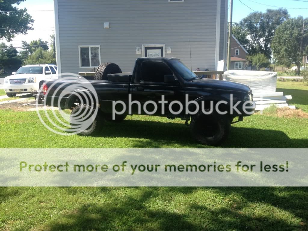

95 ranger dana 30 swap
Looks really good!!
Thanks I just put in a tool box today
looks nice and level now. It looks like you could of moved your front axle forward a couple on inches or are your tires turned in this picture?
They are turned to the right a little. I wish I would have moved it forward about an inch. I may drill out another hole in the perch to move it up a hair. It rub only on the driver side and it seems to have settled a little more on them at side in not real sure
I had to make my driver side shackle about one inch longer. Everything is parallel and all bolt holes are drilled exactly te came on both sides. Is there a reason the driver side would settle lower? And with the shackles angled rearward the ride is so much better! Even over the ttb but that thing was trashed!
I also had to lift my drivers side about a 1" higher. You got the steering box, battery and the fuel tank all on that side so thats why it leans to the drivers side.
I bet your right! That makes total sense now. I was thinking I measured something wrong!
And thanks I'm happy with it!
He'll yea everything I secondhand except the new springs and bushings. Steel was scrap from previous jobs I couldn't be happier
Here it is after shackle is fixed
Looks good. Super clean. I like the all black
Thanks I'm happy I just need to push the front axle up about an inch then I'll be happy
