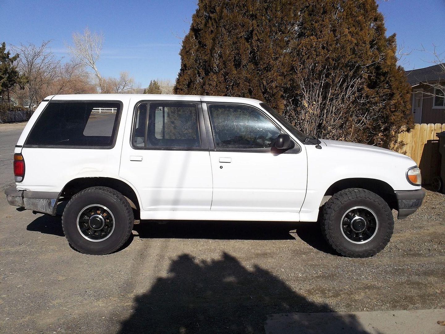

This project started out as a dirt cheap budget build from a salvage titled Explorer and miscellaneous junk I had laying around.
But as time went by and parts were broken, as many people would, I became bored with a very mild, mostly stock, trail beater. So it got parked and set on the back burner for a few months. But now it's back and going under the knife. A general overview of the current plans are, spring over rear (8.8), SAS front (D44), 37's, custom reduction box, and custom front/rear bumpers.
