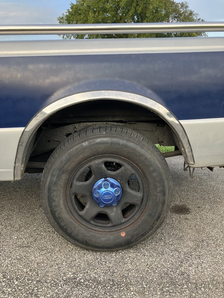

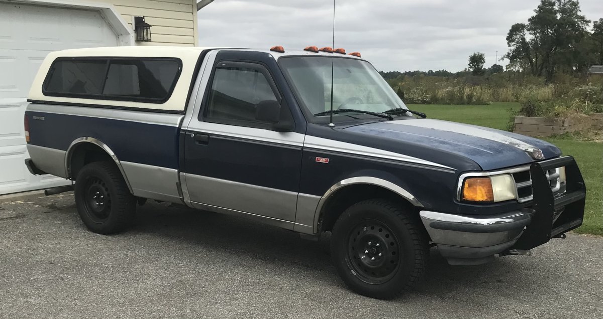

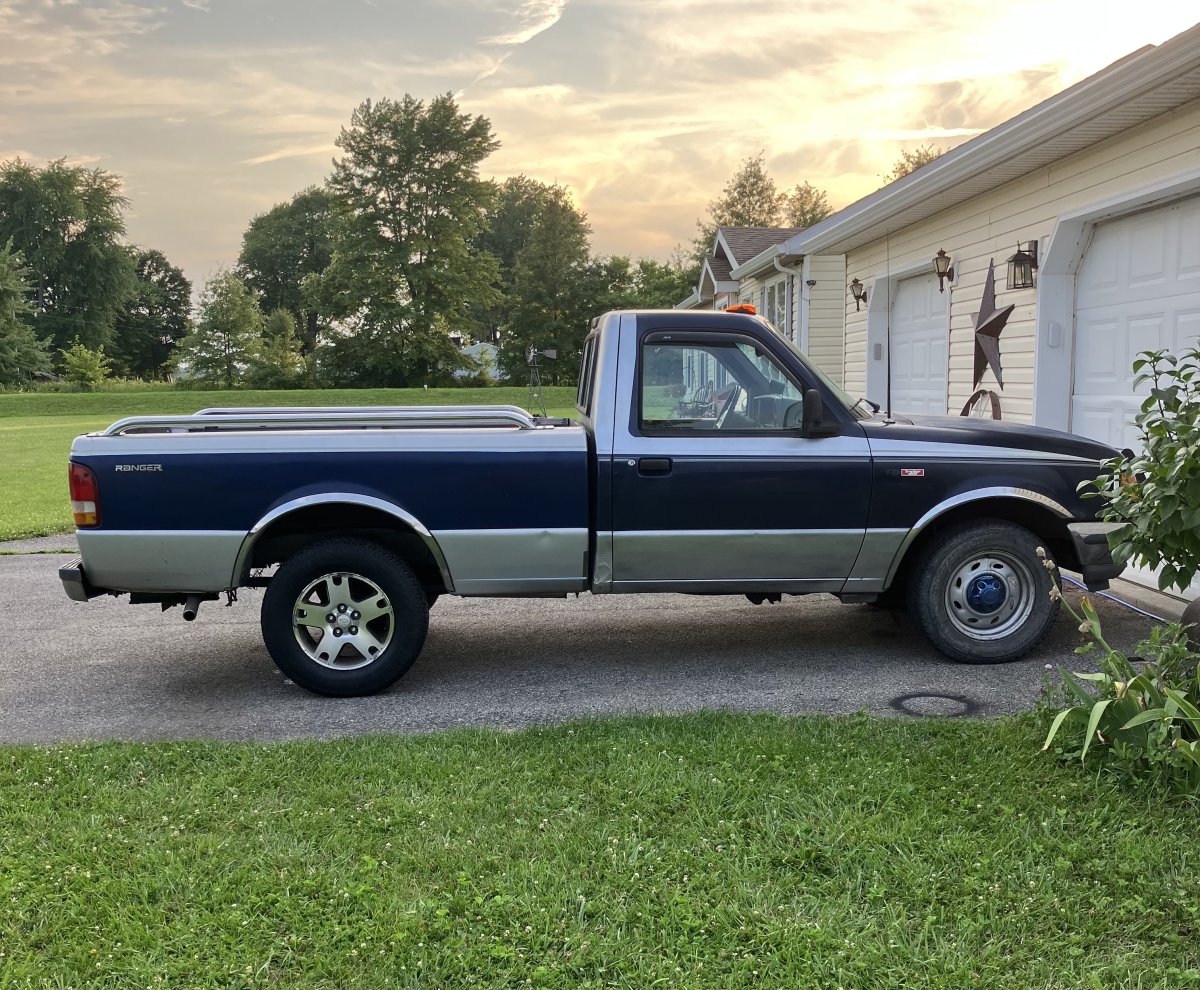

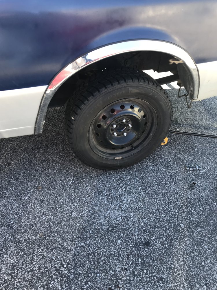

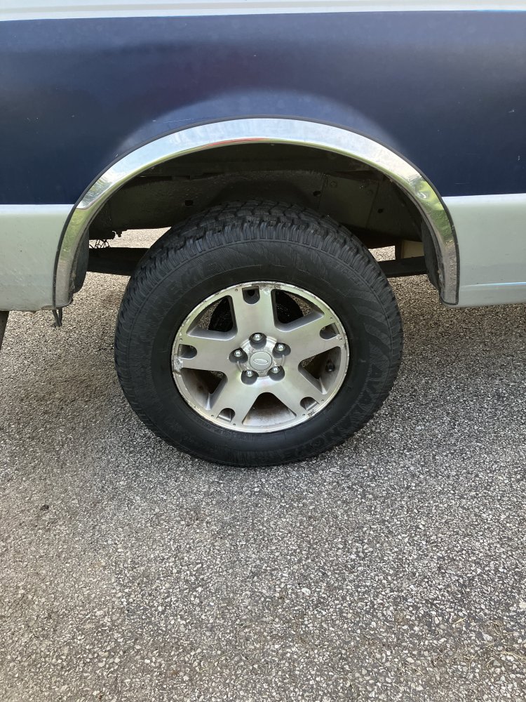

I had a set of dedicated winter wheels on steel for a hhr, I kept them when we got rid of the car & ran adapters to use them on my ranger. That ranger was a 2.3/2wd with 14’s originally. the hhr rims/tires were 215/60/16’s. Im not normally a fan of adapters or spacers but this worked & didnt have to buy ranger-bolt pattern 16’s to use them. And the good thing id the positive offset fwd rim was offset by the thickness of the adapter. I was considering trying it out with my escape but cant find those adapters now. I do have a extra set of escape wheels I could swap the tires to. And by the way, with a 2” spacer a escape rim will work on a ranger.

Any 15" or 16" Explorer or Ranger wheel will fit. Also one that people don't think of, Crown Vic police car steelies, the later years were 16".
Either 225/70-15, 235/75-15, or 235/70-16 will be fine.
Mustang and some Jeep wheels will also fit, the bolt pattern is the same but the offset is wrong and you will need spacers.

i have 235/75 r 15 on my truck that is a little lower than your splash. michelins
i got some jeep wheels from a tj to put on my ranger. they are 15x8 and correct bolt pattern and offset to use. you can use jeep wheels from wranglers (87-05), cherokees (84-01), comanches (85-91), and grand cherokees (93-98)
Thanks. S-J. Are your 235/75 r 15's on your Stock Ranger wheels, or the 8" jeep's. thanks.
yes sir, on the stock ranger wheels.
