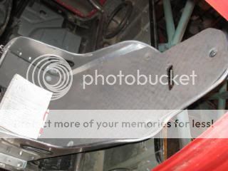

I use a Kirkey alum. seat;
with padding I put in, it's anti-fatigue floor matting;
two layers on the bottom, one on the back;
Do some more research on forums where they race before you make a decision. I don't know how fast you are going in your truck but if your strapped tightly in a non suspension seat you won't feel it to much, I don't, and IMO you'll be safer.
