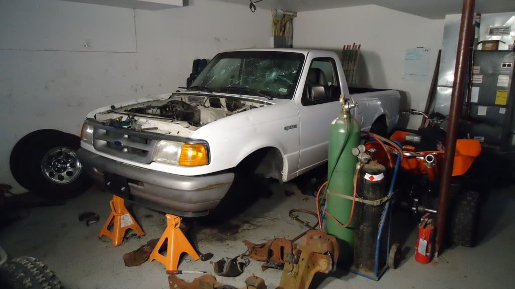

Sorry I usually get pics alot quicker, but my wife and I are getting divorce and she took digital camara, but I just bought myself a new digital camara today so I can get some pics, the truck has came long ways from how it was.
Yes truck will be caged forsure..
I'm gonna run Bronco 2 tank in the rear, and will have spare tire mounted on rear, battery in the rear. Rear bumper., So figured the Race pack is whats needed since tank is in the rear??

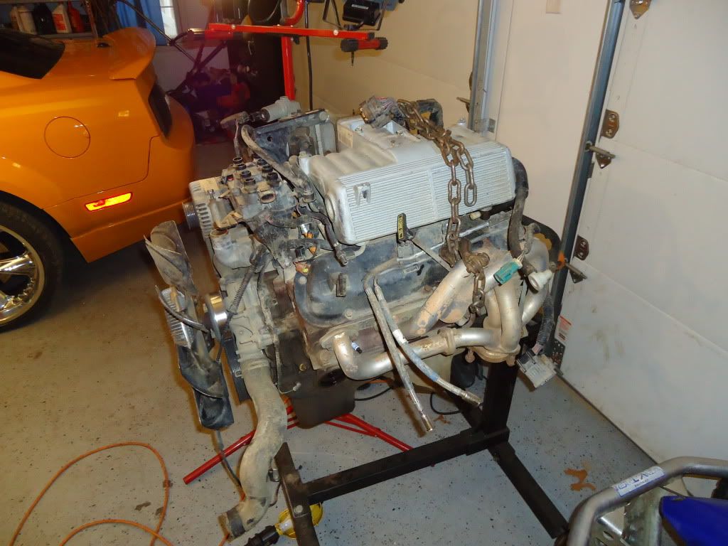

Progress is being made, my purple crawler is donating its cab and headers, L&L Mounts, Oilfilter kit, radiator. The rest of it will reincarnate into explorer sport LOL

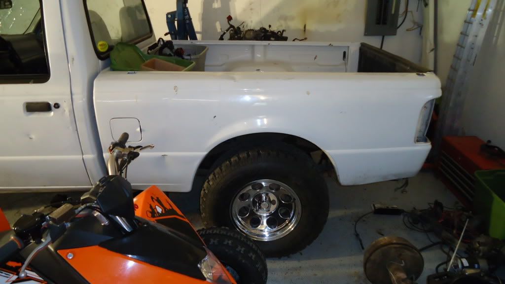

Little update: Pics of my new dailey driver toy.

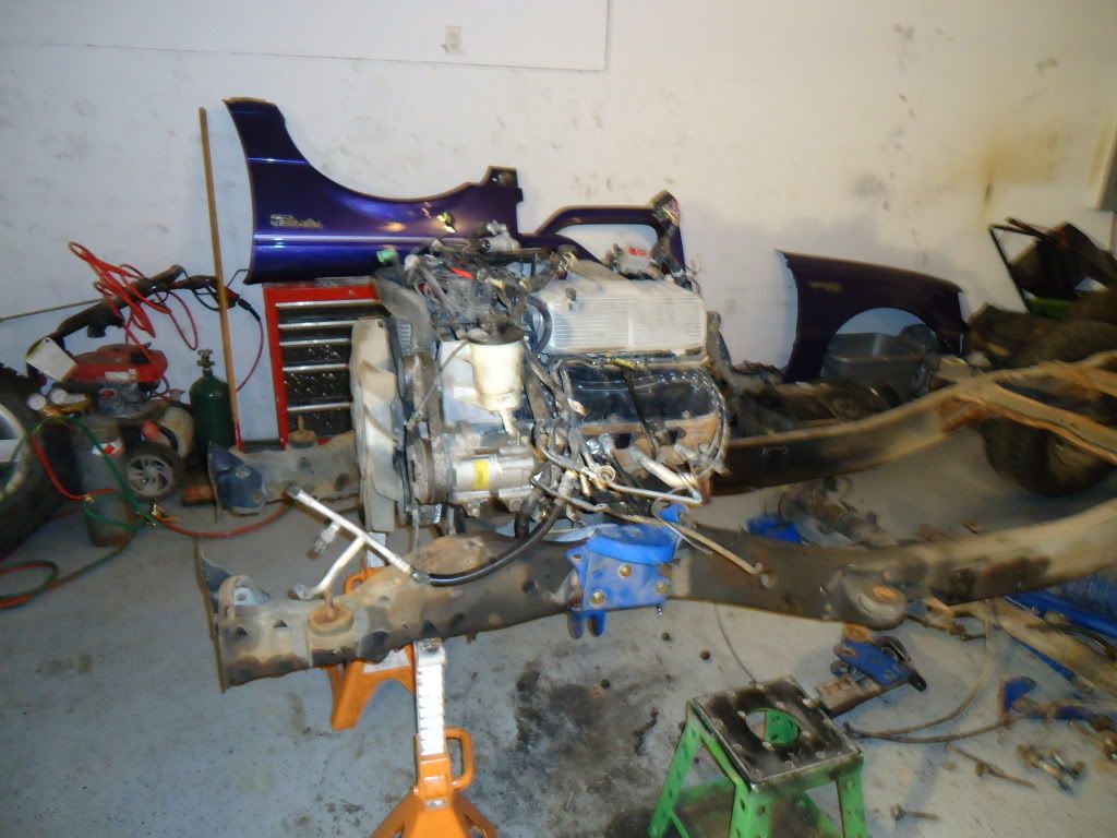

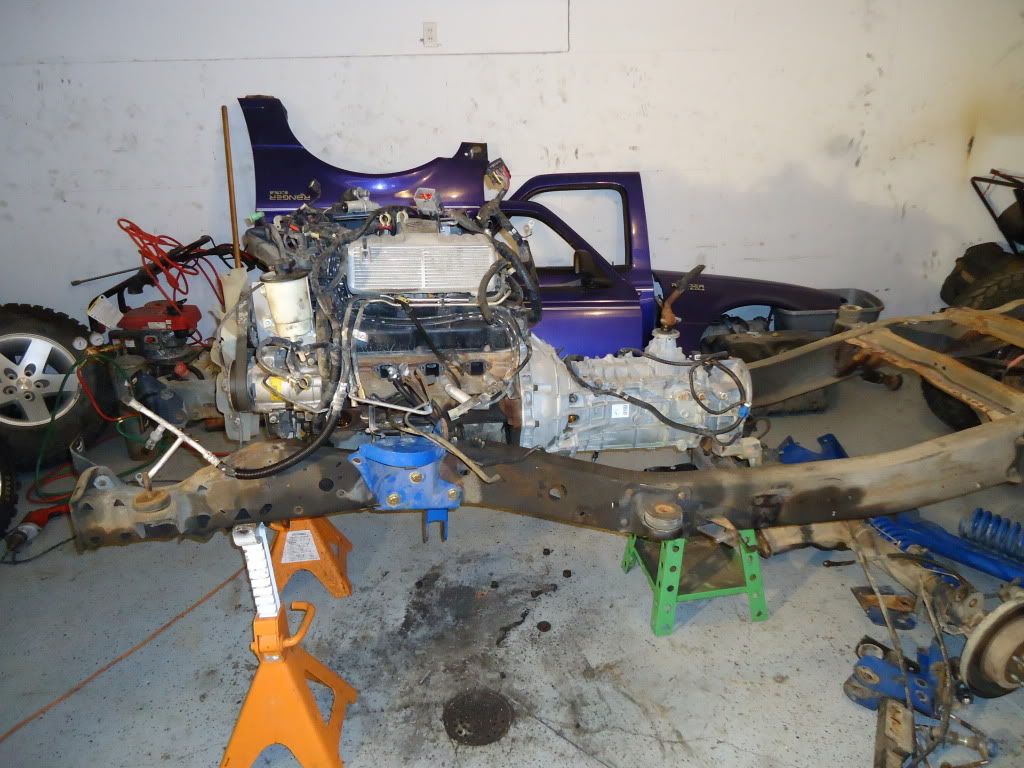

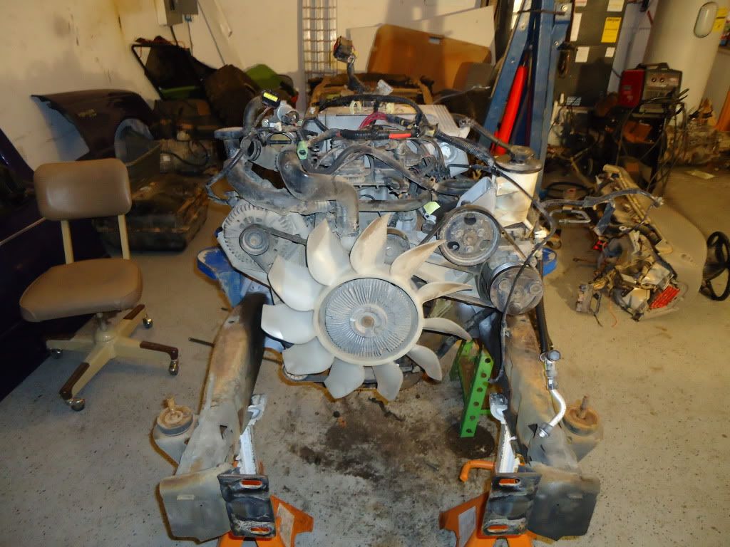

Engine crossmember bolted and welded in, engine mounted, and tranny mounted, today hopefully get headers, exhuast, t-case, tranny mount all done. Maybe TTB under but I dont have all stuff i need yet for that, Goal is to put cab back on next weekend, will see???

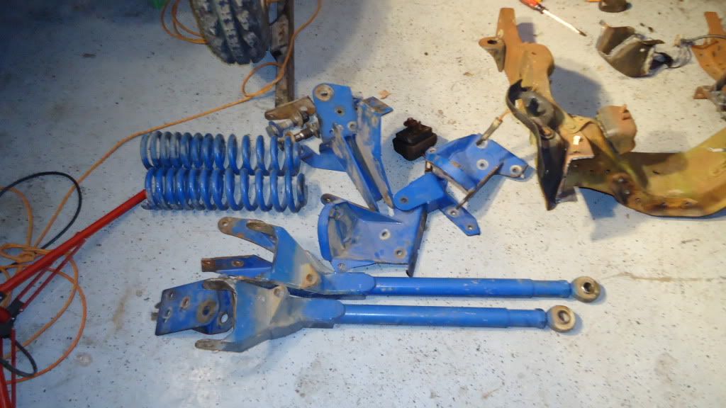

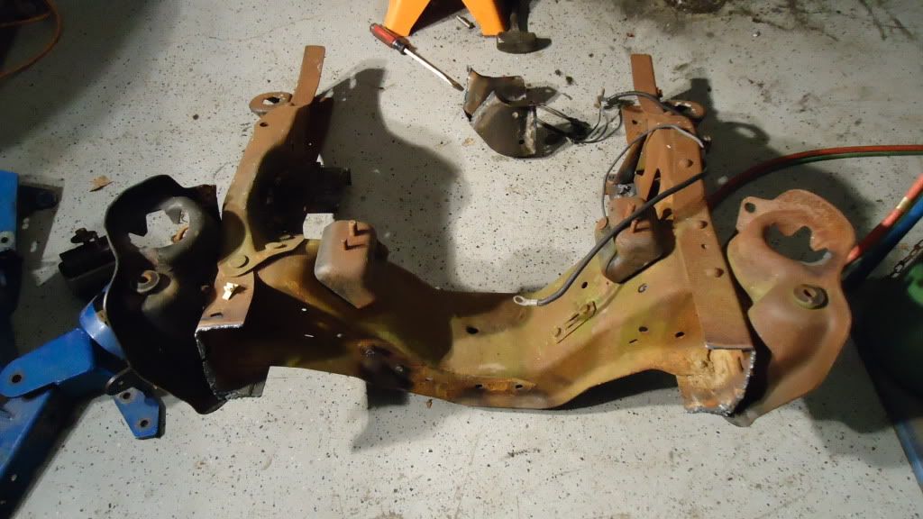

I'd reccommend plating in the drop brackets, coil buckets and radius arms. Anything offroad will brake/fail at one point
The drop brackets aren't so much the problem.. Its the cross member they attach to. I'd personally do a cut and turn TTB setup. You will love the extra ground clearance and the steering will be half way decent in stock configuration. Plus, setting up cross over steering will be a breeze later on..
If you aren't sure on how to do a cut and turn TTB pm me. It will take you 2 hours tops since your front end is already off.
Yes that true.. I think dave @threat is having a sale on them and radius arms like 750-800 for them?
Yeah he is or was.. I believe the thread starter should be able to handle the task. It kind of sucks that he's all the in MO. I couldn't imagine shipping core beams..
yea guys I do want to do cut and turned beams, but for now I had this stuff, I will wait and do that when ready to go TTB dana 44 and make the whole thing wider :)
