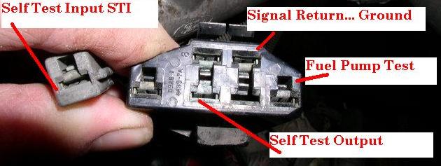

That plug is different than the self test plug I've used under the hood of other Ford's (expecting to see whats in the picture I attached) :icon_confused: If it is the underdash one for the 95, then I don't know which connectors to jump :dunno:

Should be under the hood on the right hand fender towards the firewall.

The 95's have both DLC. The one under the dash is a OBD II but it only works to diagnose the ABS. The powertrain is OBD I and is under the hood . Don't ask me why it's like that, I don't know. Just is.
