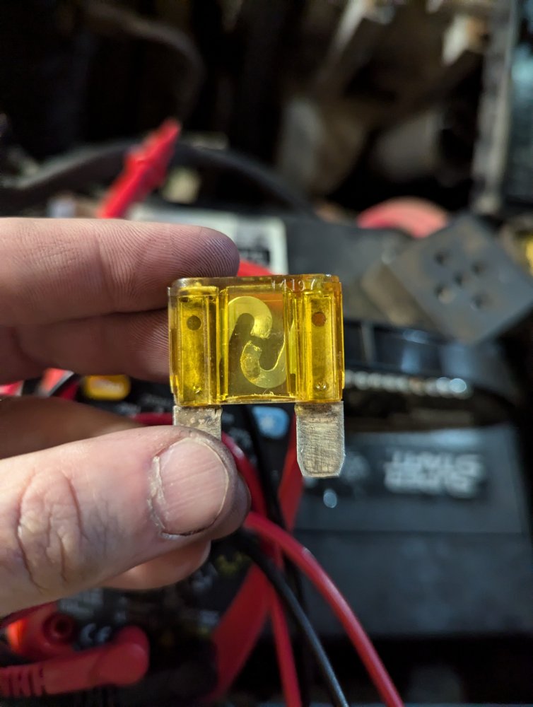

529/566: Spot on with the fuse being the problem. Not sure what would cause it to blow maybe something grounded out when i was lifting the engine? Replaced the 20A fuse at the engine fuse block.
additionally, i checked the 3 wire connector at the transmission and it looked good. If i get this code again, i will perform the power check Ron advises above.
Pulled the negative battery cable for a minute to reset the CEL. Started it up and it's still rough, the belt tensioner still jumping all over. Need to pull the codes again and see what's still showing up. At least the new 20A fuse for the transmission didn't pop again.
Getting the exact same codes again after letting them reset. I wonder if i could have messed up a ground when i lifted the engine for the mounts? These codes feel nonsensical to me and prior experience leads me to believe that something else might be the actual cause.

follow the trans wiring completely. from trans to all of the chassis and eec interfaces.
the blown fuse can be indicative of a crushing short. unforntunately...on the shared power side this can cause pcm damage as well. the severity or ability to operate can be negligible enough to live with or stop the show.
