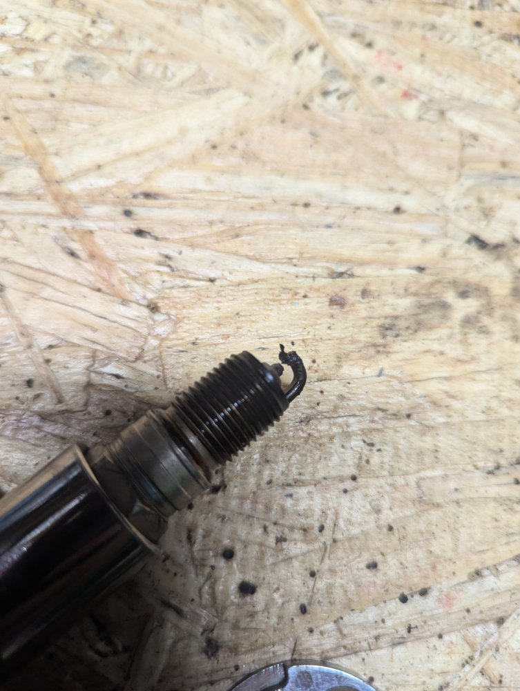

The person who i got the truck from replaced the plugs and wires before i got it. They should have less than 1k miles on them. I pulled one and saw it was an Autolite platinum after some research, I figured i would replace them all with Autolite double platinum.
Looking for some help reading the plugs.
Cylinder 3 plug:

To my untrained eye, 4,5,6 look ok (ok enough).
Cylinder 6 was probably intermittently misfiring from the buildup on it. Cylinders 1 & 2 look oily and kind of fouled. not as bad as 6 though.
