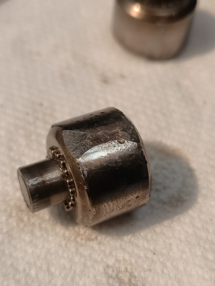

I'll start where I left off. I found my 2 missing lifter rollers still in the lifter holes, sitting on my camshaft. I pulled them out with a magnet, inspected them, and found that luckily no needle bearings were missing. However, one of the lifters had obvious damage sustained from heavy impact.

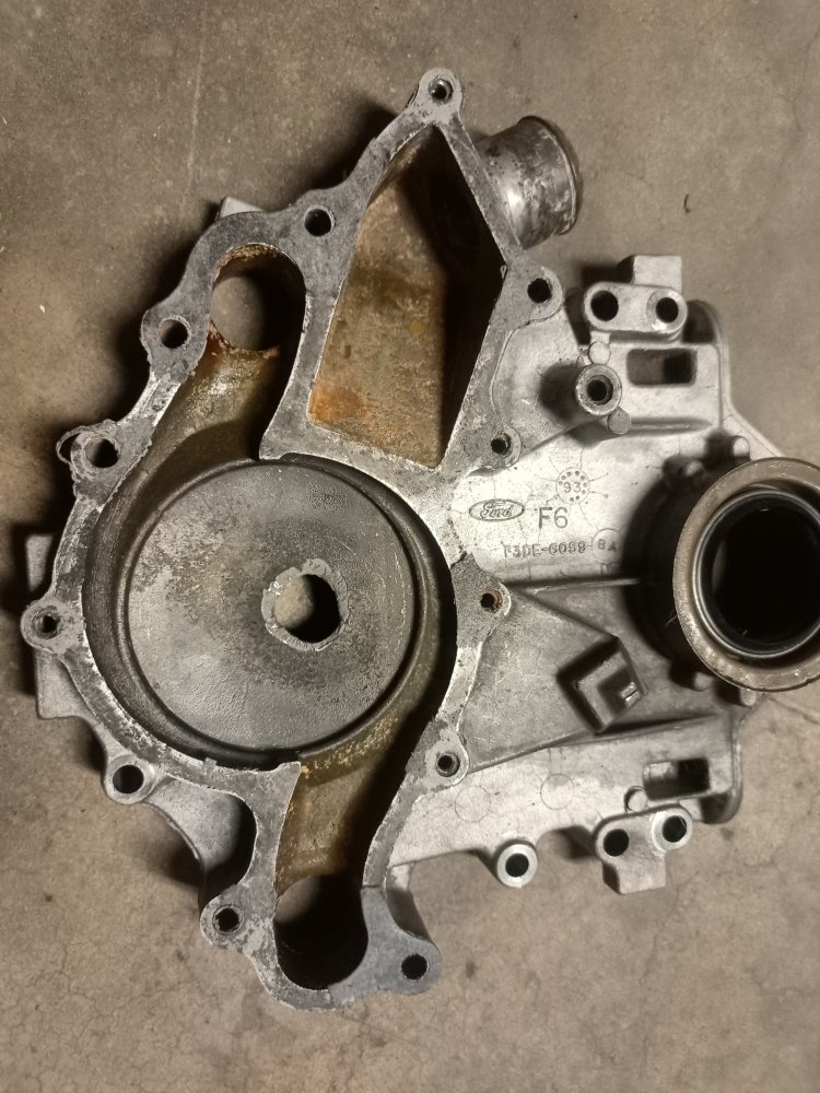

I originally wrote this post after pulling my heads and seeing the lifter damage, but it was not until I pulled the front engine cover off to clean metal shavings that I saw the actual root cause of all my problems.
When I pulled my front engine cover, I saw my camshaft bolt was completely backed out, threads and bolt head slightly damaged, just sitting on my timing chain. When I installed my camshaft bolt the movement of my timing chain sprockets did not allow me to fully torque down the bolt. I don't specifically remember torqueing the camshaft bolt down any special way the first time around. My best guess is that while working late at night (one of many, many late nights) I might have taken a break after setting the timing chain + sprockets in place and forgot to fully torque it down when I resumed working again.
The rotation of the camshaft caused my camshaft bolt to back out and ram a ~1-inch hole straight through my front engine cover into my water pump. So the mixing of the Oil/Coolant was from the hole in the timing cover and the camshaft/lifter damage was caused by the camshaft being completely loose in place.

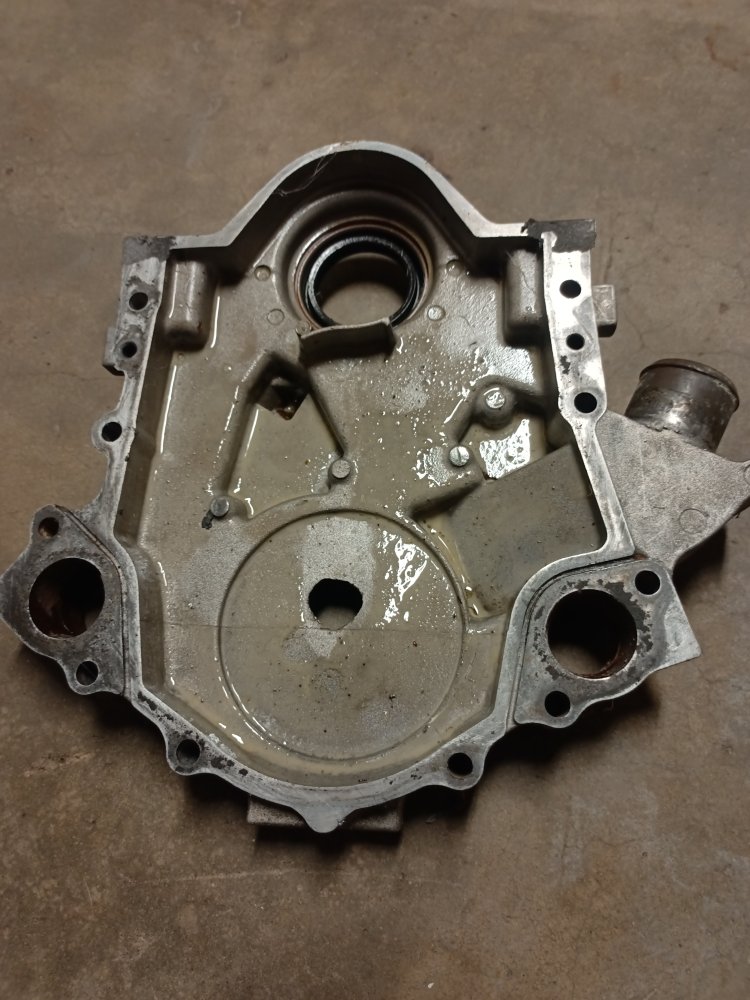

I was looking at 250$ for a new camshaft and 275$ for a new front engine cover. I decided 500$+ was worth a full day at the junkyard so I got to work on the only junkyard car with my engine, a 1994 3.0 Aerostar half an hour from my house.
I was able to pull the rockers, pushrods, lifters, lifter guides, front engine cover, and camshaft for a total of 128$!

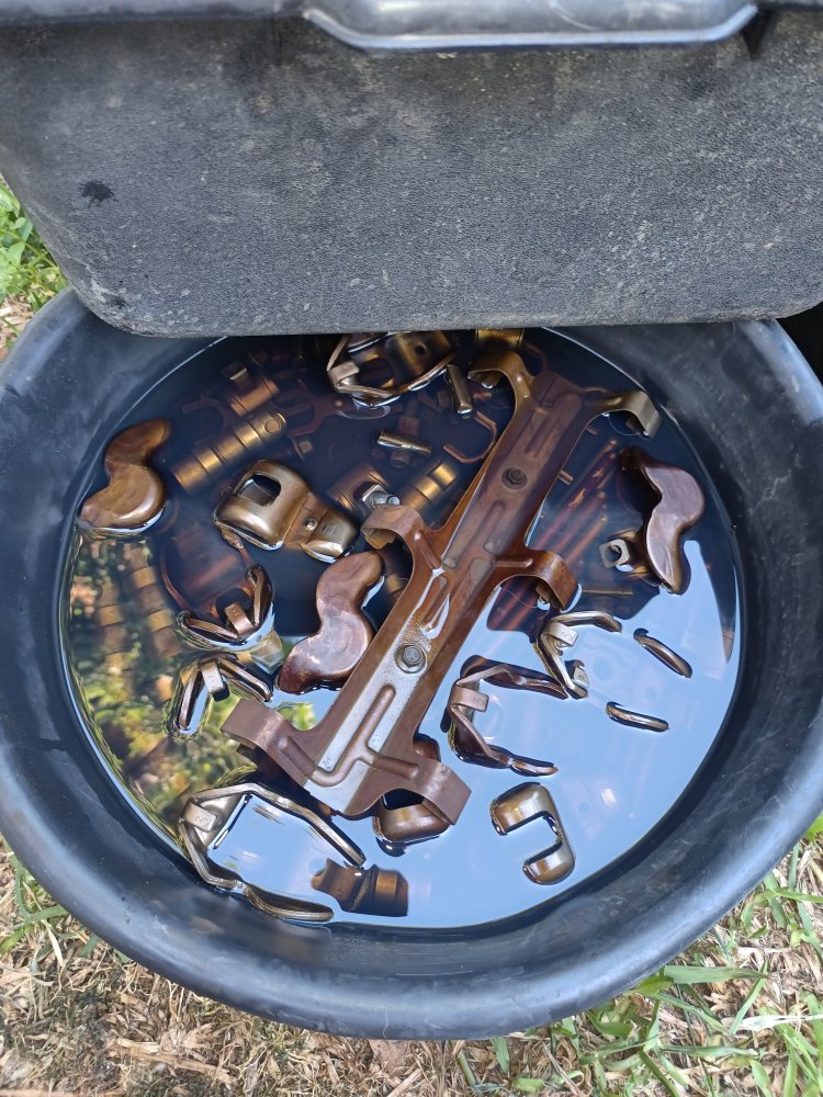

Soaked them all in gasoline for 2 days (sloshed it around here and there), then each part was inspected for damage (everything looked pretty pristine) and individually cleaned with gas + a vibrating toothbrush, then soaked in 5W-20 motor oil overnight.

I got about 10 metal chunks and a bunch of tiny shavings out and pieced them back onto my lifters to see how much I was missing. There were evidently 6 chunks still missing in my block somewhere after the intense cleaning, that is the best I could do. I was only able to clear my camshaft travel area (which is somewhat enclosed with oil journals throughout) with some level of certainty as I could easily look around, reach with magnets, and wash it out thoroughly. As a last-ditch effort, I bought a super-strong neodymium magnetic drain plug on amazon for 25$ to recover the missing metal in my block. I also was able to recover the piece of my front engine cover that broke off from the water jackets in my block. I used a straw and vacuum to pull up all the non-magnetic chunks of timing chain cover out of the block and felt very confident that I recovered everything.

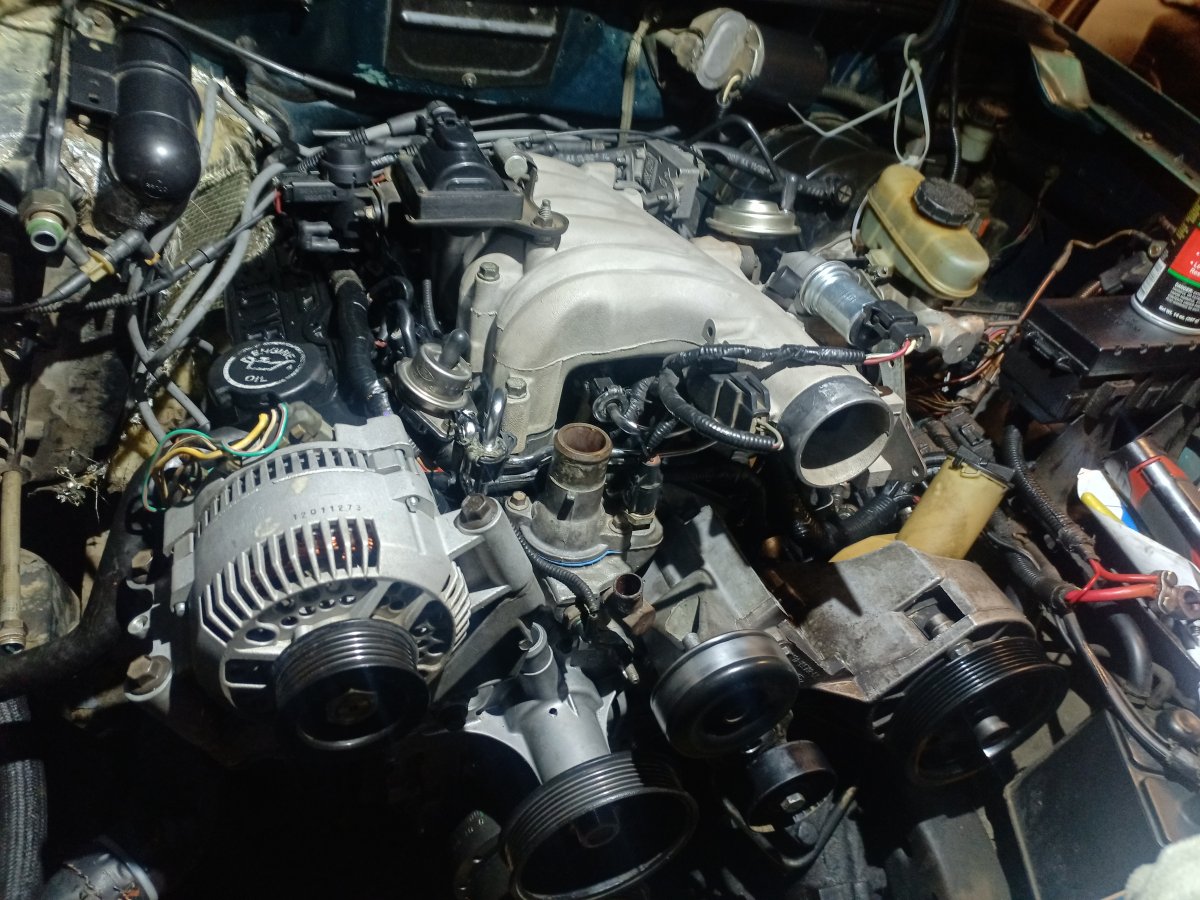

After figuring out that the improperly torqued camshaft bolt was the real cause of the lifter damage and was satisfied with my somewhat lackluster cleaning job, I felt confident to start reassembling my engine.
I bought new head gaskets, head bolts, intake gaskets, valley seals, timing chain cover gasket, and water pump gasket.
I put red Loctite on my camshaft bolt after thoroughly cleaning the threads and bolt hole with brake cleaner, then torqued the new camshaft bolt down to 30ft/lb. The rest of the job went pretty smoothly.
I filled her up with 90% water 10% coolant and some cheap oil, and started her up. I perfected the timing, added coolant over the course of an hour, then took her on a couple of trips up and down my street. Everything sounded great!

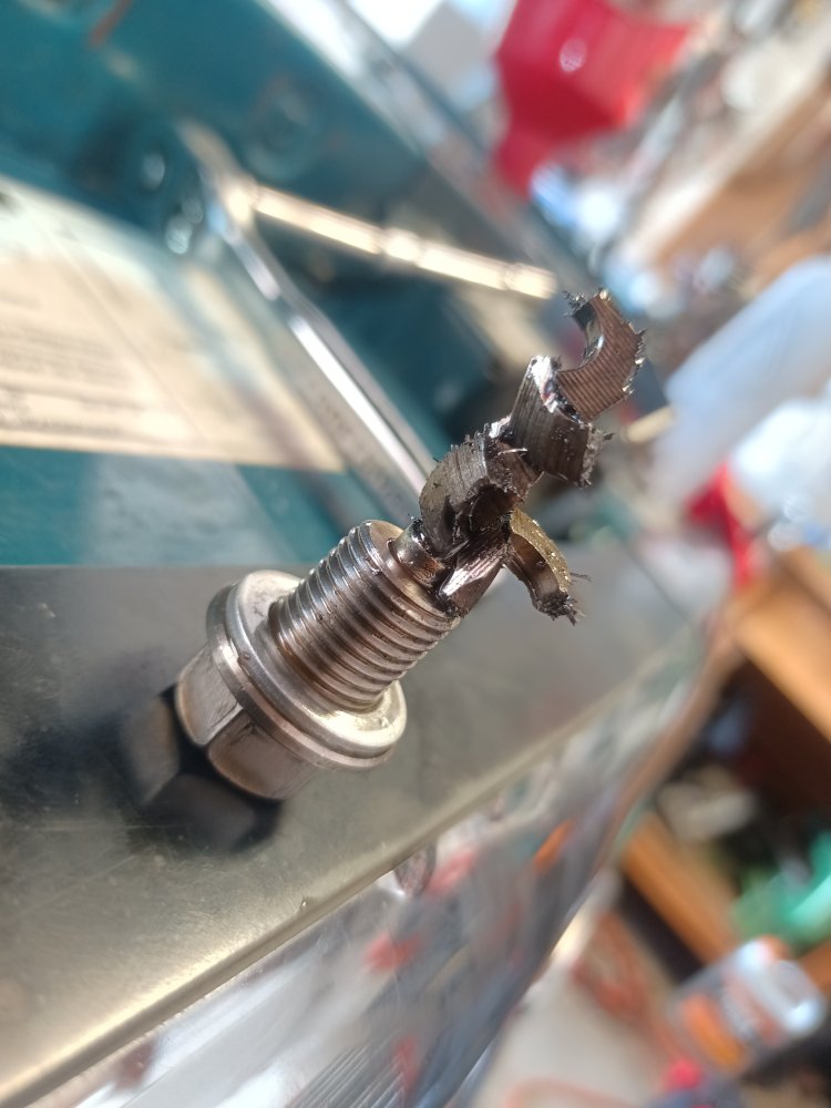

EXACTLY 6 CHUNKS OF METAL STUCK TO MY NEODYMIUM DRAIN PLUG along with a bunch of metal shavings.

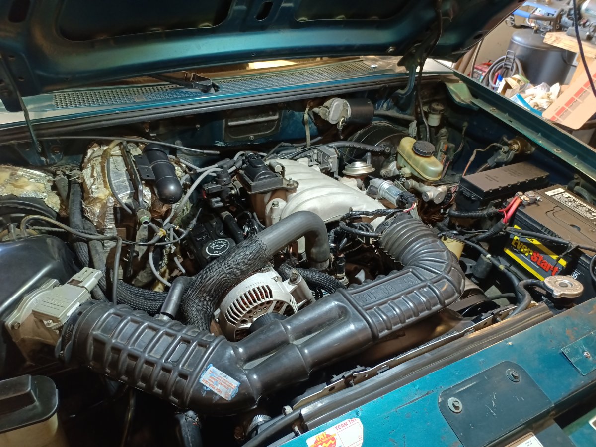

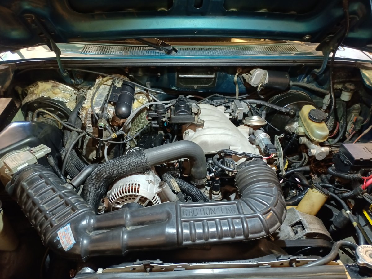

Filled her up with some Mobil 1 high mileage 5w20, 75/25 coolant/water. and called it a done job. After 22 days straight of working in the garage, my truck is finally running again and 200+ miles post-rebuild. No dripping on my driveway and she's running stronger than ever.
She lives again!

The aluminum front engine cover is not magnetic, that's true. However, if you look at the impact hole on my timing cover, it's obvious that the impact of the cam bolt pushed the entire chunk into the water pump (based on the shear marks on the timing cover) which then got shredded by my water pump blades. I thought I would end up finding these aluminum chunks in my radiator but they actually were in the water jackets of my block.

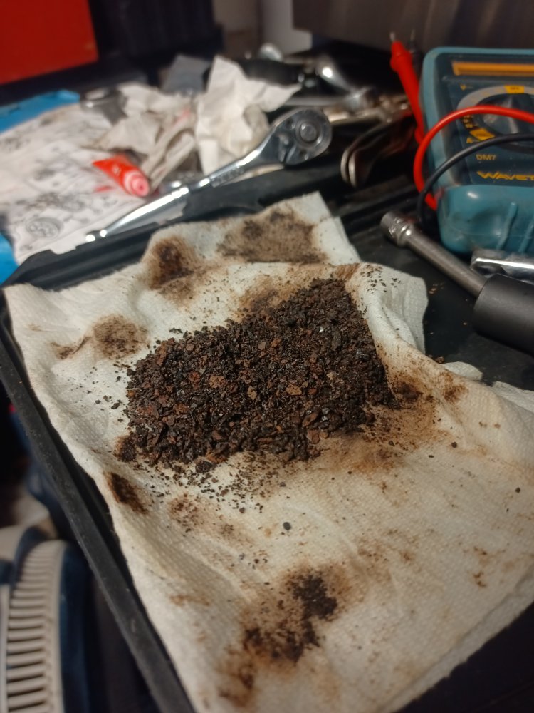

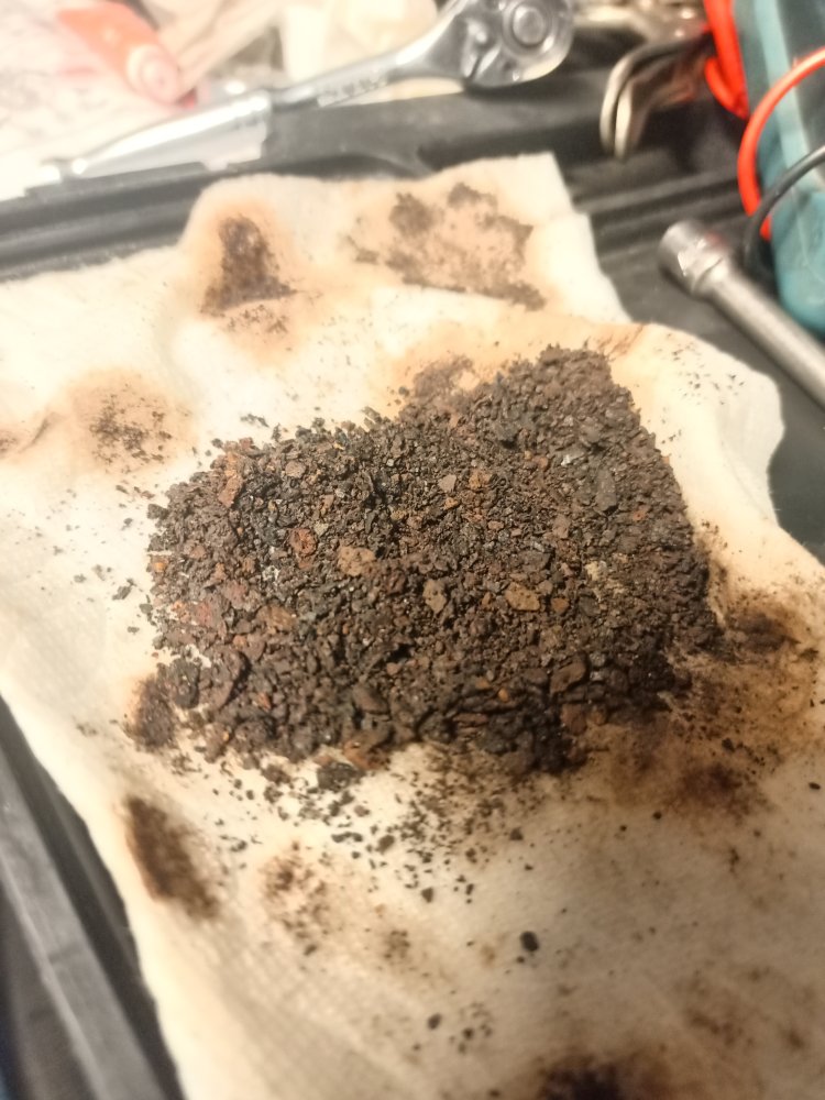

At first, I recovered these medium-sized fragments with a stick magnet with heavy grease at the end to adhere to the chunks. I then found a way to clean the inside of my engine block REALLY WELL. I found a long, double-wide drinking straw and taped it onto a shop-vac nozzel and started hearing chunks fly into the vaccuum. I not only recovered 100% of the aluminum fragments, but I also cleaned the hell out of my block water jackets. After ~30 minutes of vacuuming, I also ended up collecting all this semi-metalic sediment from my block!
I was very surprised at this amount of build-up in my block, already having done 2 coolant flushes this year and having used that red-devil coolant flush product. I guess flushing the coolant doesn't actually clear out much of the build-up in your system.
I finished the job off by doing 3 more coolant flushes after a 60-mile drive. The first flush had a super thin layer of oily build-up, filled her up with 90% water, and drove another 10 miles. The next flush looked pretty goddam clean, but I decided one more flush would get it perfect. The last flush looked like clean clear water, so I filled her up with ~75% coolant and 25% water and called it finished.
