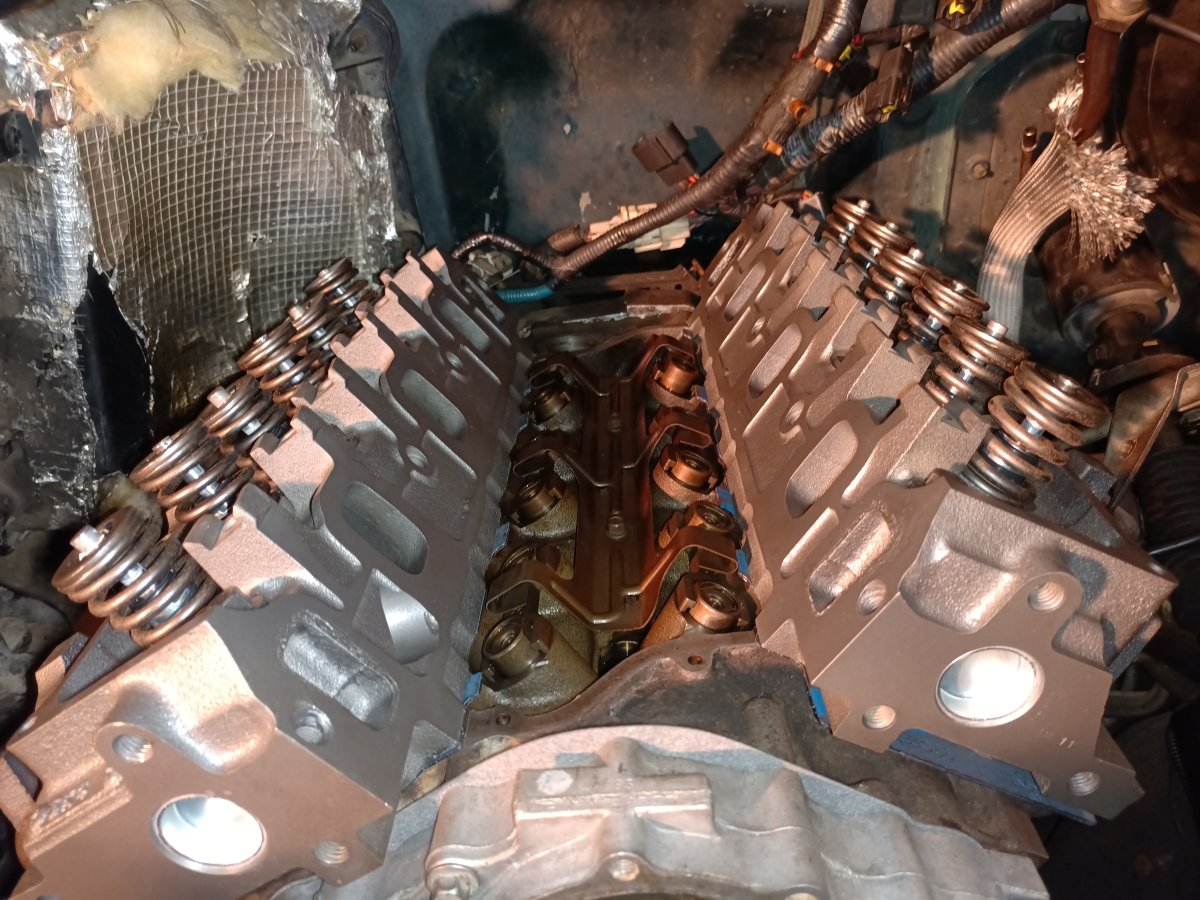

Last week I started working on my 94' 3.0 Ranger, I wanted to replace everything included in the head gasket set and replace anything along the way that wanted replacing. I brought my heads to a reputable machine shop (had one small crack on intake) and a few days later my heads were back on. This was my first head gasket job, however I did have an experienced mechanic working with me.
I used a torque wrench and carefully tightened my heads to these specs in this order:
1st: 59ft/lb
2: Loosen all bolts one turn
3: 35ft/lb
4: 66ft/lb
View attachment 75047 View attachment 75049
All rocker arm bolts were tightened to 8ft/lb, then to 24ft/lb. I needed to rotate the crankshaft in order to tighten the rocker arms as per instructed. I never touched my lifters or loosened any lifter guides.

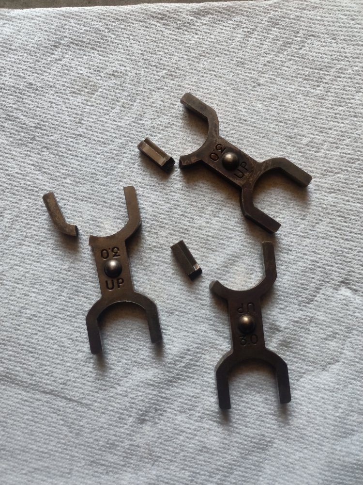

Upon pulling my lower intake I found that my lifter guides (aka tappet guides) on cylinders 456 were all broken.

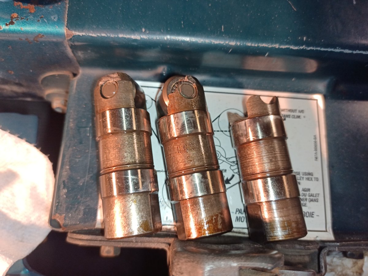

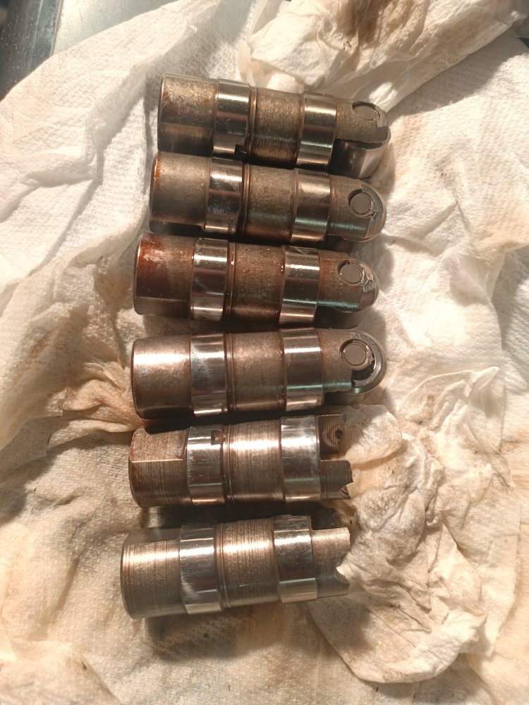

I pulled the keeper plate to find that the lifters on 456 were severely damaged. The lifters on cylinders 123 were barely damaged, possibly from the metal debris flying off the lifters from cylinders 456.
Below is a picture of my lifters from cylinders 456.
View attachment 75050View attachment 75060
