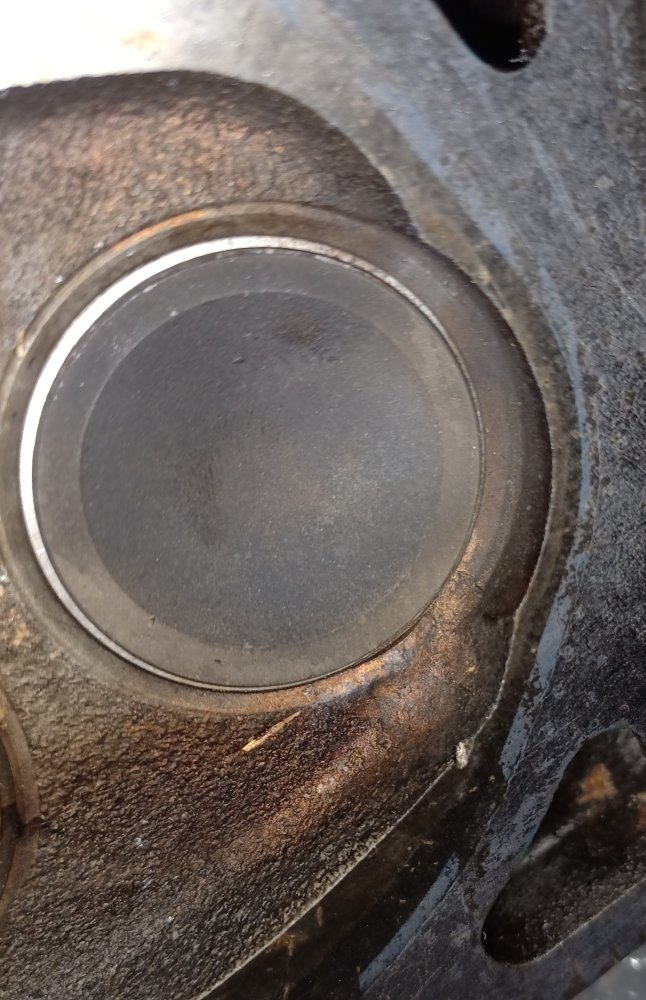

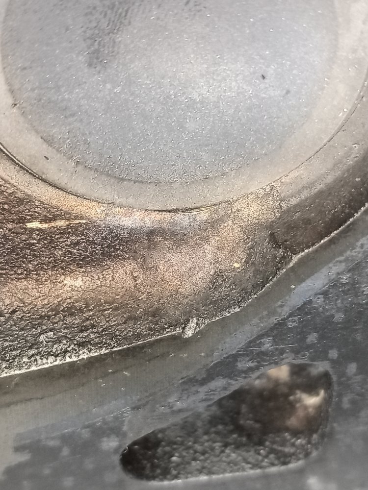

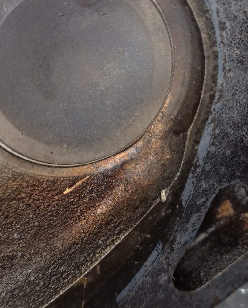

The crack in my head was about 3/4in long but it was mostly on my valve seat, it carried over like a 1/4in into my head.

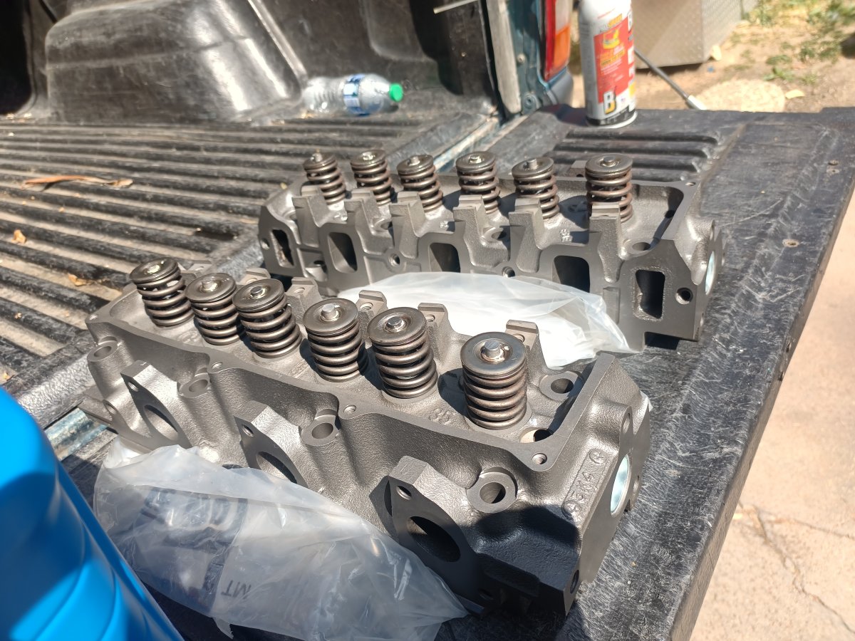

I brought my heads to the most reputable machine shop around and they did a great job. Cleaned inside and out like brand new, replaced all valve seats, did a good job welding the crack, resurfaced everything, rethreaded an exhaust manifold bolt hole that was stripped out, and painted it all for 392$.
When I had the oil and coolant mix and lifter damage, I brought my heads in and they checked its surfaces for warpage and did a compression check for free, wouldn't accept my money.
75150
you need to replace that head
What makes you say that? Nobody else mentioned my head needs replacing including the machine shop that verified my head is not warped and it holds compression perfectly.
I showed up half an hour before they closed and they ran those tests in front of me, I saw the straight edge test and watched the compression gauge while they tested the valves. Looked perfect.
Here is the crack they welded, I trust this machine shop. They have been in the business for over 25 years and everyone I asked told me they were the best around.
75165
75164

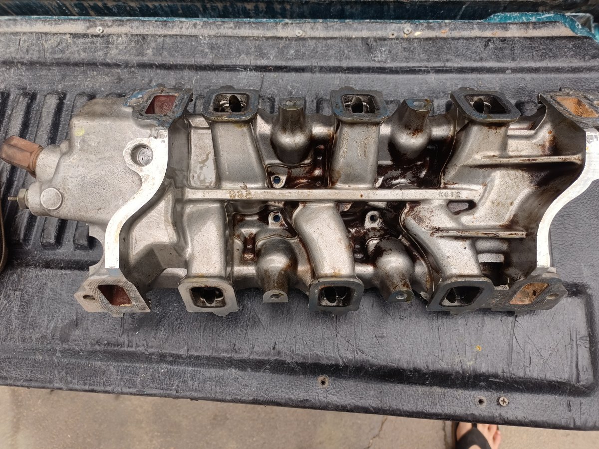

Lower intake manifold has coolant flowing thru it, if its gasket fails then coolant can go into the valley and oil pan
And it could "wash" the lifters of oil causing overheating and failure
Although I have never heard or even read about that type of failure of the lifters, the leak yes, but not that type of failure

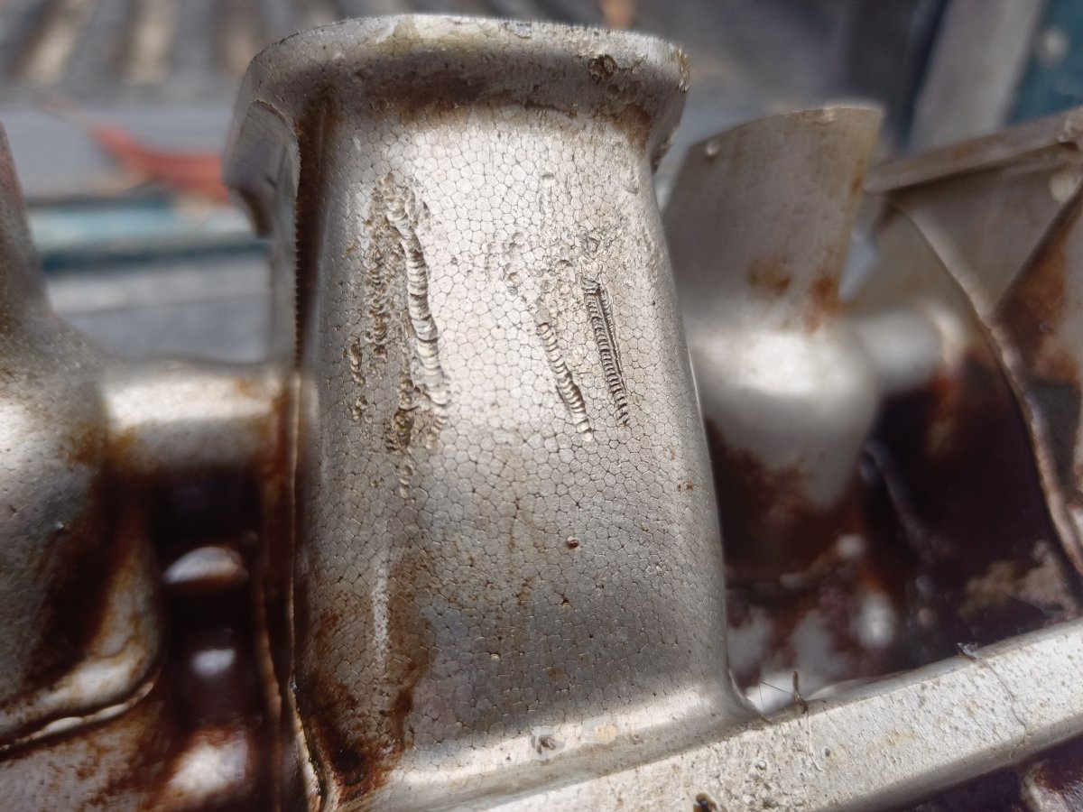

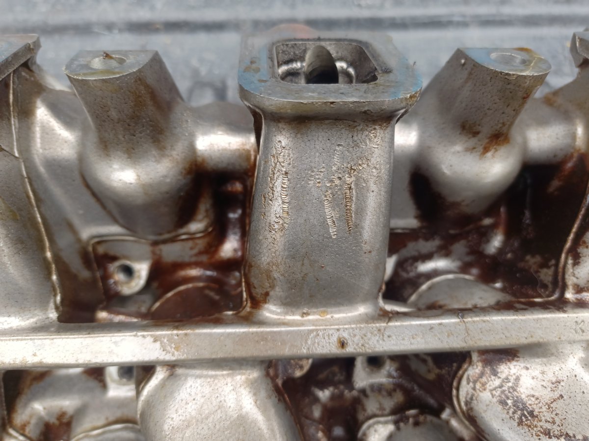

Check lower intake for cracks as well, on the under side
I inspected the bottom of my lower intake today, no cracks or major damage but it does look like the intake on valve #5 took a couple of hits. My lower intake still appears to be functional, this damage does not warrant a replacement, correct?

Was looking for cracks, or signs, in lower intake that could leak coolant into the valley(into the oil) so at the 4 corners where coolant flows thru lower intake from head to head
Because its an aluminum intake bolted to cast iron heads, it means the aluminum will get eaten away if the coolant PH drops too low, call Galvanic corrosion
So look at the 4 corners where coolant is present to see if there is any pitting or signs of corrosion
View attachment 75165View attachment 75164
They welded the top of the crack, I expect there is a crack on the lower side., as cheap as you can pick up those heads, I would have never had one welded, JMO
