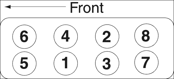

I used a torque wrench and carefully tightened my heads to these specs in this order:
1st: 59ft/lb
2: Loosen all bolts one turn
3: 35ft/lb
4: 66ft/lb

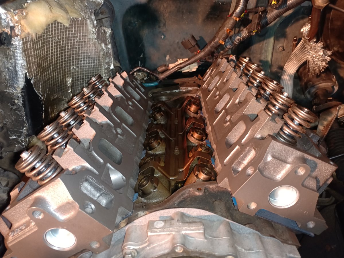

I pulled my heads and lower intake back off again, got my heads checked for compression and warpage, thankfully those were undamaged. All head bolts took the same amount of torque to break them free, none were notably loose. I also noted that the head gasket for cylinders 123 left about half of the gasket on my block upon removal while the head gasket for cylinder 456 only left about 10% of its material stuck to the block. Besides that there were no obvious failure points or major differences between the left and right head gaskets.

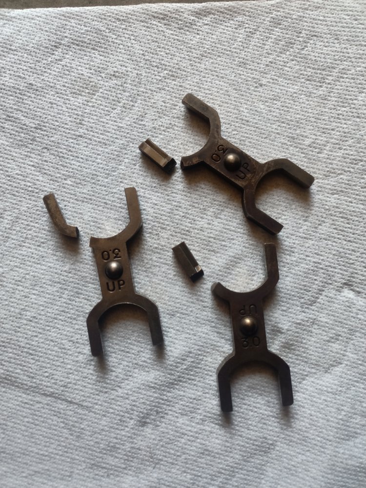

Upon pulling my lower intake I found that my lifter guides (aka tappet guides) on cylinders 456 were all broken.
75048

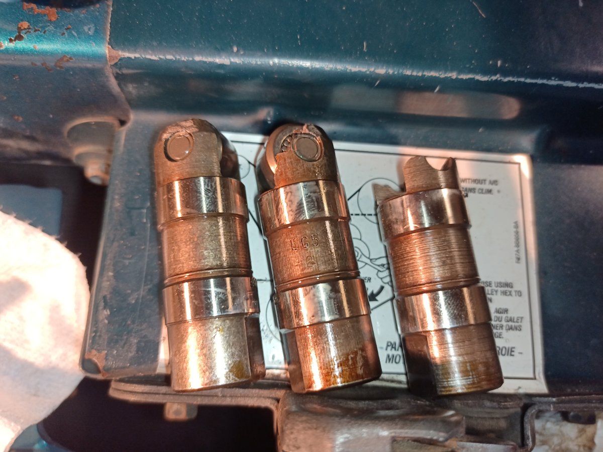

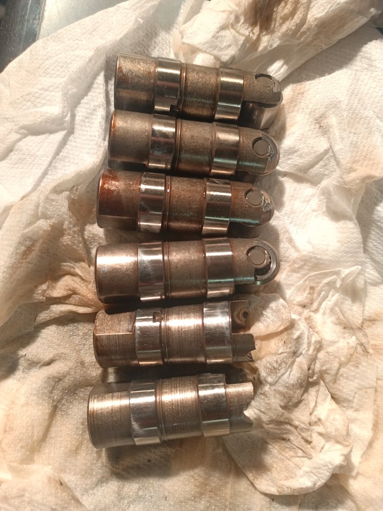

I pulled the keeper plate to find that the lifters on 456 were severely damaged. The lifters on cylinders 123 were barely damaged, possibly from the metal debris flying off the lifters from cylinders 456.
Below is a picture of my lifters from cylinders 456.

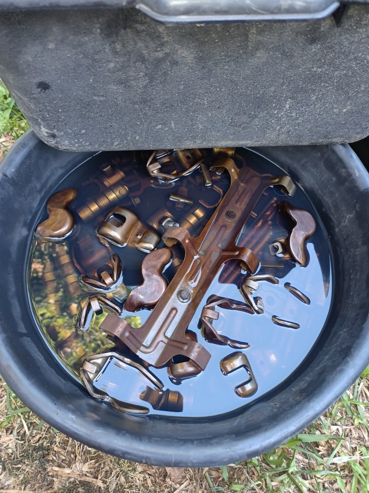

I was able to find a 1994 3.0 Ford Aerostar at a local junkyard and after a couple hours of work, I was able to pull all of the rockers, pushrods, lifters, and guides out and bought them all for 63$. Soaked them in gasoline overnight.
75051
So now it's time to put it all back together (after I pull the oil pan AGAIN to remove the debris) but I do not know what to do differently because I don't know what caused my problem in the first place.
From the last few days of research and asking mechanics, I'm beginning to be convinced that what caused this failure is a case of hydro lock due to either head gasket failure or lower intake gasket failure on cylinders 456. Coolant gets sucked into cylinders, water doesn't like to compress, and so either my engine must stop or a mechanical failure must occur.
However, I refuse to reassemble my engine again the same way I did before and expect a different result, even though I meticulously followed all directions and torque specs (I work as a service writer at an auto shop, I was able to print out detailed cylinder head removal instructions for my vehicle).
Can anyone here think of a single other possibility that could cause the damage I am seeing? Remember, it idled perfectly in my garage for over 30 minutes without sucking up coolant or mixing the oil with coolant. It has damage that is almost entirely isolated to one head and the problem did not occur until after it was driven.
I am NOT trying to go for take #3 on this job, if anyone has any advice or an idea about what might have caused my issue and how to prevent it from happening again, I'd really appreciate it.

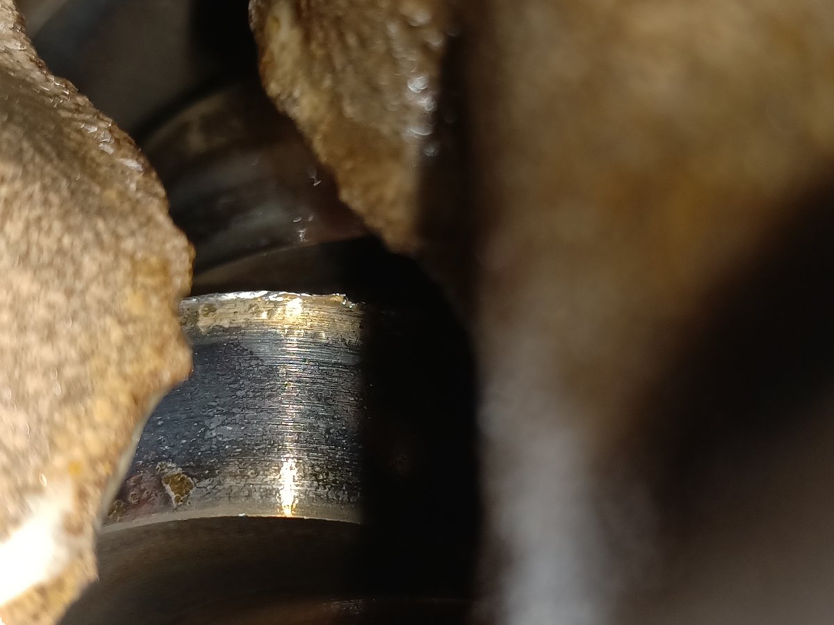

I watched every lobe on my camshaft for 1-2 full rotations and I now know the totality of the damage the camshaft sustained. There were two lobes that sustained minor damage on their sides/edges as shown below.
75091
75092
It does not appear that the rollers on the lifters would ever make contact with the edges of the lobes on my camshaft. Is this damage negligible or am I looking at a new camshaft?

Roller contact area looks sketchy to me. I have build a few 5.0 engines that have same lifter, dogbone, and spider set-up and would not reuse a cam that looked like that. Since you have to get new lifters, I would recommend a new cam as well. Not required for roller lifters, just to be safe. Broken dogbone retainers look like maybe they were not locking in flush on flats on sides of lifters. Just a thought, not a sermon.
View attachment 75091View attachment 75092
Yeah, that what I was referring to..small flakes of material separating from the lobe, they have to go somewhere & that usually is the pan & then sucked up into the pump & then on to the filter where one can hope that's as far as they go (but don't bet on it). also seeing some corrosion/pitting in there as well. Has this engine been sitting unused for some time? Seeing as you're in Cali I would not have suspected moisture corrosion.
