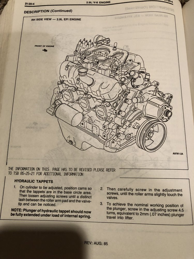

where did this info come from? like what manual/book is this?? i have the haynes manual but it doesn’t have this type of info in such detail. would really like to get this manual!
I'm guessing that's a manufacturer's shop manual. In print form you could most likely find on ebay for a couple hundred bucks. There are probably digital versions available as well.
If you want it, we can work something out.

Stamina,
Make sure this aquaintence understands the difference between a valve lash adjustment (required on solid lifters) and hydraulic lifter preload (Hydraulic lifters). Though they both involve the valve train being adjusted and the end result is similar these 2 procedures are 100% opposite.

to turn the motor while it’s in the truck, is it necessary i remove spark plugs to release compression? does anyone know what the size of the crank nut/crankshaft bolt is in the 2.9? also how many turns after zero lash is achieved should i go, i have read things all over the place about the preload, from .5 of a turn to what the shop manual says, 4.5 turns, massive range just would like to know if anyones done it and what they set the preload to. the answer to these questions will set me up for success to complete the j o b
Stamina,
**The Chilton's manual for the 1983-91 Ford 60°v6, 2.9L state to perform the procedure on a cold engine and to move the nut 1½ turns or 2mm past zero lash, while on the base circle.**
