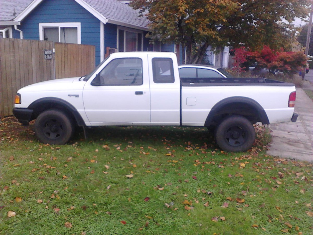

I see most Rangers have the front end lower than the rear. But how much is normal? I have about a 5" difference, front to back. Compared to all the others I see, it seems excessive. I feel like either the front is sagging(twin I beam), or the rear has been lifted... maybe both? I don't see anything that looks modified, or aftermarket, that would account for such a rake. I'm not trying to lift it, but I do want it level, or at least level-ish. Does that seem like more rake than most unmodded 4x4 Rangers?

To answer your question best I can is simply yes, it does look excessively high in the rear(or low in the front)
I can't say why, it could be any number of things, front or rear.
Check your door label and see what the GVWR and such is, and maybe learn from that if it has any factory towing packages.
You looked well at the back, did you also look at the front? Look closely also at the coil spring bolts for signs of removal or replacement.
It doesn't appear to be excessively modified on the outside so I wouldn't expect it to be underneath either.
Check also your front shocks for damage and the rear ones for signs of replacement
Past that I really have no clue
Any chance they used it for carrying a heavy load(large camper top etc)?
If the front is sagging significantly, you will see that when you look at it from the front. The camber will be way off and you will have excessive wear on the inside edges of the front tires. That does look like a lot of height in the back.
I have a 93 reg cab and rhe ass end seems to be the same as yours. I have a topper on mine too. When i first got the truck i removed the remnents of an in bed 5th wheel receiver. Also has a custom front receiver welded in the front wirh a 3/4" pin hole. I suspect my truck was used by a large construction company.
Camber looks right, tire wear is even. Nothing looks like it's been touched, patina is the same everywhere under there. If it's been modified, it would have to have been quite a long time ago. Rear shackles look to be factory too. Is there a common rear leaf spring swap I can investigate? Maybe someone put some other springs in, but not sure how I can confirm or debunk that idea. How many leafs come with a factory leaf spring? Do they have any part numbers to id them with, or some other way to tell if they're factory or not?
