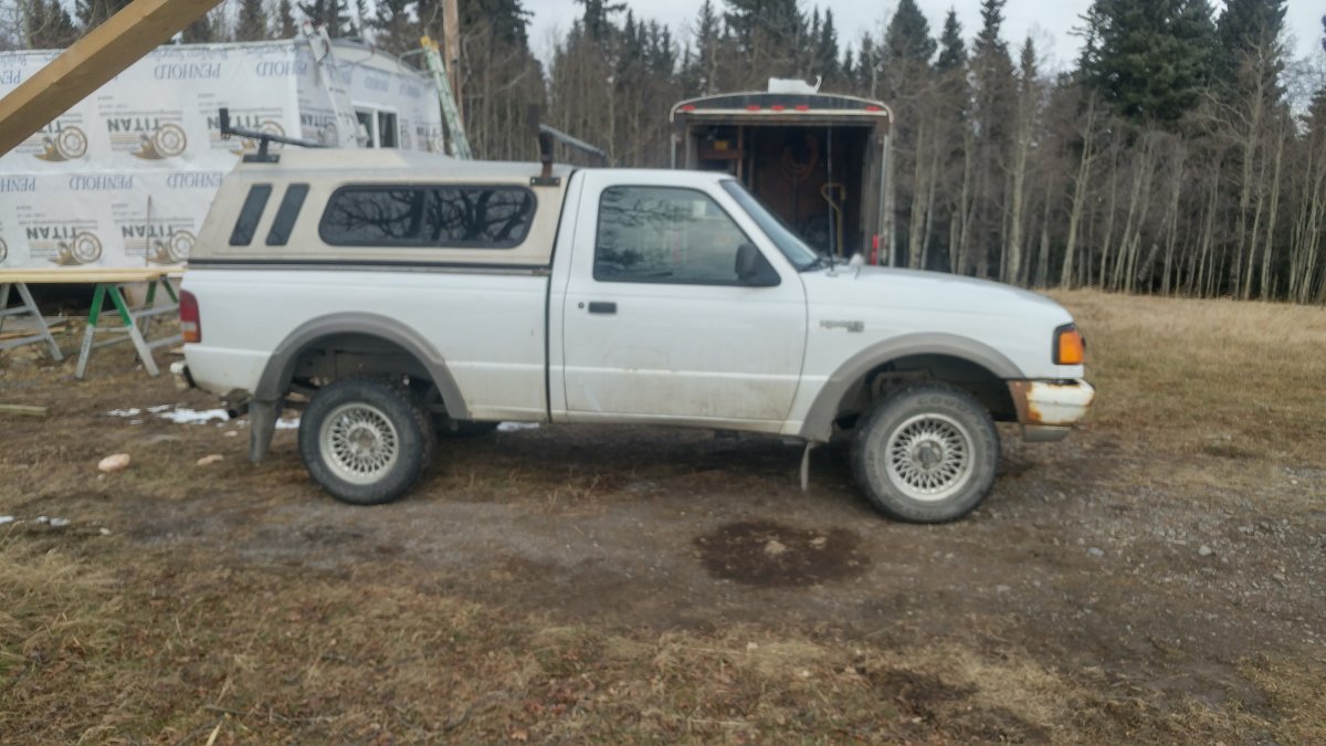

Do you guys think I could still get some 31's under it, without rubbing, if I did set the back height to match the front instead?
The front of yours looks like mine does now with 235s on it. It did look much better with the 265s tho, which I believe were equal to 31s

I've got 235/75/15 on mine and there about 29".
Those don't do much to tell you if they'll rub in hard turns, or other real world issues that vary from car to car. I'm certain that if I'm driving in a smooth straight line, they would fit. Beyond that, I like to defer to people who have actually tried it, or at least are more familiar with a certain car/truck than I am.
As long as the front suspension hasn't sagged to bad 235/75/15 will easily fit without rubbing since that was an optional size tire for that year and being 4WD. As for 31's I cant say for sure but I imagine there would be issues if the stock suspension has sagged at all. Some one installed lift blocks into the rear for sure but camber wear on the tires can be easily cured by buying after market camber adjusters, I personally did this to prevent buying springs for the front for a while and I like the height of my seat as it is, since the factory style have a lock tab the keep them from being turned enough to adjust the camber back in to specs.
I would stay away from 31's unless the front goes up more IMO.

They should be real close. I'm pretty certain it'll clear the 31's, at the front height. I'm not doing much real wheelin', but I will be dealing with a gnarly mountain dirt driveway soon. So I want to get it ready for dailying that everyday.
I would bet good money that you could run 31's on that truck with zero rub. I've owned several 93 to 97 trucks and I always run 31x10.50x15's with zero issue.
I would just embrace what you have... maybe put a fresh set of springs up front and a washer lift to level it up a bit... done... 31's and just drive it.
