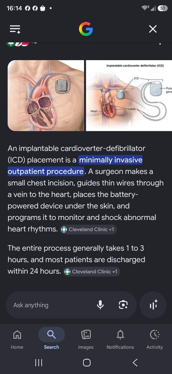

If I can believe AI, which I don't like to do, this is a piece of cake. Might have a driving and lifting restriction for a short period afterward. I'll manipulate the scheduling as best I can.
Pulse generator... kinda sounds like Iron Man's arc reactor?!

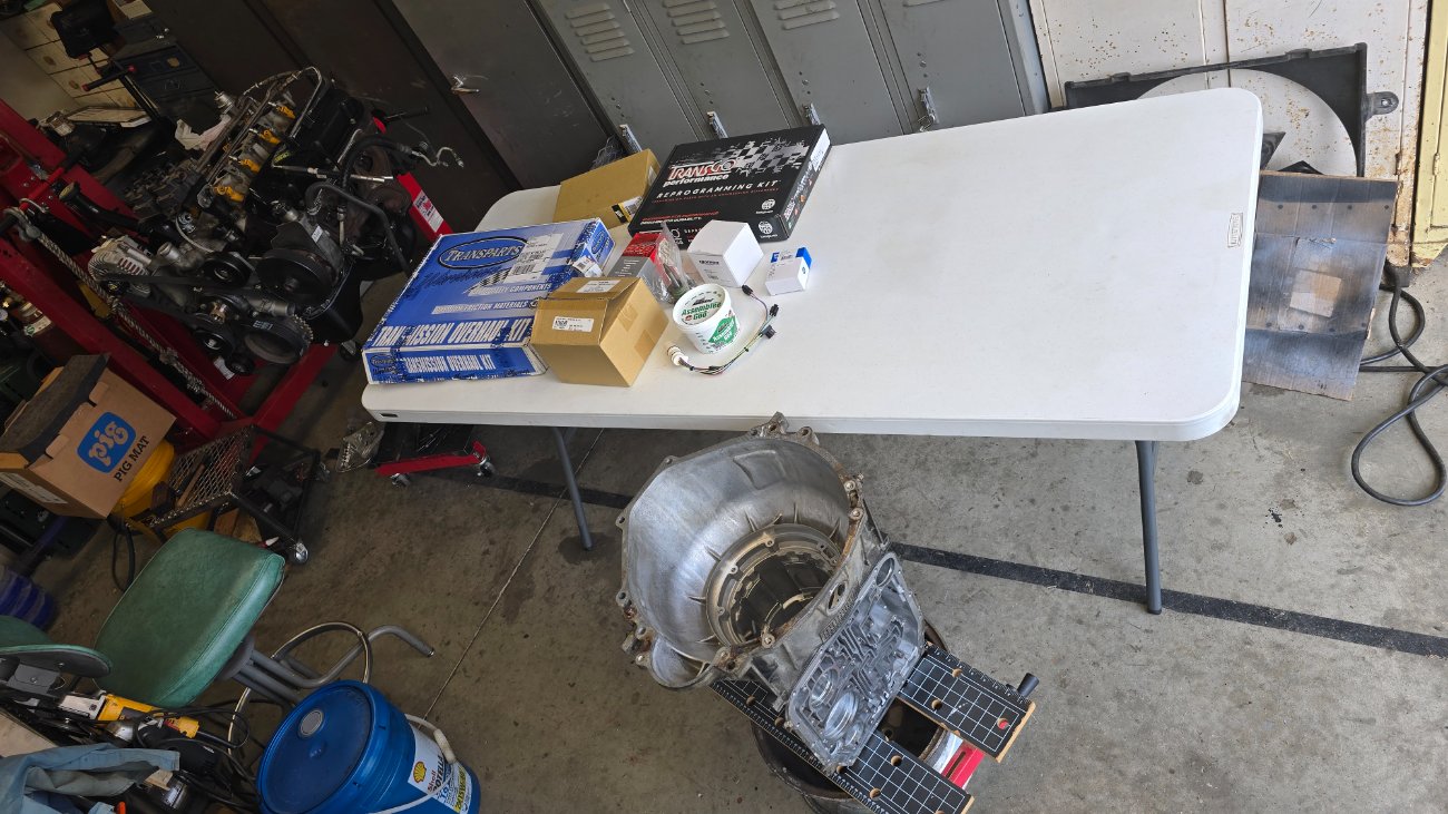

I have been simultaneously threatening to re-assemble the transmission and postponing it. This afternoon, I finally degreased the shell and got my operating room set up and organized for the task. My first time rebuilding an auto and I'm a bit apprehensive about it. Let's hope I get into it tomorrow.
Most of the operating theater. Work bench with clean space to work is behind the camera. All the old parts are on huge baking sheets, laid out in the order of assembly/disassembly. Stuff getting re-used will be cleaned as I go.

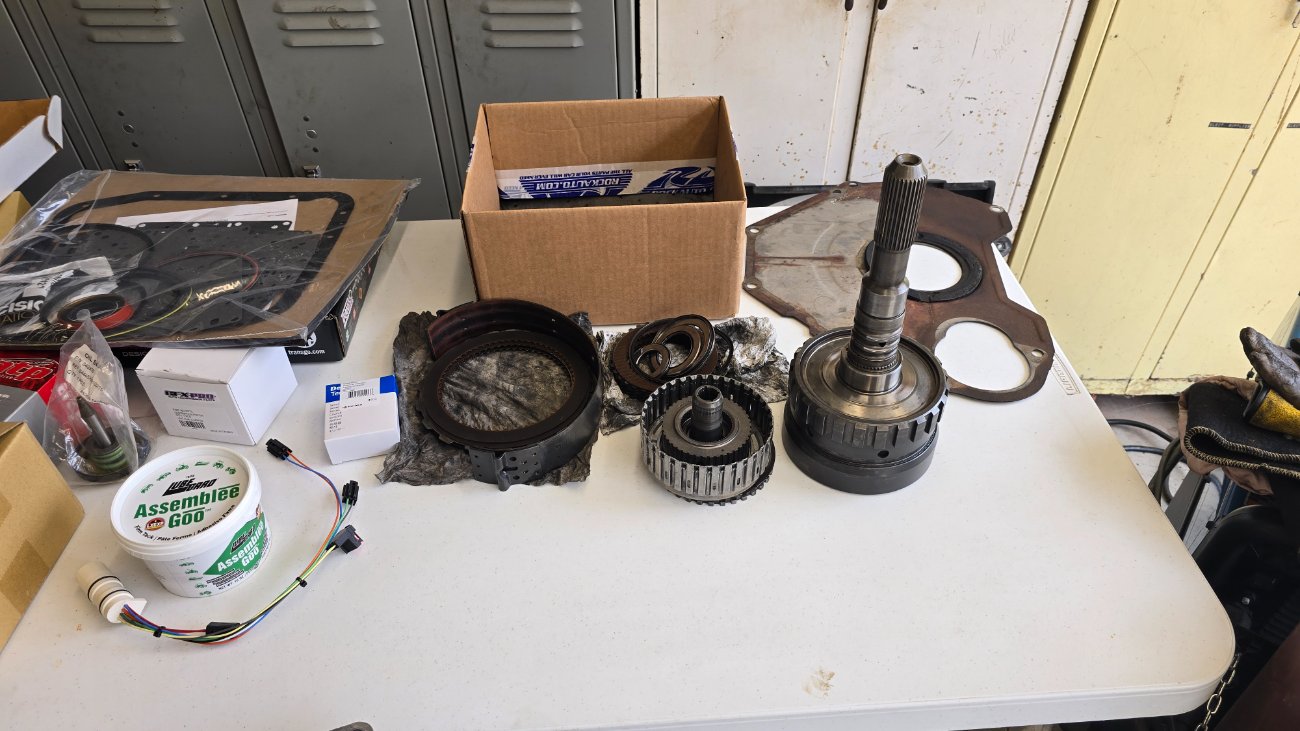

all the new parts except one that I just realized was missed - the pressure control solenoid. It's on order now and will not significantly interrupt this process.

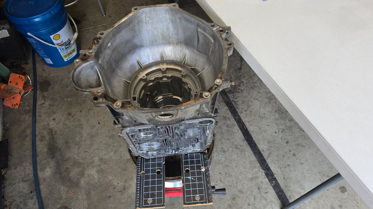

"clean enough" empty shell positioned vertically to make it easy to drop parts and sub-assemblies inside.

Your workmate is missing some stock components :)
I've had 3 of those over the years and really don't like them. But that top part with the clamping screw assembly can be handy. In this case, The tailshaft of the transmission is going to be sticking out. So I needed to hold the shell up high enough to allow for that. Opened up that workmate table and set it on top of one of the Explorer wheels - nice stable work platform with a hole for the shaft to stick through.
Makes sense, I have a couple of them, they have their place, I figured that out with the gap, with the red I thought it was a metal bucket but I see it's a wheel now...

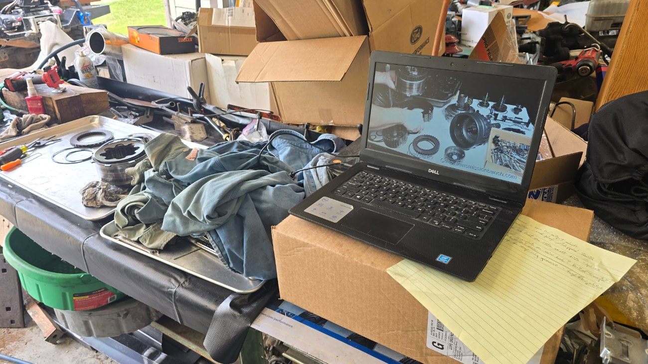

I strongly recommend "Transmission Workbench" on YouTube. If you're just watching their videos for general edycation, they are painfully slow. But, if you want to follow along step by step, they are perfect. Very thorough and detailed, clear instructions, great camera view to see what's going on and, due to the pace, it is easy to reach over and hit pause, when needed. The way other people race through it, you have to hit pause. Then scrub back and forth trying to get back to the point where you wanted to stop or replay. This inspires confidence.
YouTube close by. The blue shirt is keeping dust and debris off the valve body parts.

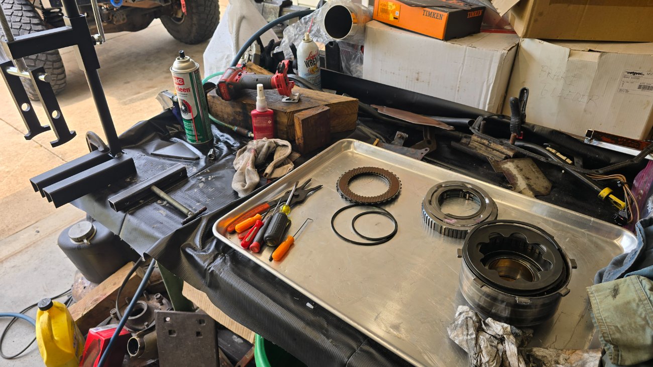

actual work area. Note; to the left side are some special tools that the Ford CEO thinks we are incapable of buying, renting, borrowing, fabricating or even using. One, I bought since it was only $26. The other, I fabricated.
staging area

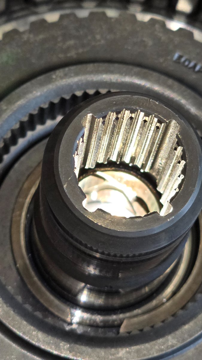

.... we stop. I found what I consider a lot of play in some splines in the direct clutch drum. I think that's what it's called. There is a little stub shaft that mates in there. Shaft looks good. I can see heavy wear on the splines. The drum is on order. Honestly, they could have designed and machuned it with deeper spline engagement.

The damaged splines. Difficult to see, but they are about half worn away.

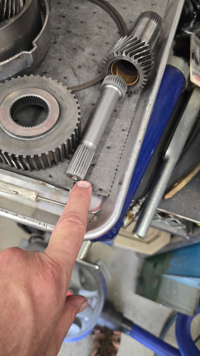

this is the little shaft that fits in there
