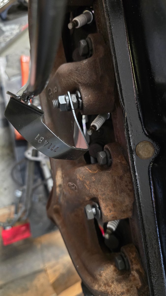

There are downsides for using stainless in tricky situations: it work hardens when you don't want it to and is annoyingly hard to drill, and it's generally softer than grade 5 in bolt situations... oh and if you use stainless nuts on stainless bolts, if you hear a squeak or look at it wrong you now have a galled mess that will no longer be reusable. It has it's place but has a tendency to be annoying when the process should be simple...
