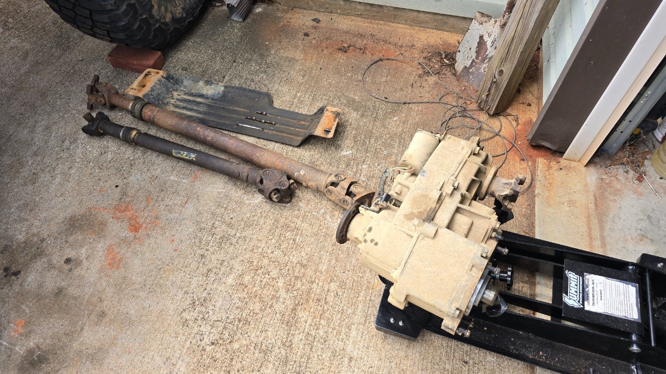

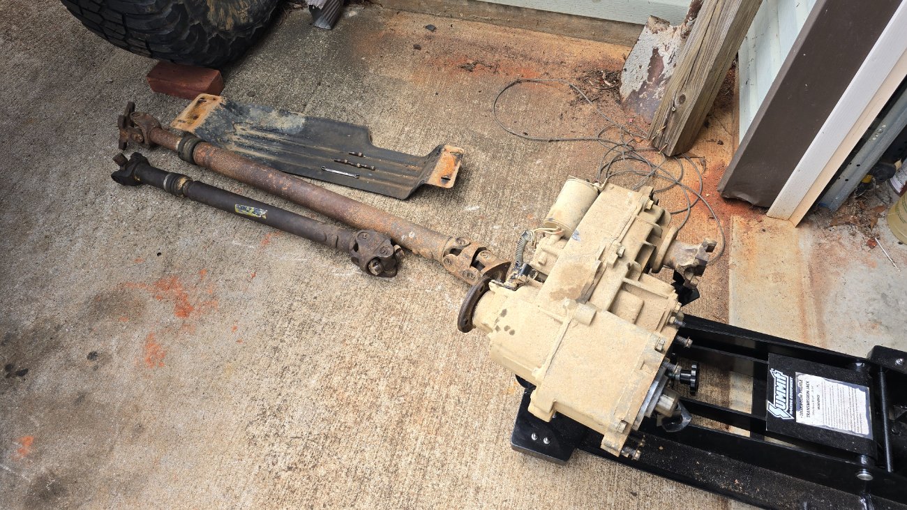

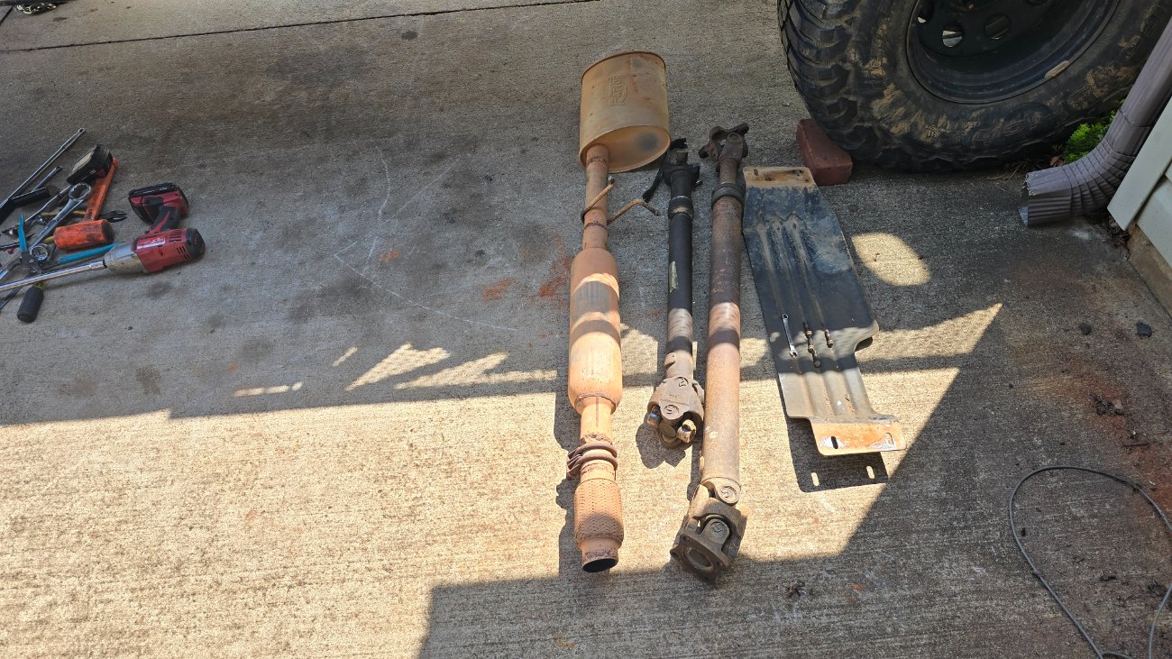

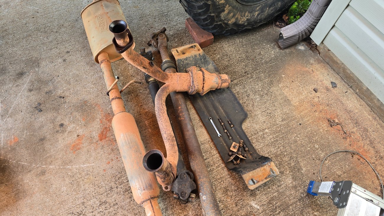

That's all for today. It's 91 degrees with "feels like 97". Skid plate is off, drive shafts are off. T-case is out. Most of the exhaust is cut out. Driver side y-pipe bolts are out and I put more penetrating oil on the passenger side. They don't want to budge.
View attachment 145273View attachment 145274
Not to encourage more heat when it’s already hot out, but heat, and a lot of it, is your friend with stuck y-pipe bolts. It’s not always easy to get heat in there though.
I did discover that pulling fenders and the grill/core support help a lot with access, I’ve started making my core supports a bolt-in deal to get better access for major engine work. Actually been considering @bobbywalter ‘s deal of making the inner fenders removable too. That’s one thing with my F-150 and F-350, you can blow the whole front clip off and you suddenly have all sorts of room to work.

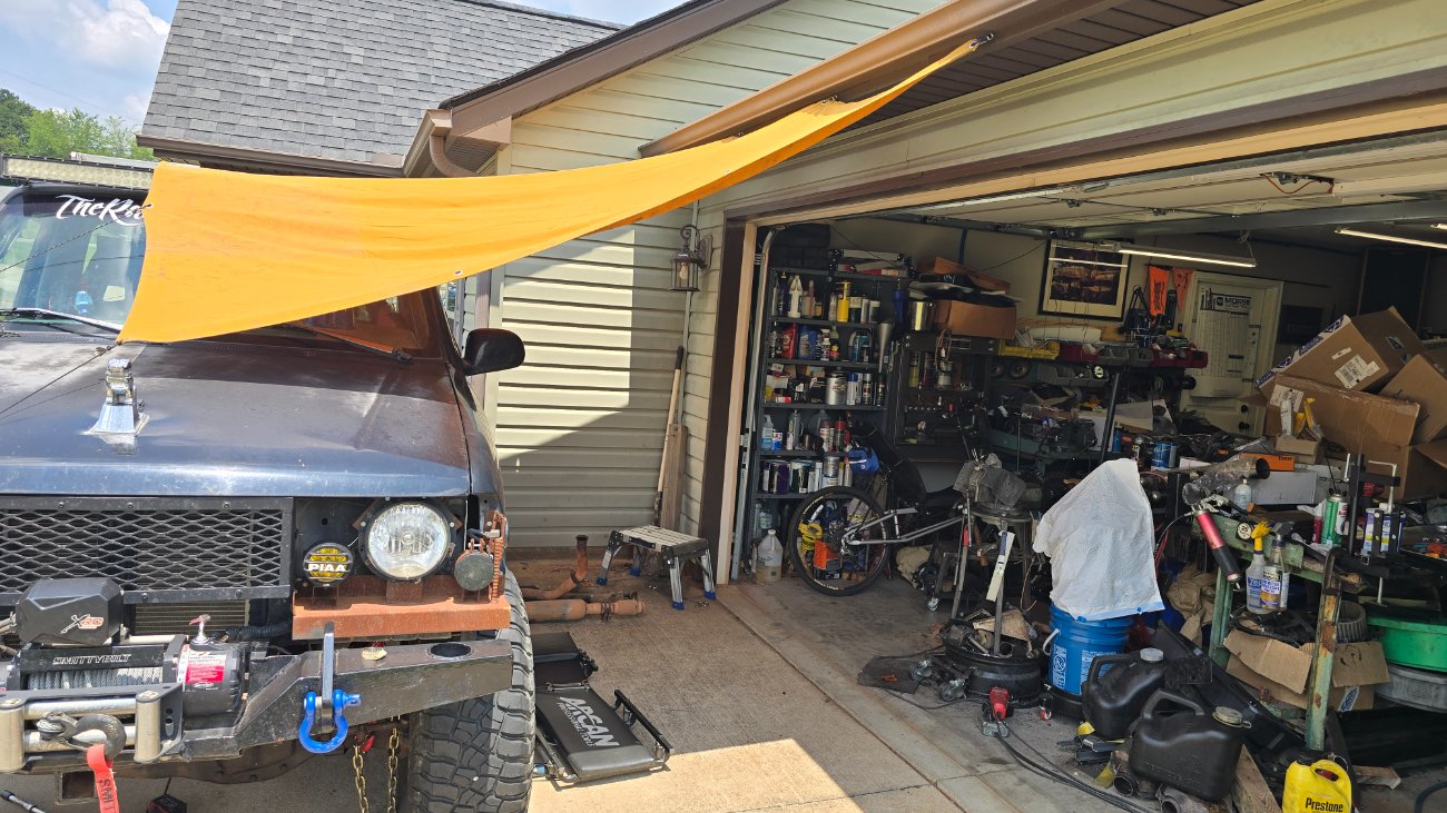

Not sure how much I'll do this afternoon. I mowed the lawn this morning. Then, I hung some shade.

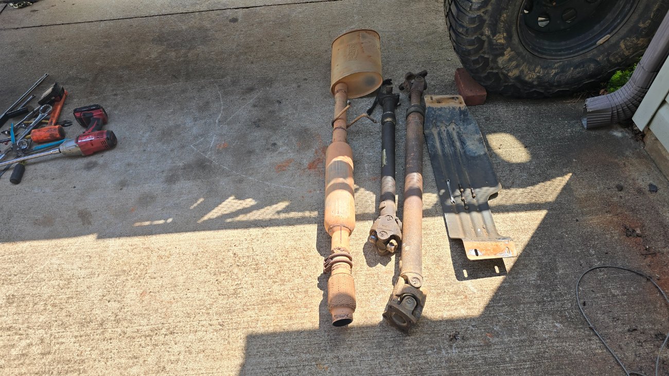

Y-pipe is out without any broken, stripped, cut or melted bolts. Kroil+ patience+Milwaukee with several fresh batteries for the win.
I'm thinking starter motor is next, then cooling fan and radiator. Maybe clear out some underhood wiring. That will make a goid day. Clutch line is disconnected. So, once the starter is off, the transmission is ready.

create some shade. It's still hot and humid. But much better without the direct sun on me.

I don't know if it is on the list and I doubt it will be super easy... but losing the winch bumper will really help you during the operation.
Not a bad idea. I've been internally debating that. I might wait until it's absolutely necessary. Don't want to lose my cupholders/tool holders. ;)
That's it. Doesn't matter how much shade I have. It's currently 90 with feels like 96 and we're supposed to hit 96/101 this afternoon. The starter is out. Cooling fan and radiator are out. I think I lost more sweat than the coolant that dropped when I took the lower radiator hose off. I used to handle this weather a lot better.

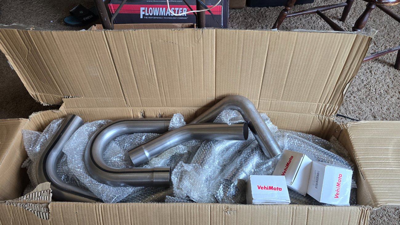

UPS delivered the exhaust pipe pieces.
