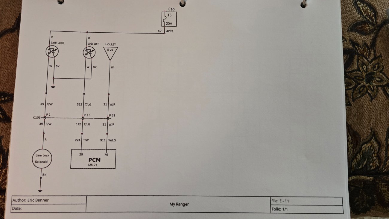

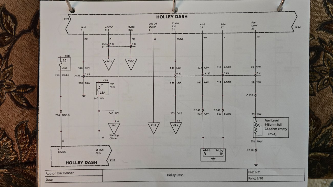

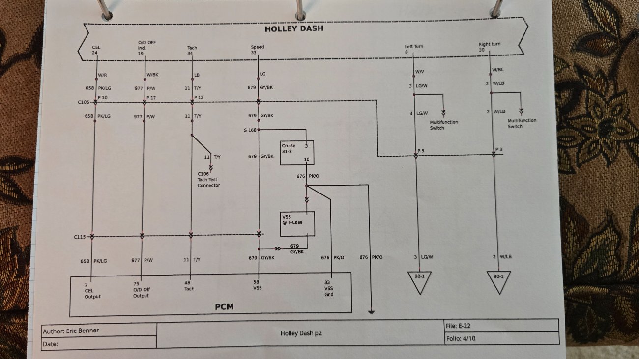

Not much going on. I'm still living at mom's house and helping her recover from hip replacement surgery. I have been working on electrical drawings. I got most of my custom drawings sketched out as far as I can without being there to see the wires and confirm details I misssed. Now, I'm cleaning them up and drawing them in the computer so they're neater and easier to follow. If I wasn't forced into this downtime, the drawings would have had to wait until much later and that makes the wiring harder. Now, I get to go home and wire it up to my design. Hopefully.
