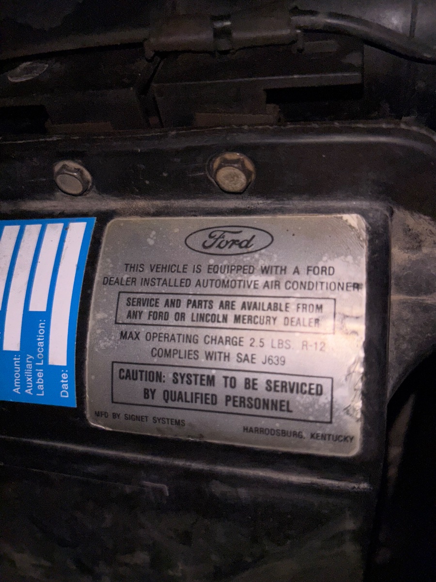

I replaced all the parts on my 93 2.3 l ranger unfortunately the ac system got trashed by my stupidity and I had to buy everything new rather than just flush it I also bought a high side pressure switch which I didn’t have before. Before I attempt this again my sticker says max 2.5 lbs of r12 for a standard 2.3 l which I thought 32oz seems a lot for a small truck? Is that the correct amount of refrigerant I should add? I added 24oz perviously…. Also for the pag 46 how much does the system take it’s just hard because I see everyone online having different answers which confuses me.

Okay, so don't take anything from the R12 system as gospel anymore, including the stock charge. Someone with more R12/conversion experience might be able to list exceptions, but generally you want to be using parts and information from 1994/R134a now.
R134a refrigerant charge is 22oz, per both my sticker and my 1994 manual. Although for such a simple system, I can't say I've ever weighed the charge in. Especially with modern self-sealing cans, you probably can't just leave them sitting there on the scale and expect good flow. IMO it makes more sense to just add until pressures are right, and the air blows cold.
