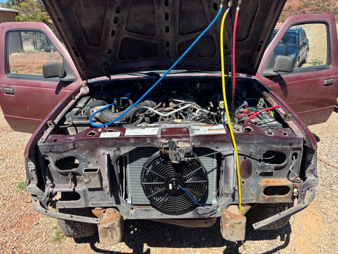

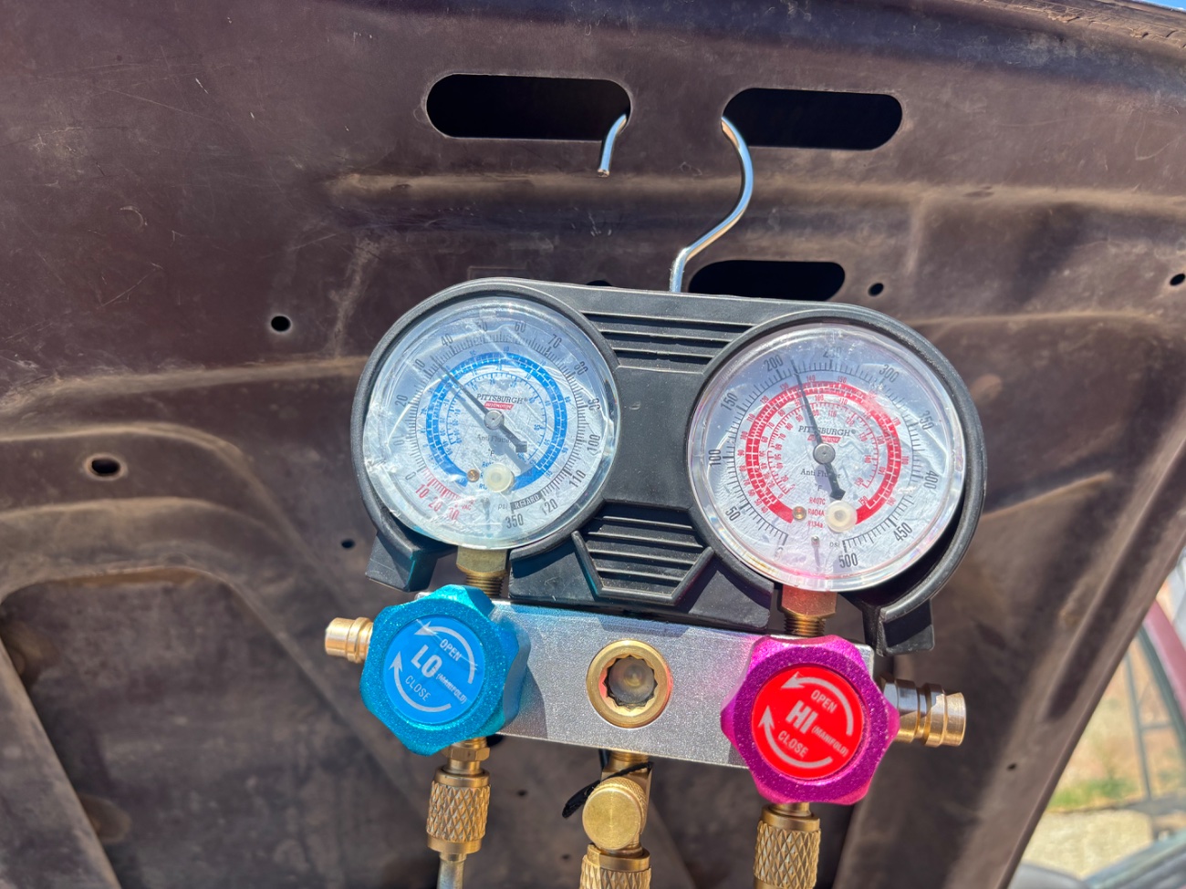

Completed the job at 65 degrees F … low side psi at 30 and high side psi at 170 I’m going to wait till noon tomorrow and see if the pressures stay normal when it heats up
Update so at 80f my low side is at 40psi but high side at 300 at idle after leaving truck on for a hour when I rev the engine the low side drops to 200 should I get a extra fan or will the ac system work fine with that high psi for the high side
Since you replaced the entire system, aren't over on oil, and low-side pressure is good, if the A/C works the whole time and high-side drops to 200 when you spin up the fan, I'd personally make sure I'm not missing anything obvious about my cooling situation and send it.
Since you had A/C stock, I assume you already have condenser seals and a fan shroud with the fan positioned in it properly. You also said you already have an aux fan. If that's in front of the condenser pushing (and it's actually coming on) there's not a ton more you can do.
I actually took the pusher fan off when installing everything but I can install it again if anything I know when I accelerate it it’s drops down to spec … I wonder how the 94s get better heat dissipation than my 93 because I did everything to the T but oh well I’ll just let it ride and see what happens
Hard to say. I had high high-side when my cooling wasn't set up right which resolved after fixing it, but I was mostly checking at cold idle, not right after parking. Temporary spikes then could be acceptable.

The 2.3 runs cool enough that you could have some cooling inefficiency that doesn't bother the engine, but does bother the A/C a bit. Fan clutch going?

I installed a aux fan with a relay for it and it’s working amazing right now that’s for 85 degree weather
I’m sorry 80 degrees
