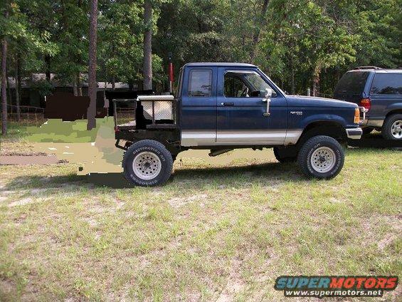

this is roughly my idea.

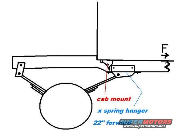

install a explorer hanger in front of the rear cab mount,it moves my wheelbase aprox 22".use a explorer rear shackle hang on the back and cut off the frame behind it.here is a drawing i did

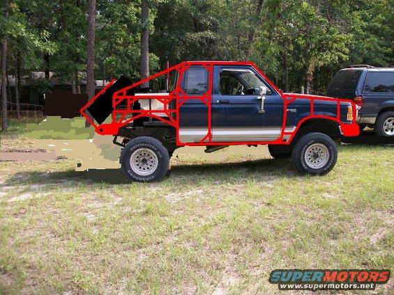

now with that i looked at the frame really good and then used paint on my comp and came up with this....

i like it...gives me a wb of around 103" dang near perfect.thanks for all advise to lead me to this...

I like it. Keep in mind you will have to do something with the gas tank if you move it up. I would push your front axle forward though and make the wheel base a little longer.

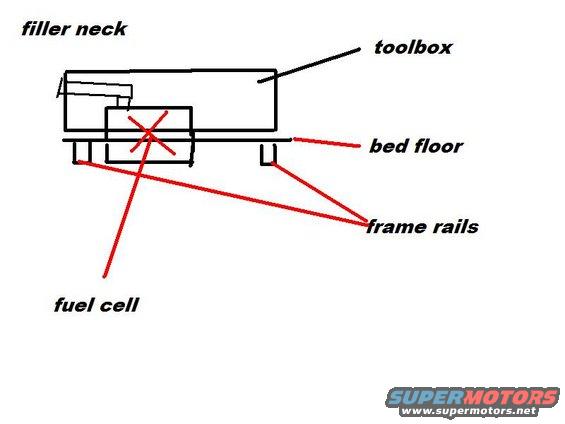

my fuel tank will be a 16 gal fuel cell in the tool box.kinda like this.i will cut a hole in the box floor to set the cell down in also cut the bed floor to sink the cell down to the bottom part of frame rails....pic is as if you are standing behind truck looking forward...
