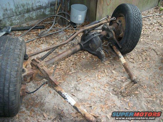

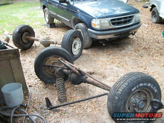

heres my new axles
the f/r 44 and 9"

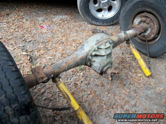

44 hi-pinion

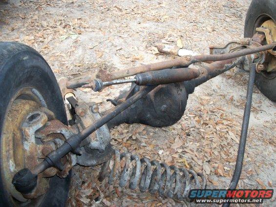

the 9
