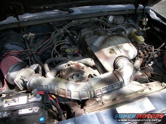

wow i am bored today... changed the t-stat to a 180 in the ranger....then found some paint...uh oh....now i have a camo engine......
