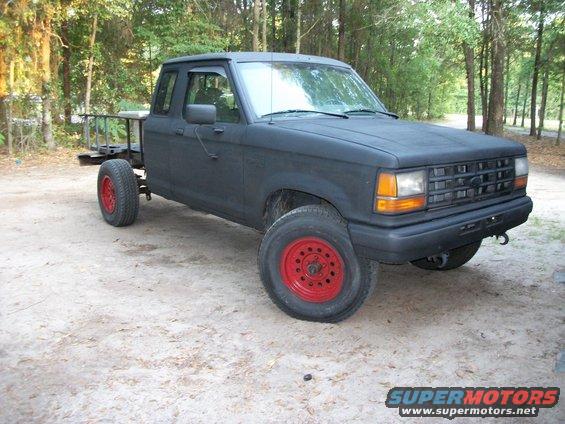

91 ranger s-cab 4x4

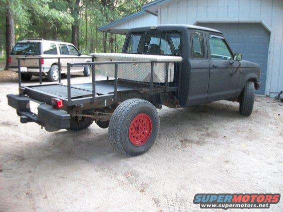

another option would be to use a explorer frame...91-94...this way i get the spring hangers on the botom of frame,have a 111.5" wb, and would just need alittle fab work to bolt a xcab 91 ranger onto it.,and get 31 spline axles it a 8.8 and a d35 front....good enough stuff to run until i get the full widths under it.and i can find explorers all day long for around $500 that need some work...this would be pefect.

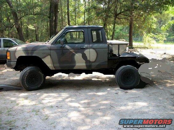

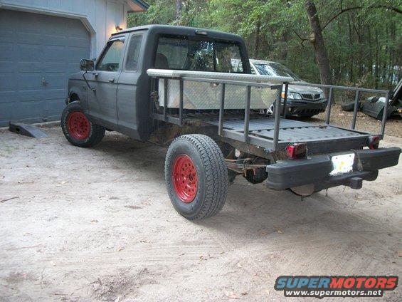

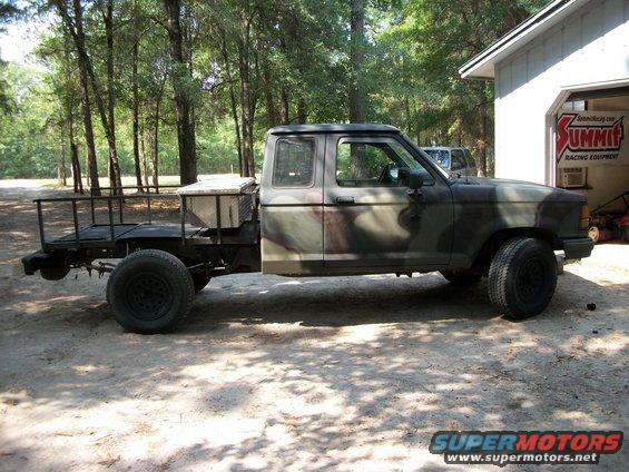

here is what it looks like now...that will change tomorrow...getting camo'd...i did not get a pic of frame yet but i will get it tomorrow also.

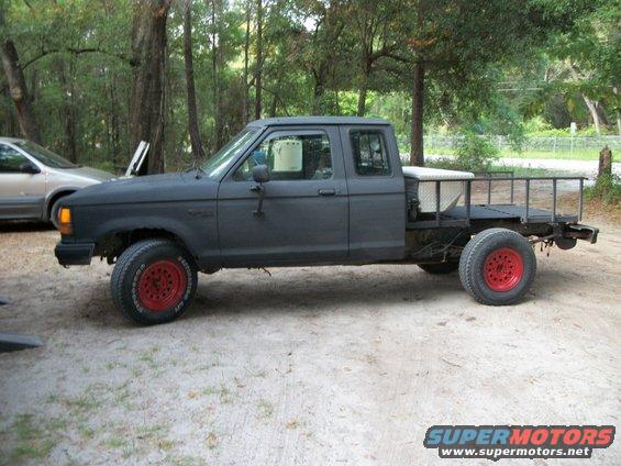

91 ranger s-cab 4x4

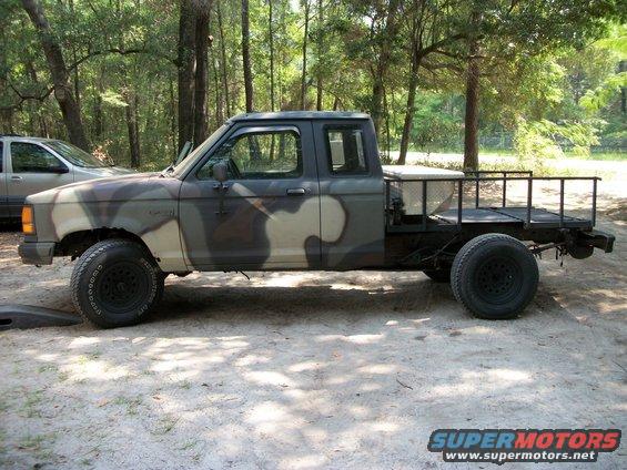

91 ranger s-cab 4x4

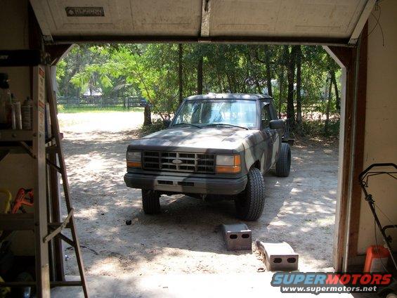

91 ranger s-cab 4x4

if it would work..i would like to swap out my frame for an explorer frame.if i am not mistaken the x and the rangers frame are pretty much the same.
well heres what it looks like now....i do not like it at all...its too dark.i need to repaint it the tan then add the green , brown and black and change the pattern up....its just ugly right now.

I dunno what pattern or shade you're looking for, but it looks great to me, I'd think if you made it lighter it'd lose the whole point of being camo. But i can't see it in person, maybe it's different
yeah the more i look at it...i just need to finish it now.the roof has not been done.i have had a few thumbs up driving it around so must not be that bad...lol
Yeah, they are pretty close (91-94 Ex). The front is the same, the back, after the trans crossmember, flares out wider (5" or so). The rear springs are mounted under the frame, not off the side, like the Ranger.
what 2.5" per side or 5" per side?i guess i could go outside and meassure my 93 x...lol
took it wheeling today...really impressive to be stock.i will post a video later.
