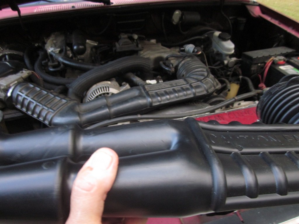

My 94 needs a new duct too. I've patched it up with ultrablack. I found an exact replacement on Ebay.

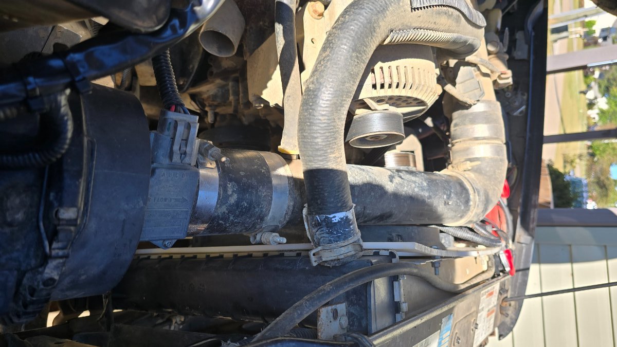

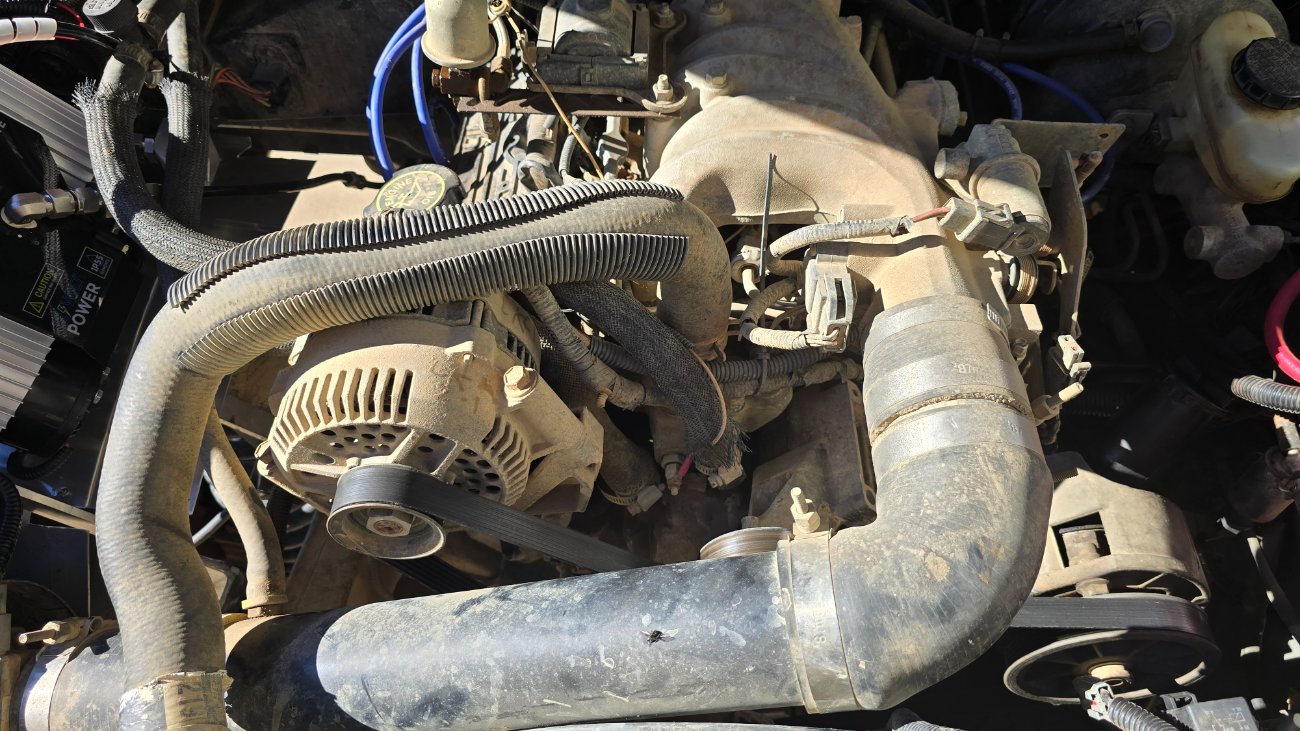

I ordered aluminum intake tubing and silicone elbows and couplings from ebay or Amazon or somewhere and built my own.

I used a reducing coupler at the throttle body. Everything else is 3" aluminum tubing wuth various elbows and couplers.

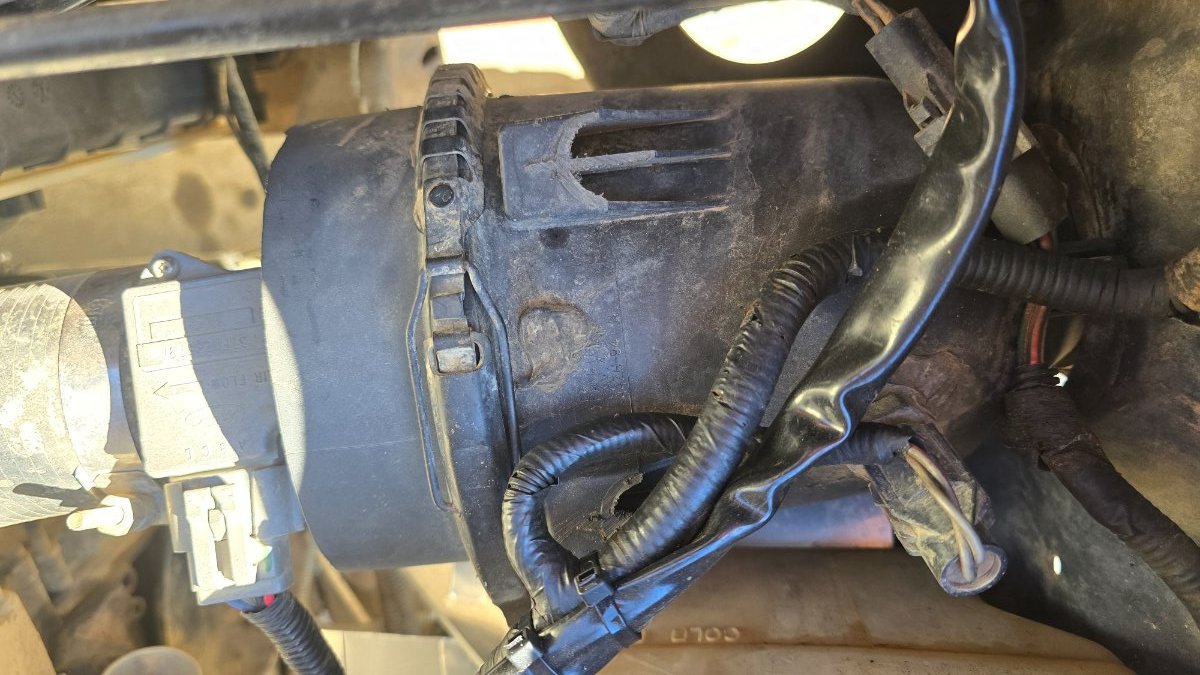

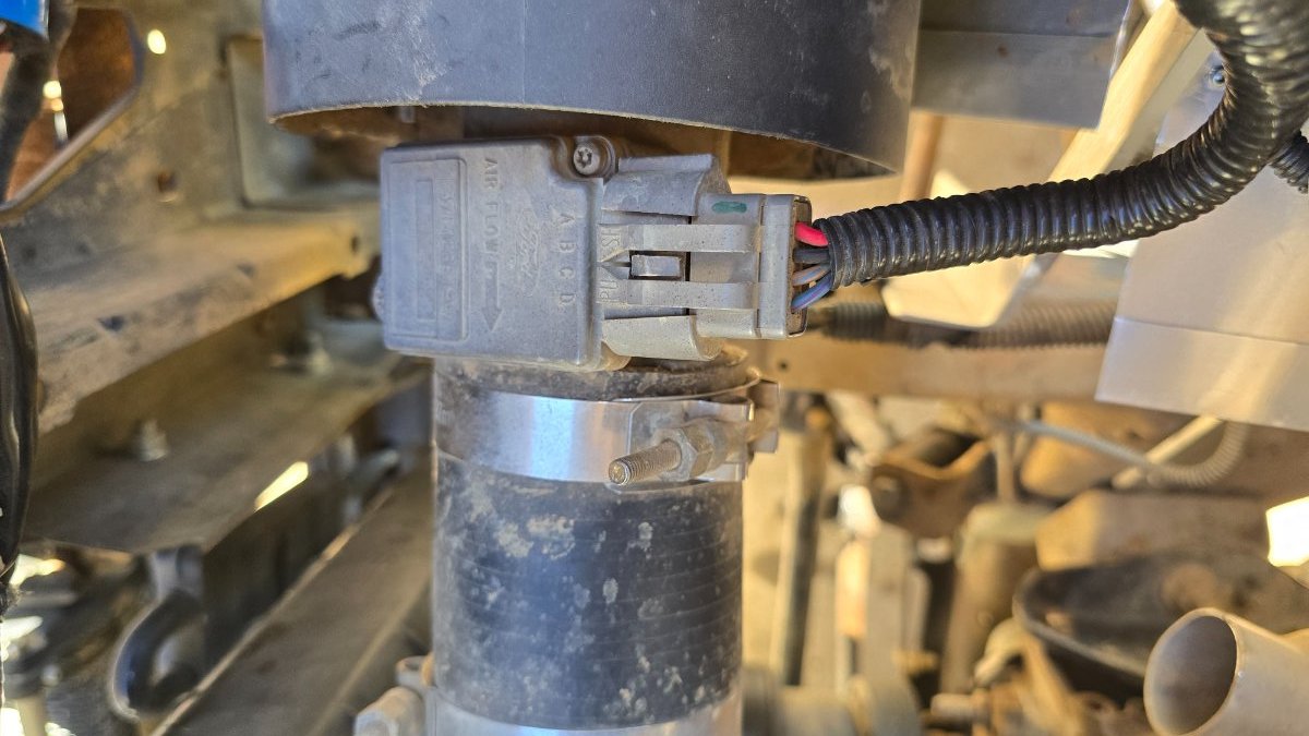

used the original MAF so it matches my engine and ecu

Since I did a snorkel setup, i upgraded to the riund style air filter housing. I think it's from a newer 4.0l. (Junk yard parts) It took some fiddl8ng to get my original MAF mated ro the newer air filter housing.

I’m sure I reduced the resistance to flow. The original piping was very restrictive, including the piece between the core support and original airbox.
Did it increase horsepower? I have no clue. Maybe by 1/2 hp. Not significant.
