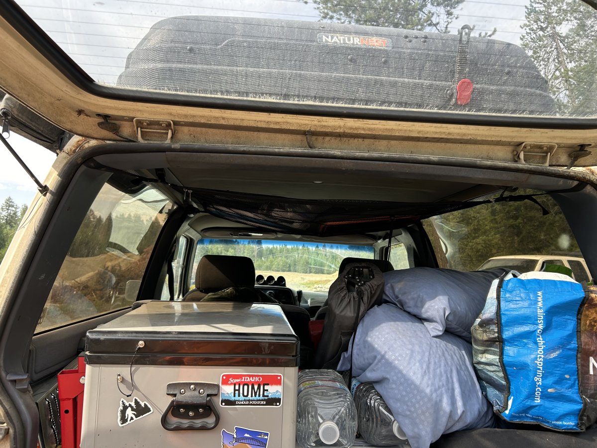

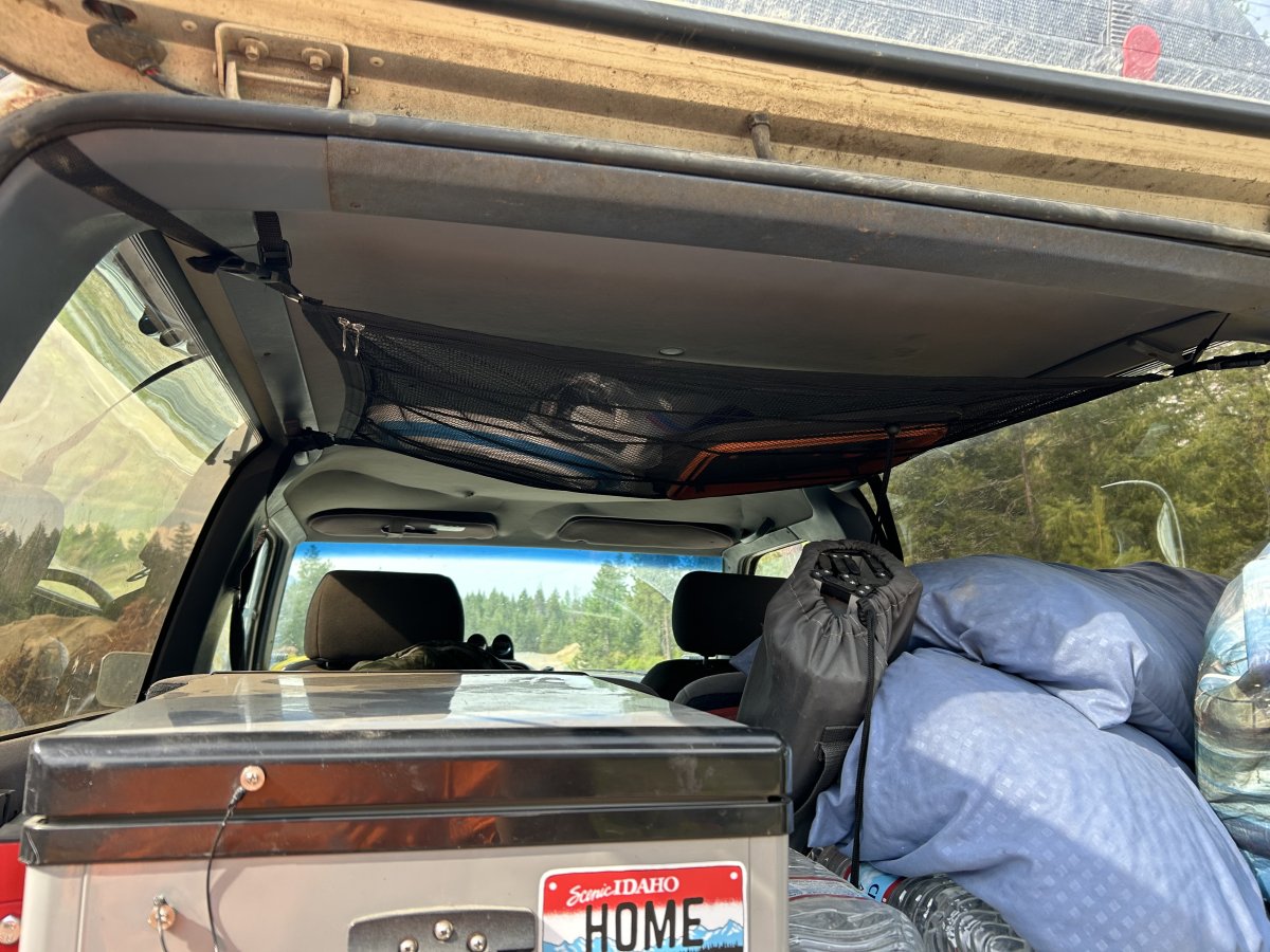

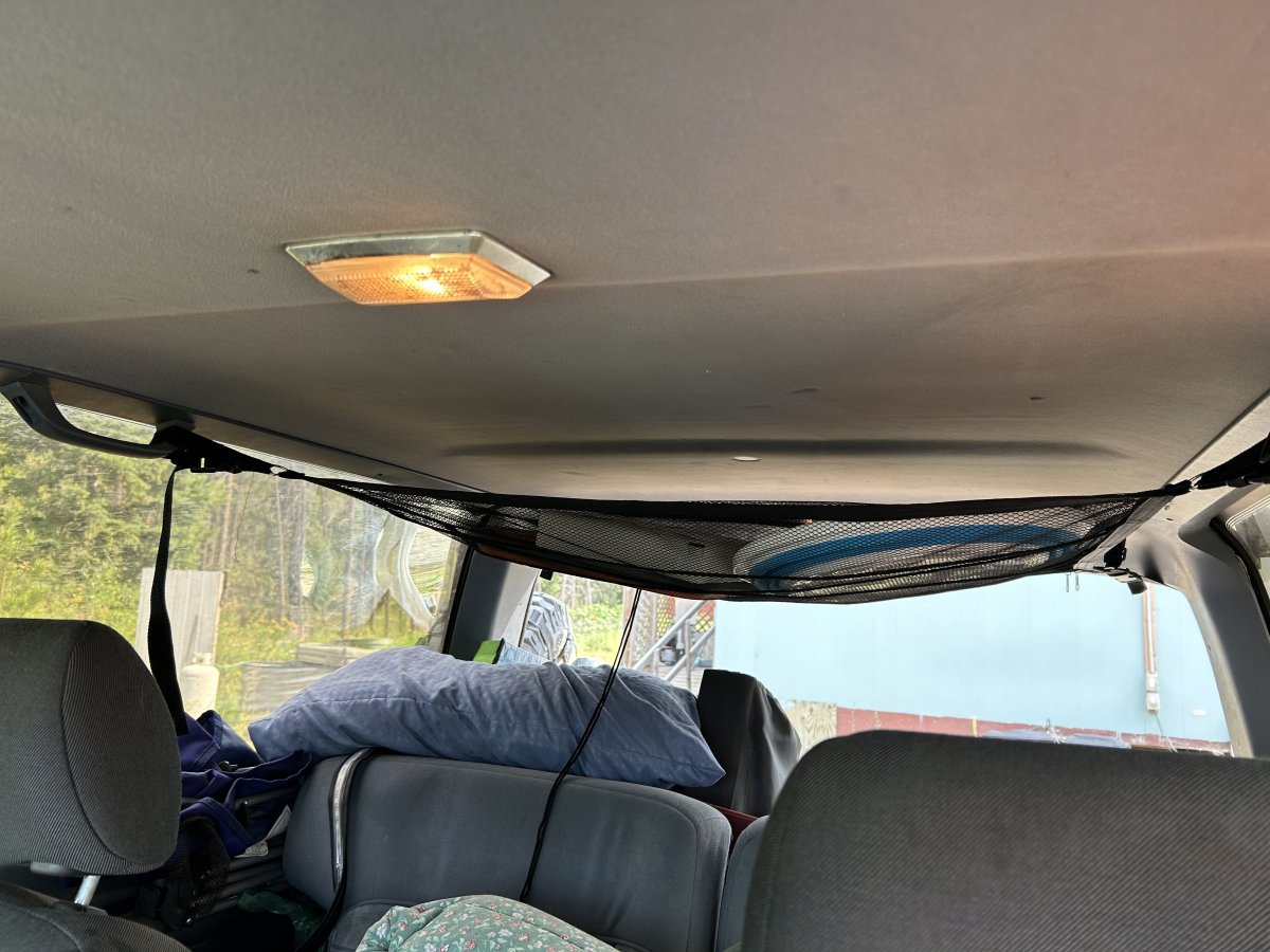

I saw this on one of the overlander Jeep guys on YouTube. It was like 13 bucks on amazon. I got one with a zipper bag, idk already looks helpful. My collapsible bowls, went right up there, tire repair kit. Should be able to stuff some pillows up there, and some other stuff. Pretty handy really! Took like 3 minutes to install.

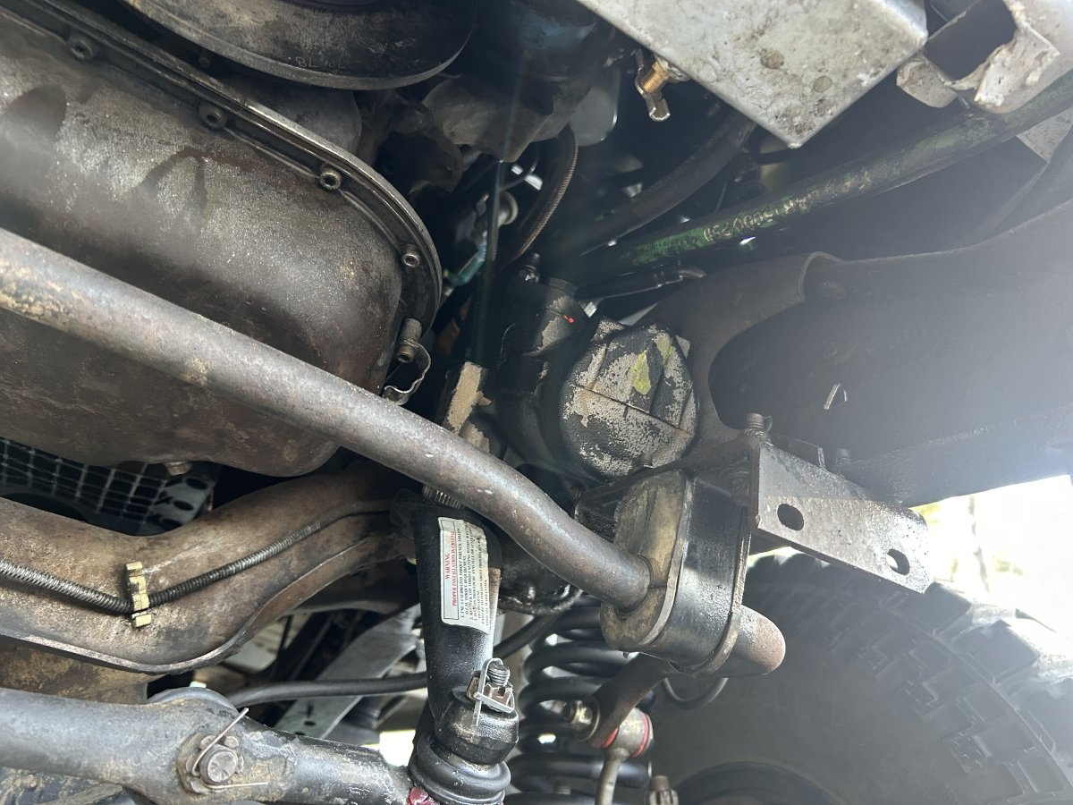

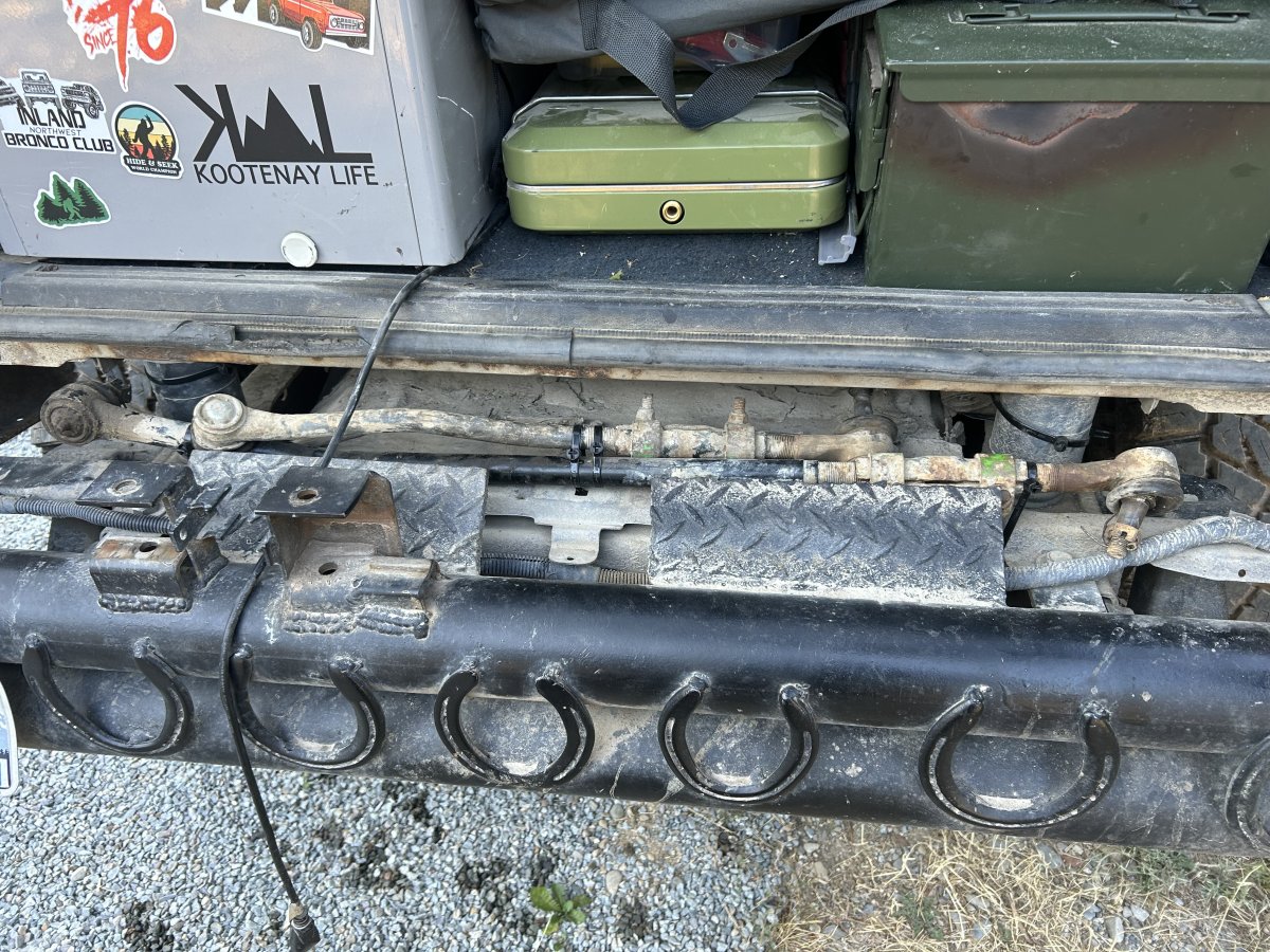

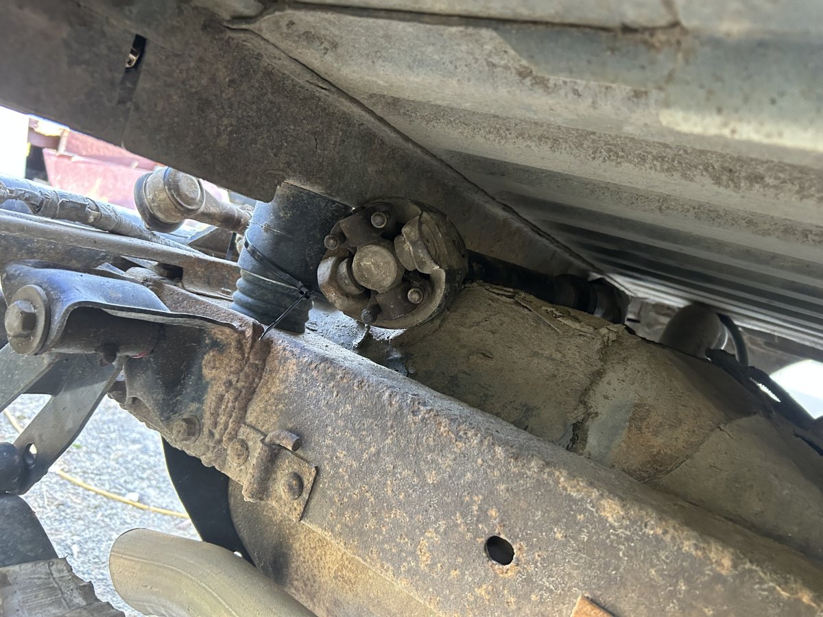

Well just a few days until my trip into Canada. Going to whipsaw trail system. Mostly new broncos, one ranger and me. Managed to store, my driveline and my tie rod over the fuel tank body lift to come in handy! Haha hand to install a new steering box, old one started leaking pretty good. Test drive into town with the boys. Man it drives so much nicer with a new steering box.

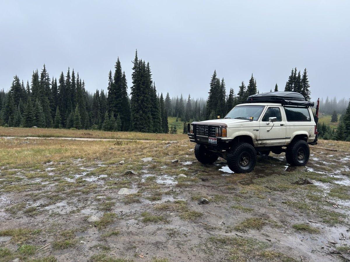

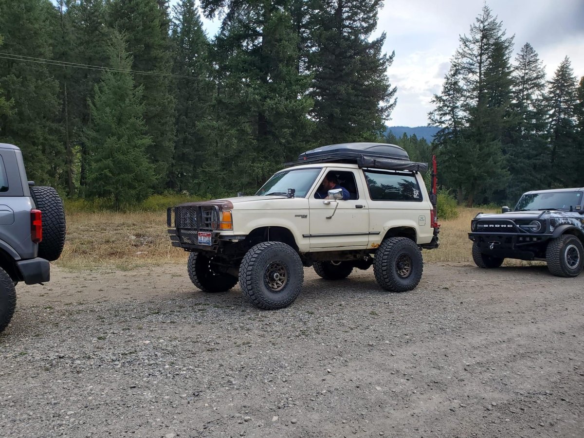

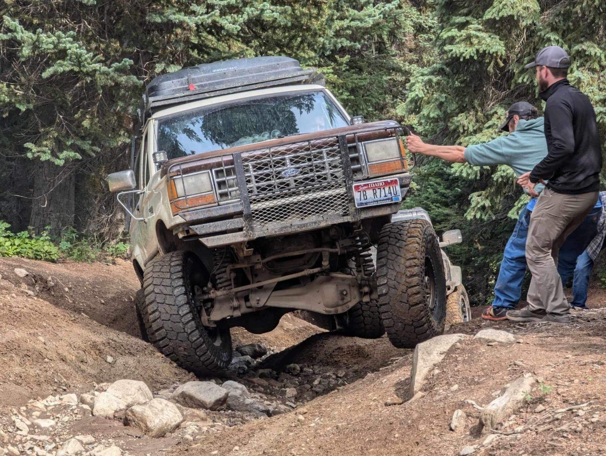

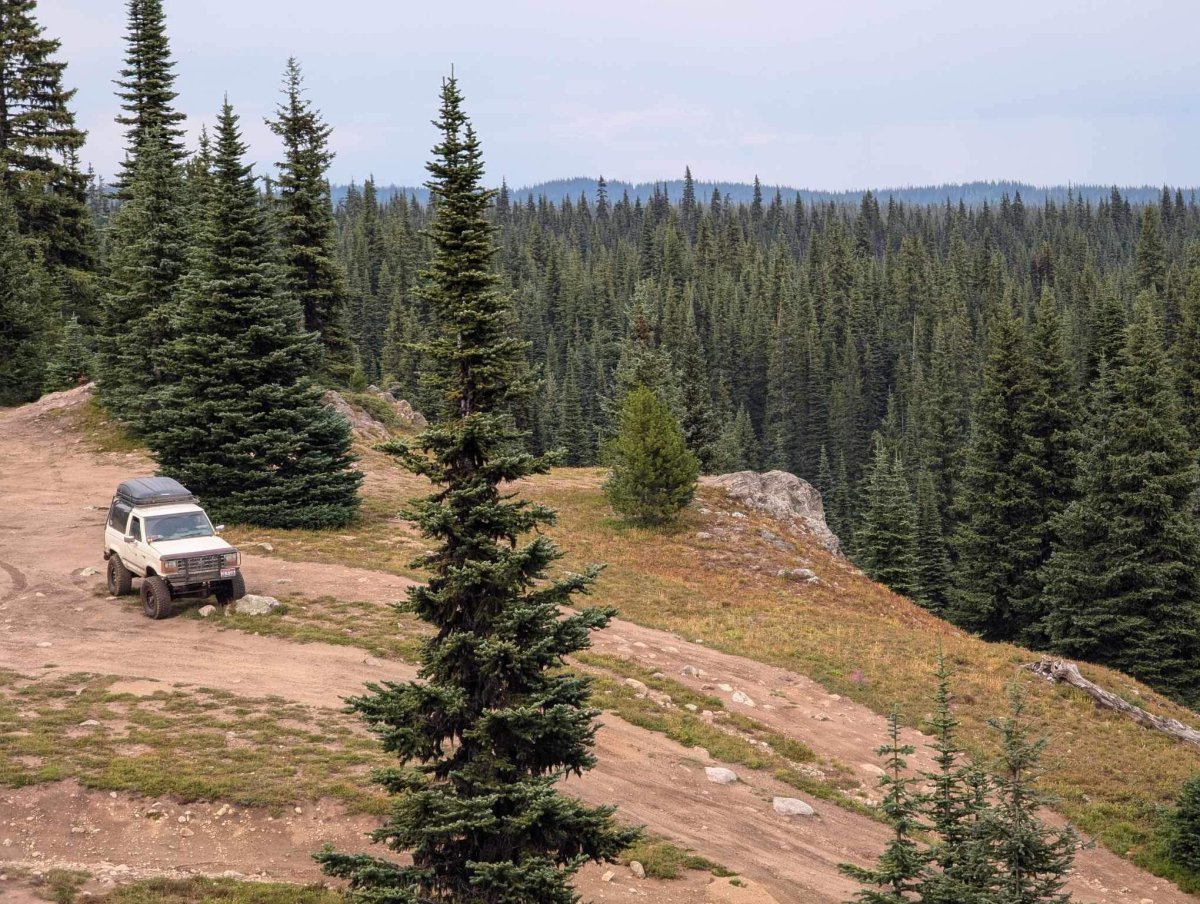

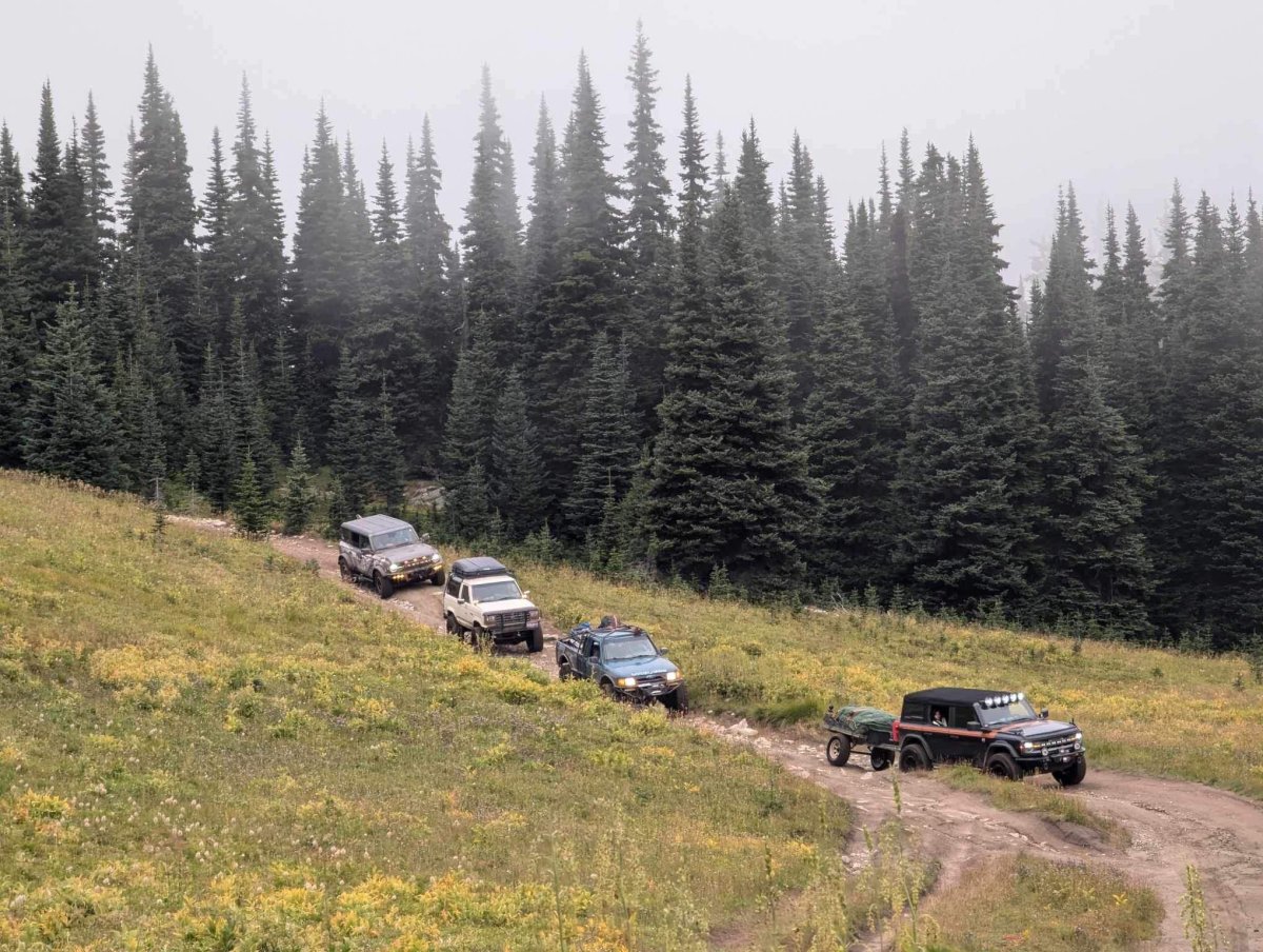

Well the old B2 has conquered whipsaw trail in BC Canada. Spent two nights on the trail. Had a bad thunderstorm warning on the 3 rd day so the group decided not to do a 3rd night on the trail. Boys were tired so we came home. Didn’t break anything. Almost did everything I pointed it. I have to change the coils in the front. They are way too stiff and do nothing but unload. I just picked up some early bronco 3.5 lift coils I’m going to try out. It was an awesome trip.

i had concerns with your ride height and overlanding requirements.
i ran soft xj coils at that height but incorporated air springs for road duty. just a few psi totally changes its manners with the ttb. off road getting full travel the soft springs made a big difference....you actually need limiters
for what you do i would be tempted to run full width superdoodies in it at that height. because they are so cheap . the stability with fullwidth axles is definitely nice.
but some airlift bags(cheap and easy).... and when money allows buy a really good sway bar really help for the road.

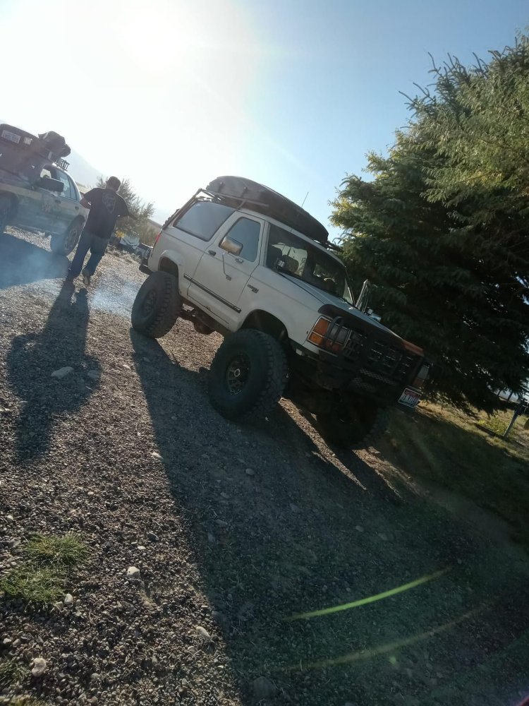

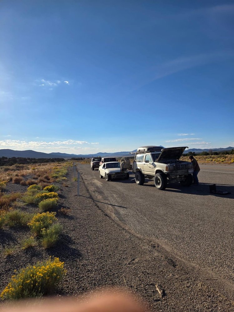

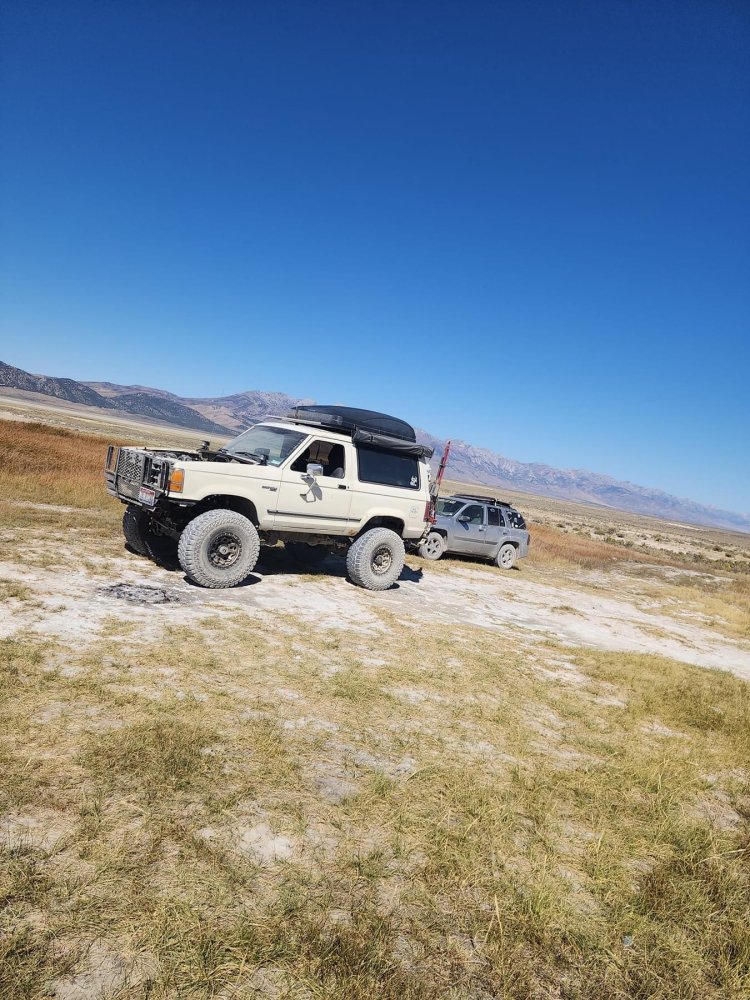

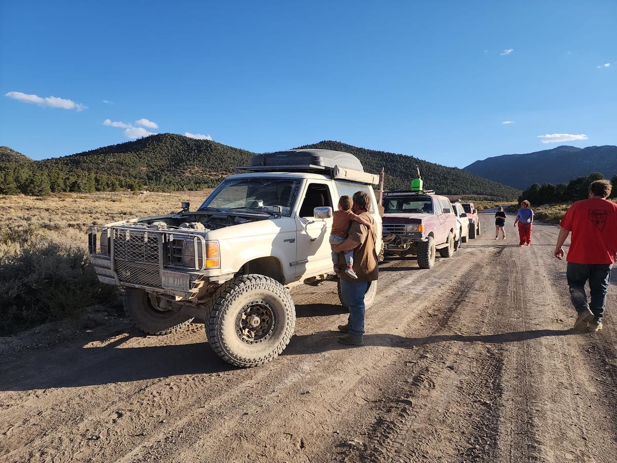

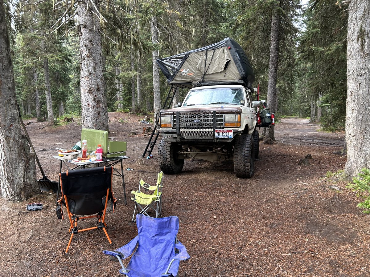

Well took the boys on another adventure. Hauled it this time, northern Nevada. Went from elko to ely on back roads, part of the pony express trail. Spent 2 nights on the trail. Never had to put the b2 in 4 wheel drive haha but definitely would have needed it if I didn’t have a rear locker. The b2 gave me some trouble. I couldn’t keep it cool. Idk what do do at this point. I like some parts of the OM617 but I’m down to I have to make a core support to fit a bigger radiator. But idk it might be an engine problem to. Idk part of me just wants to TDI swap it and be done…. But I’m not sure. I really just need to compression check it but I really just don’t want to know lol early bronco coils work good.

hell yeah. looks like a great time.
you may be overfueling a cylinder....usually raw diesel smell and prodigious smoke though. seems a head gasket would be obviously causing other issues. timing is critical and elevation as well.
regardless.....under load they simply make allot of heat. even the tdi.
i run heavy in my lightest configuration for 150 hp at 6000 plus pounds.
weigh it in trail configuration.
this is why i suggested to gut the core and maximize radiator capacity.
i only have issues towing unless over 5k feet. it runs warmer over 6k ft. its the main reason i want an inline pump....easy to adjust compared to the rotary.
