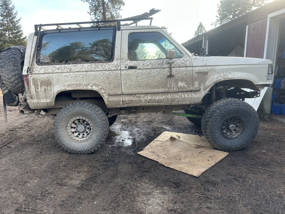

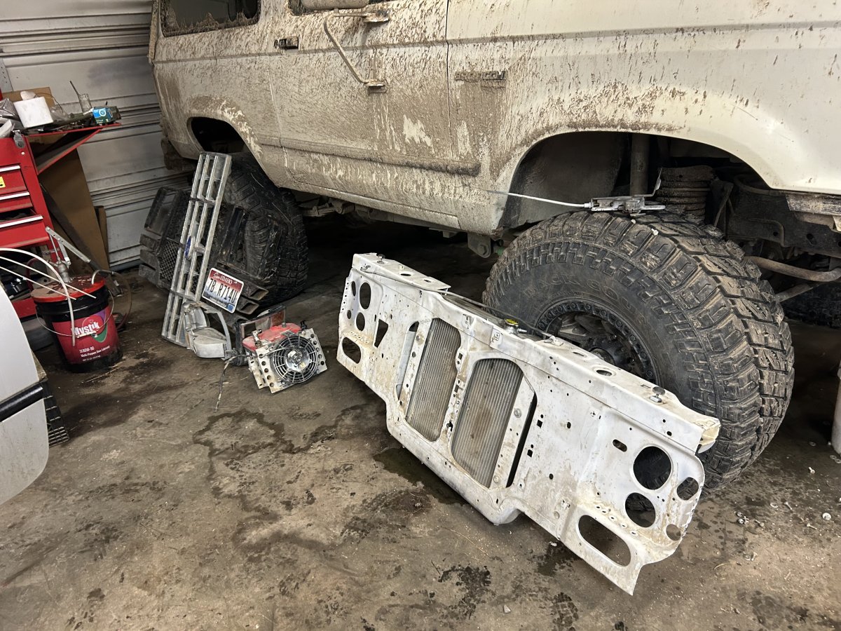

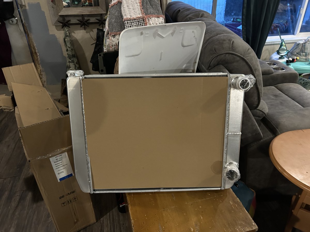

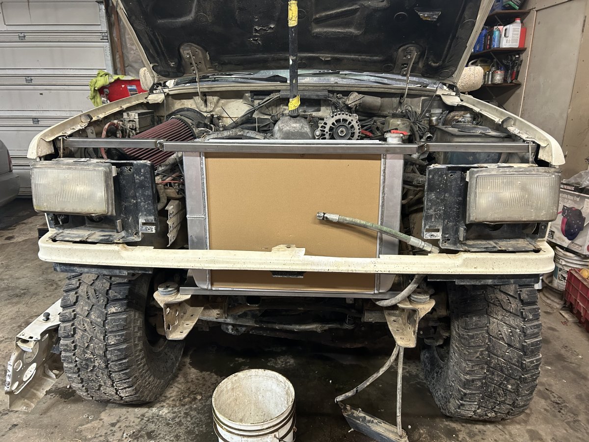

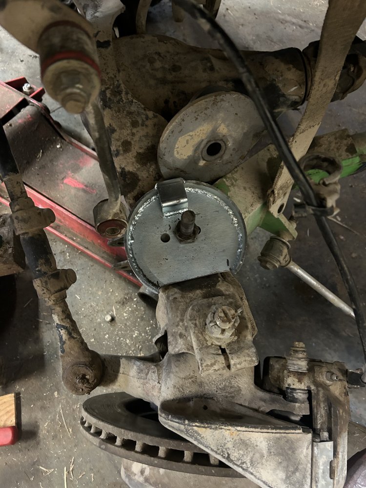

Haven’t been on in a while. It getting onto winter. I swapped the front coils to brand new wild horse 3.5 lift progressive coils. I got it together enough to go in a toy drive run. I’m going to an inside coil bump stop. I modified my stock coil buckets. Then I ordered a bigger radiator. Build a core support right now. It’s 26 by 19 and a true cross flow. If it overheats I’m done with the diesel…. Lol
I’m also hauling it to sand hallow end of February for united by bronco. Should be fun! Pretty excited. Never done anything like it before. Probably be the only b2 there.

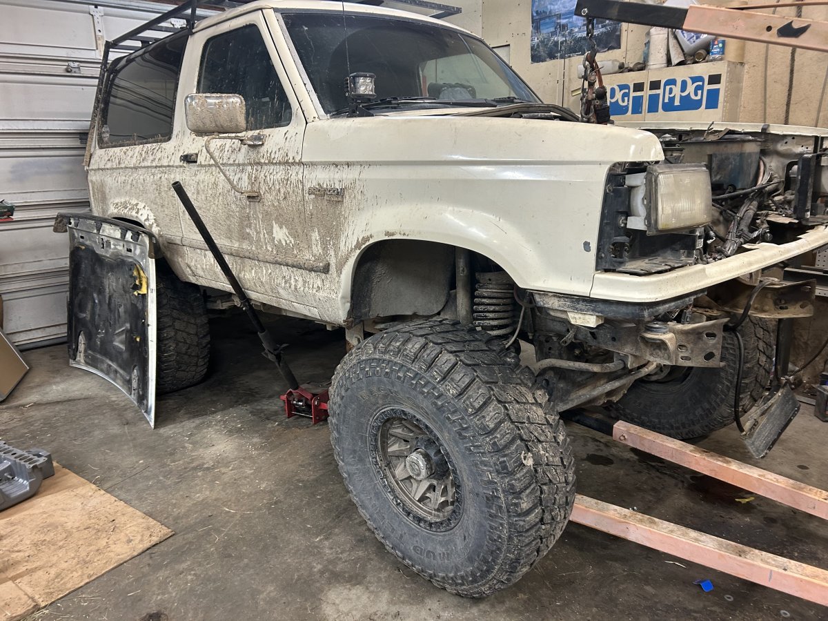

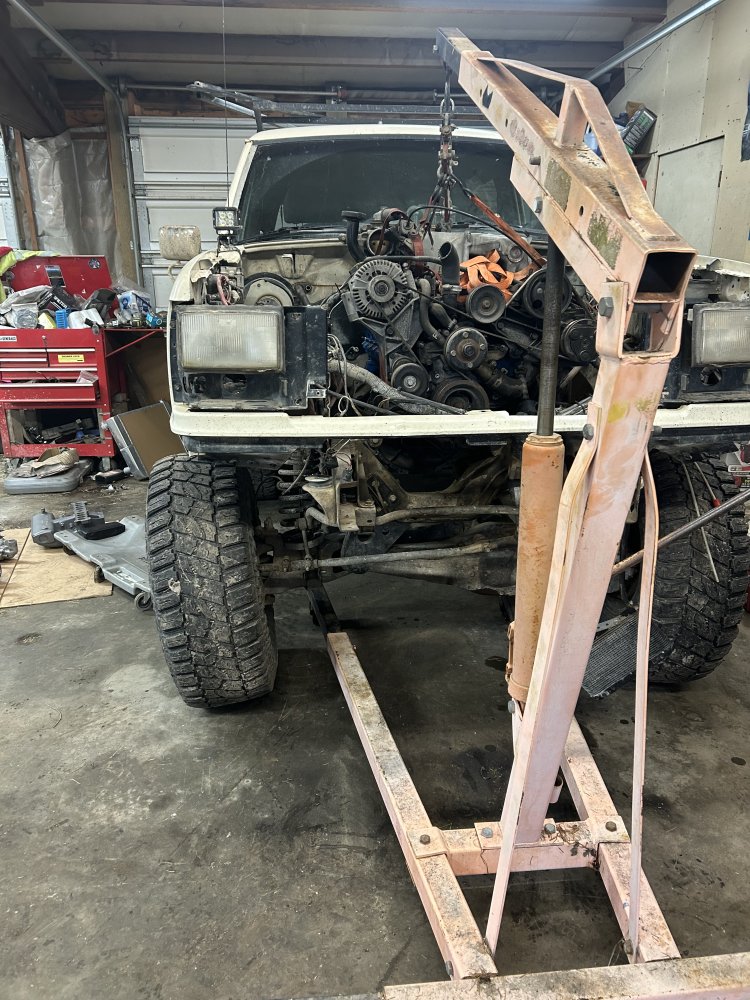

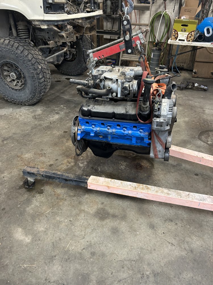

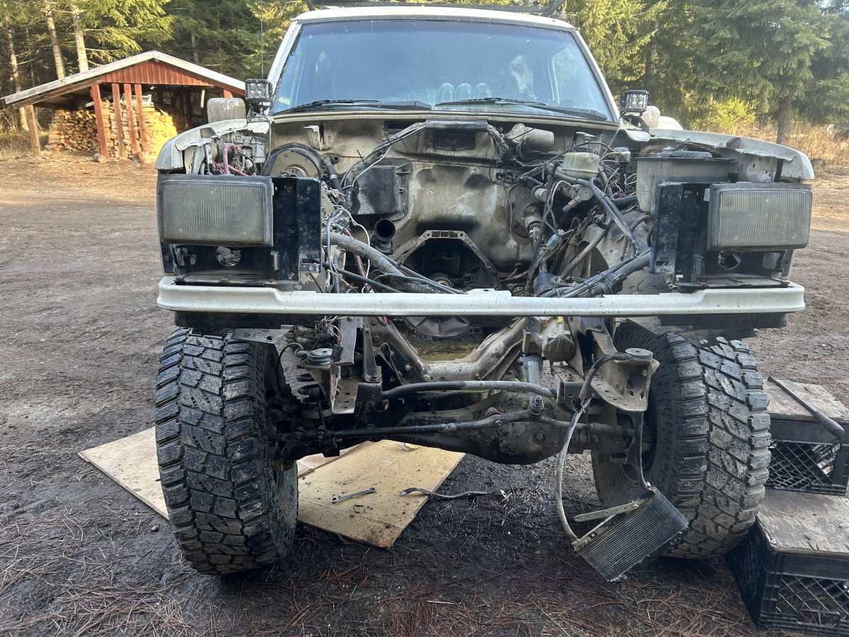

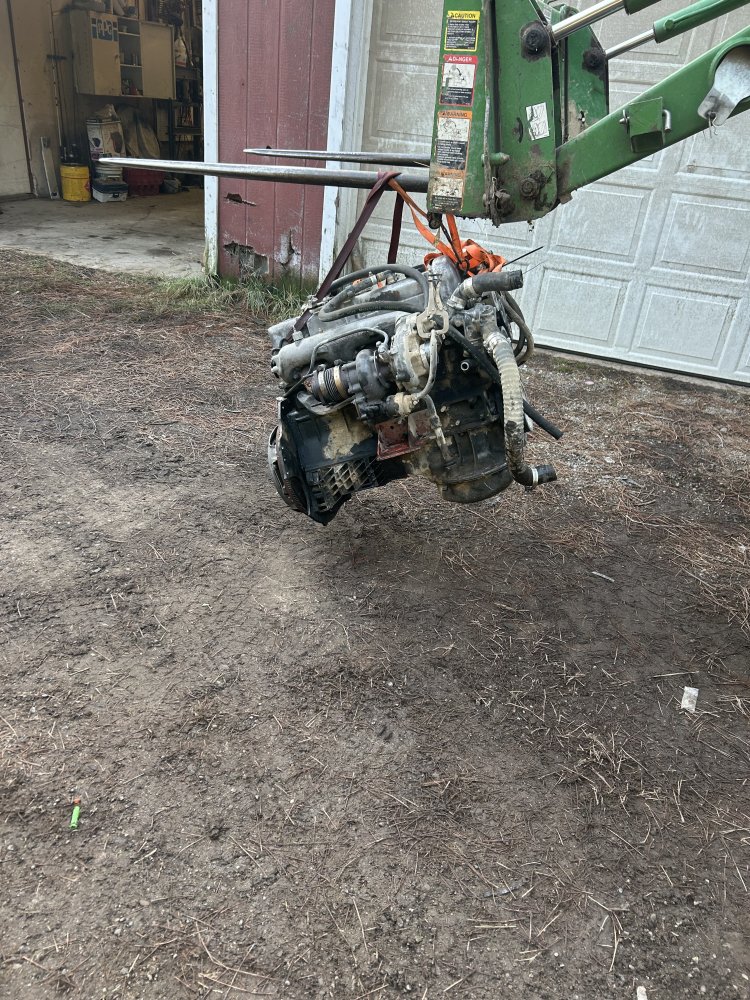

Well…. I did a thing…. Rather than building a custom core support and spending all that time just to at the end of the day have an underpowered gutless diesel…. I decided it wasn’t worth it. The transmission is already a SBF transmission. Pulled the 97 explorer 5.0 out of the shed. Yanked the diesel out on Sunday. Had it sold buy Monday…. Ordered oil pan, oil filter adapter. All the stuff.
I wanted to see the diesel through. I drove it all over the place. It was fun, but I want to travel with this b2 and to have a top speed of 60 really sucked…. I really do think I could have made the diesel work, but not that one. A TDI is hands down the way to go. If you want a diesel don’t do an OM617…..
well on to bigger and better things! 200 plus 5.0 here I come!

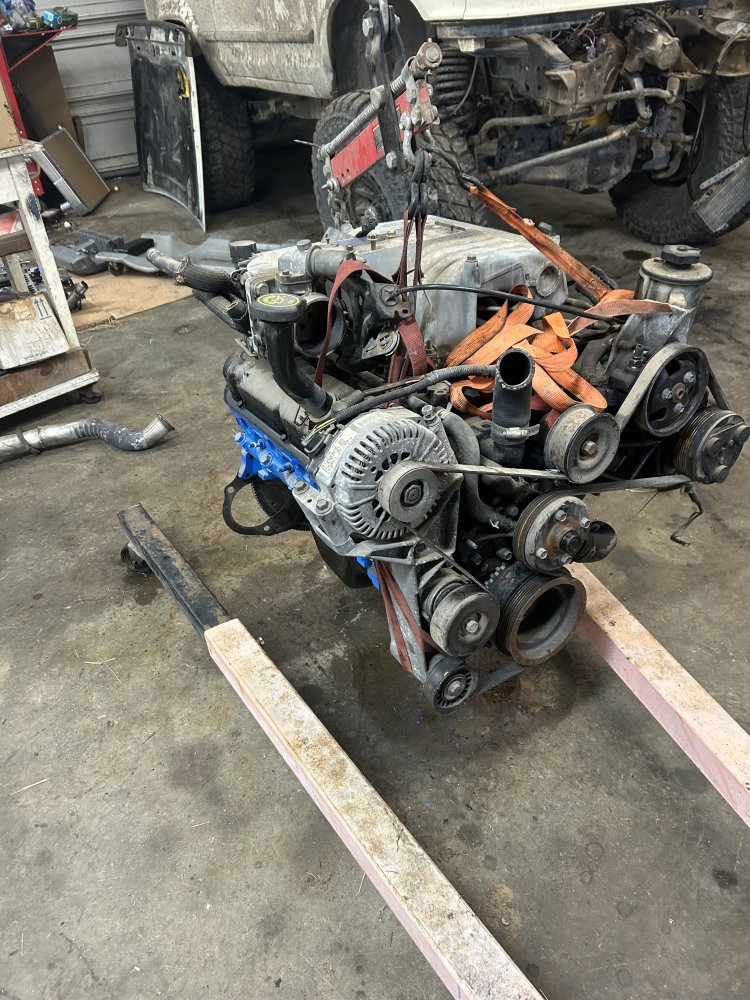

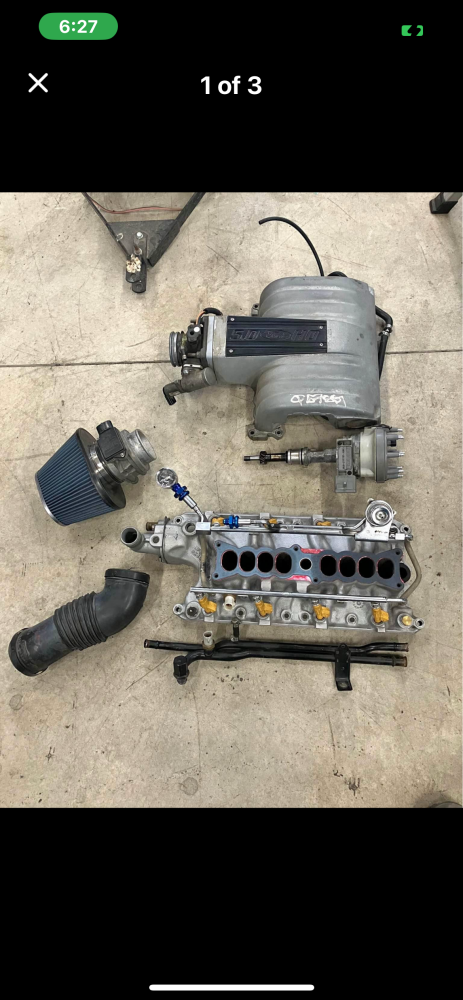

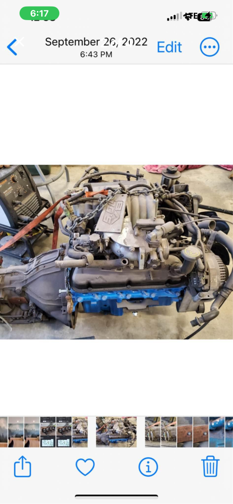

I still have to dig the motor out of the storage shed, but it’s a 97 explorer 5.0. Gt40 heads. I’m going this weekend to get a used Ron Francis stand alone harness setup for an early bronco comes with tuned A9L pcm, early 90s mustang upper/lower intake. Only missing a few things.

I had to read that a couple of times. At first I thought you were swapping the Explorer upper/lower intakes with the Mustang ones and was wondering why; but I just realized that they are part of a package deal for the harness and ECU. That will be a nice setup in the end. I have had this basic setup on my '73 for years and it's just so reliable. I love it.

Yeah I may of not wrote that the best haha I think it should be nice. It’s what a lot of people do so it’s got to be somewhat tried and true. Idk we’ll see haha

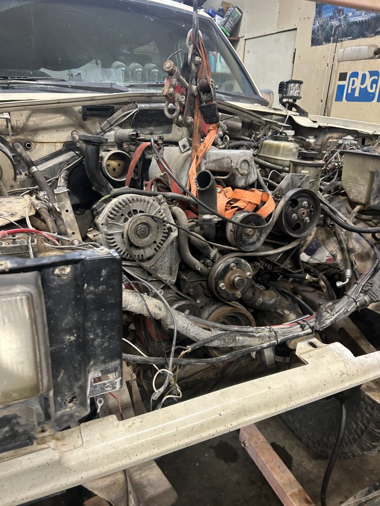

Haven’t been making much progress. I got the 5.0 in. Got it lined up and bolted in. I had a heck of a time, getting it in straight. Idk first time I’ve ever installed an engine, with the transmission installed already. Seemed to work ok. Seems not to hit anything! So I’m happy! Wish I could be more productive, but with the holidays and working 60 hours and 3 kids just don’t give me much time. Idk next weekend I’m going into the shop and the wife will just have to deal with it…. I’m running out of time. But everything else should be pretty straightforward. I got all the mustang stuff. Drop the fuel tank, put in the new fuel pump, I have to run new fuel line, I don’t really trust the rubber line and I’ve had diesel ran through them. I have some gen 1 explorer fuel lines I hope I can use most of it.
I’m really hoping the front end comes down some. I don’t understand, the 5.0 and the OM617 are very close to the same weight. Maybe it will settle when it moves back and forth some. Hope so I really don’t want to deal with messing with front ride height again. Lol

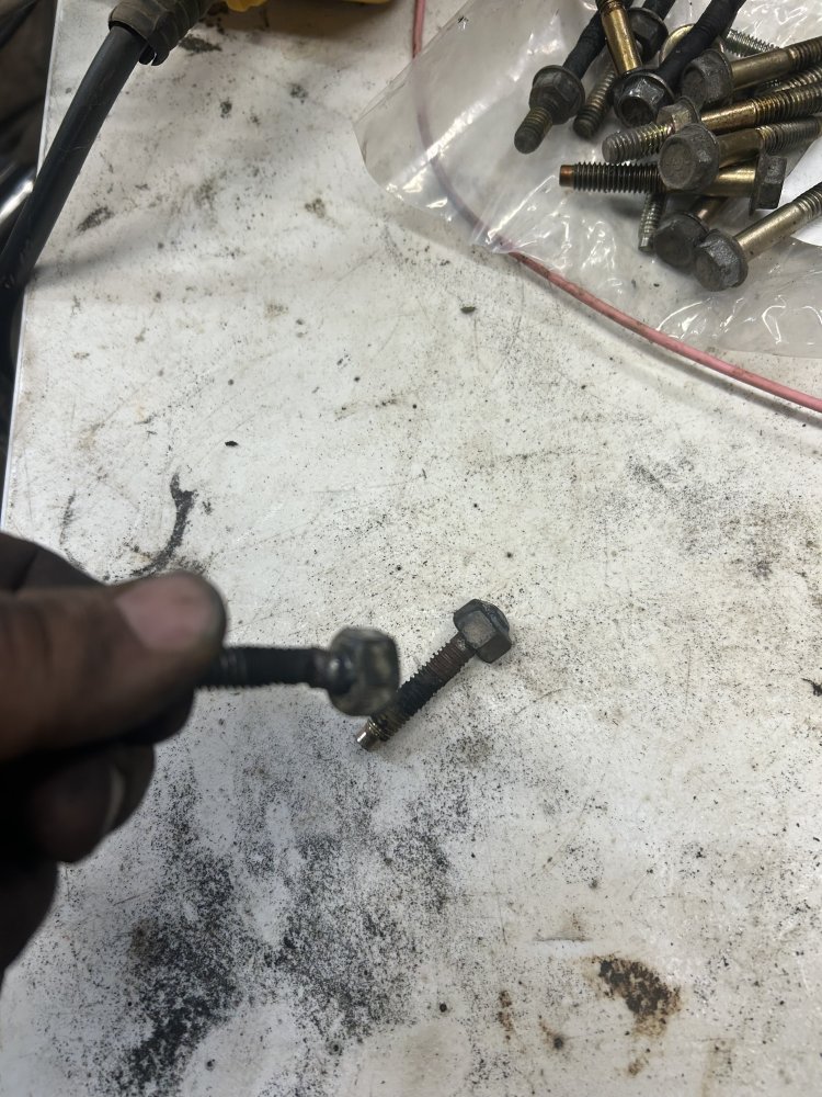

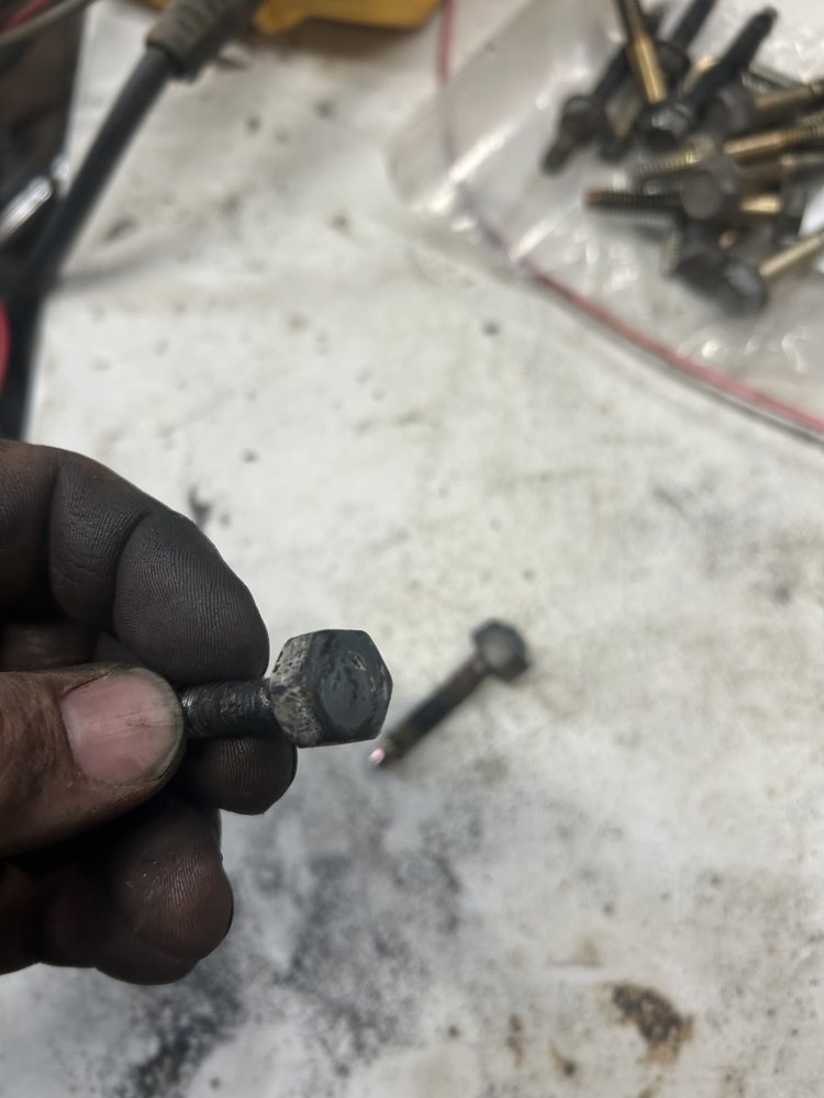

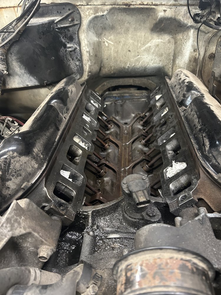

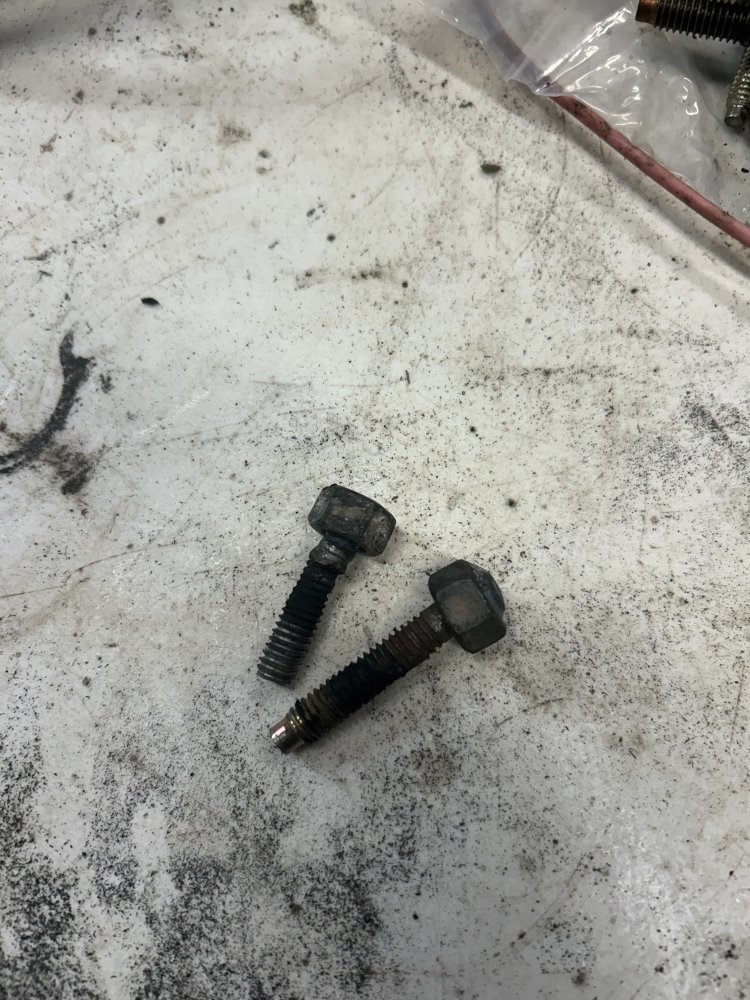

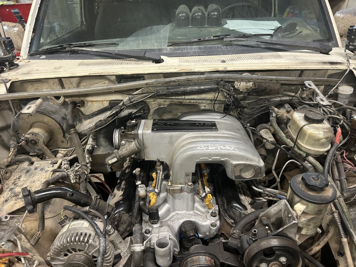

Got some more done, had two broken lower intake bolts. Welder made quick work of them. I have to mod the heater hose lines a little but I have an idea for that. Lower is on, I just have the upper sitting there. Also tighten up a few other loose ends.
Looking better anyways!
